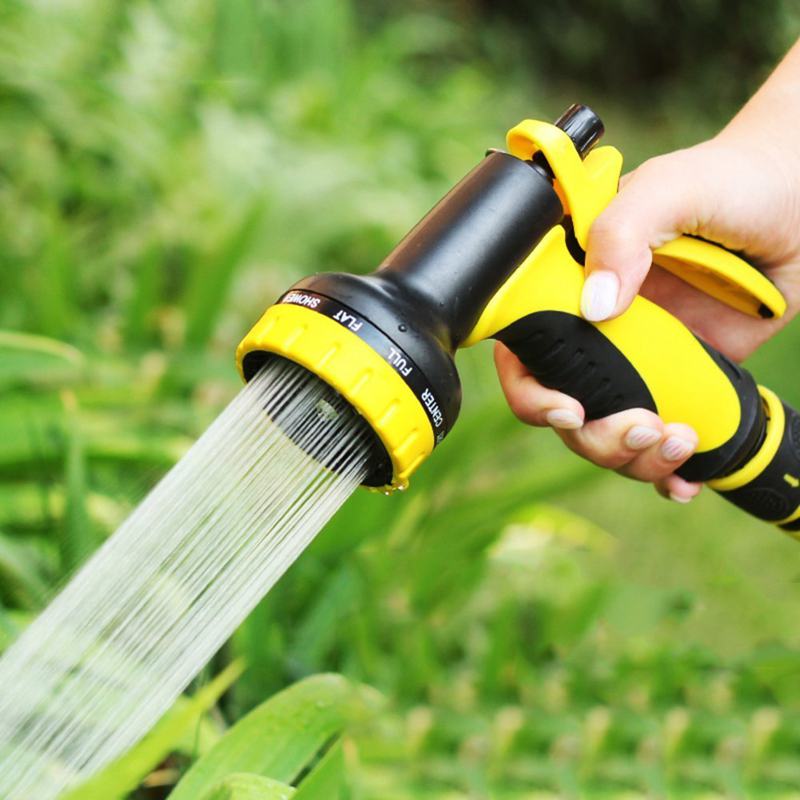

But to keep the party from getting “too hot”, we always like to keep a waterhose w/ a nozzle on stand-by whenever we fire-up the oven…
Now, that sounds like a good idea! Utility and safety in one.
And yes, keeping the water hose charged up is always a good idea. The two cases I mentioned above (people and property) are likely to be class “A” events.
