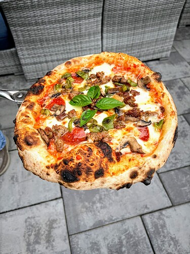

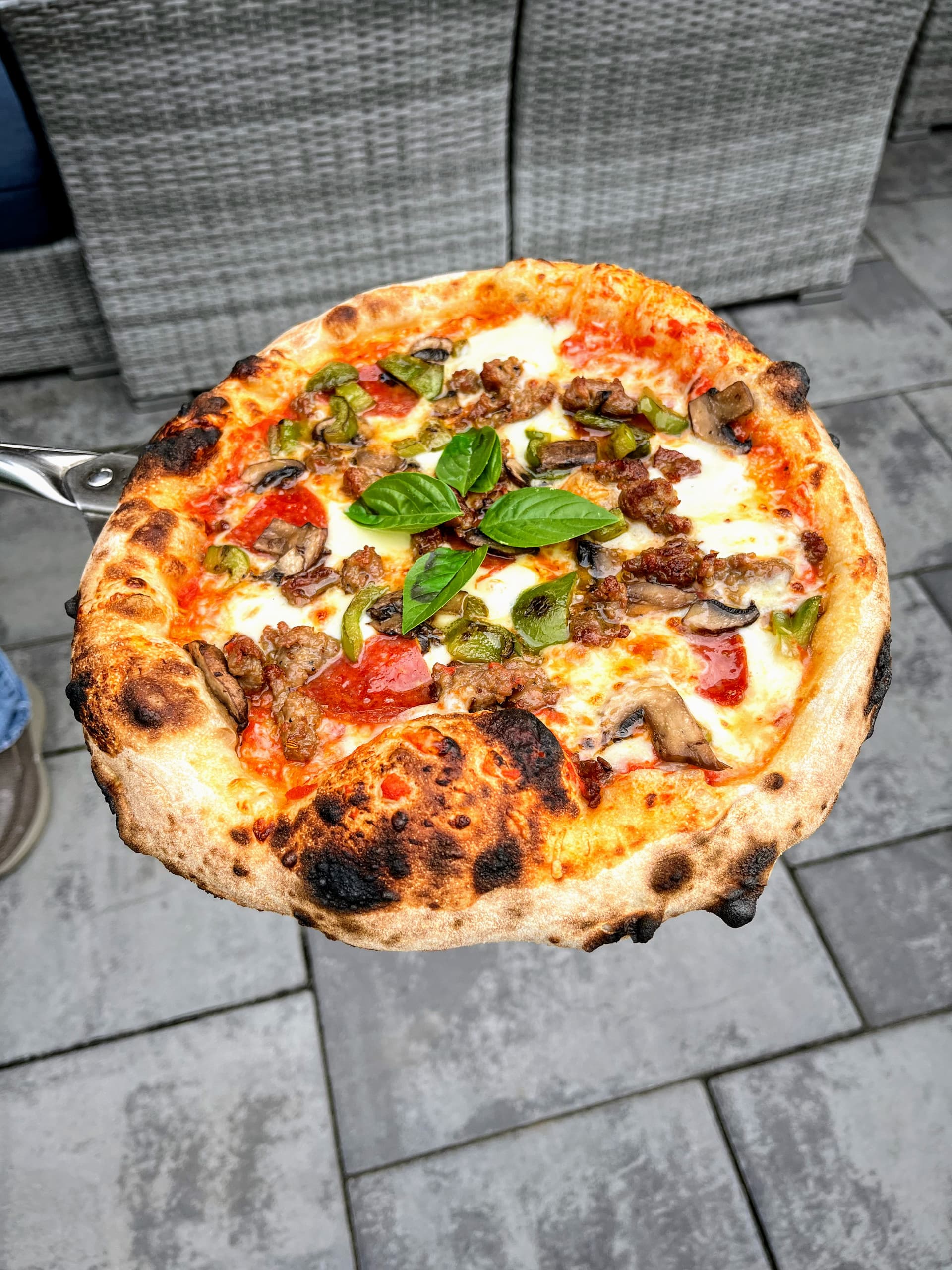

One of the challenges I’ve had with my oven is the fact that the pizza only faces the fire at the back of the oven. I get a nice spring / puff in the crust on the side facing the fire, but by the time I am able to turn the pizza the side that was facing away from the fire is set and doesn’t spring much. This results in an uneven cornicione. I did a couple things that definitely helped:
  • while preheating the oven I put the door over the front, leaving it partially opened. This seems to have retained a lot of heat, when the oven reached baking temperature the firebrick towards the front were white which is normally not the case for me.
  • while baking I had the normal rolling fire at the back, but also had a bank of coals and a log or two on the left side.
My pizzas cooked faster, but more importantly I was able to get a more consistent spring, even after the 6th and final pizza. Still not perfect, but small increments keep me happy.
