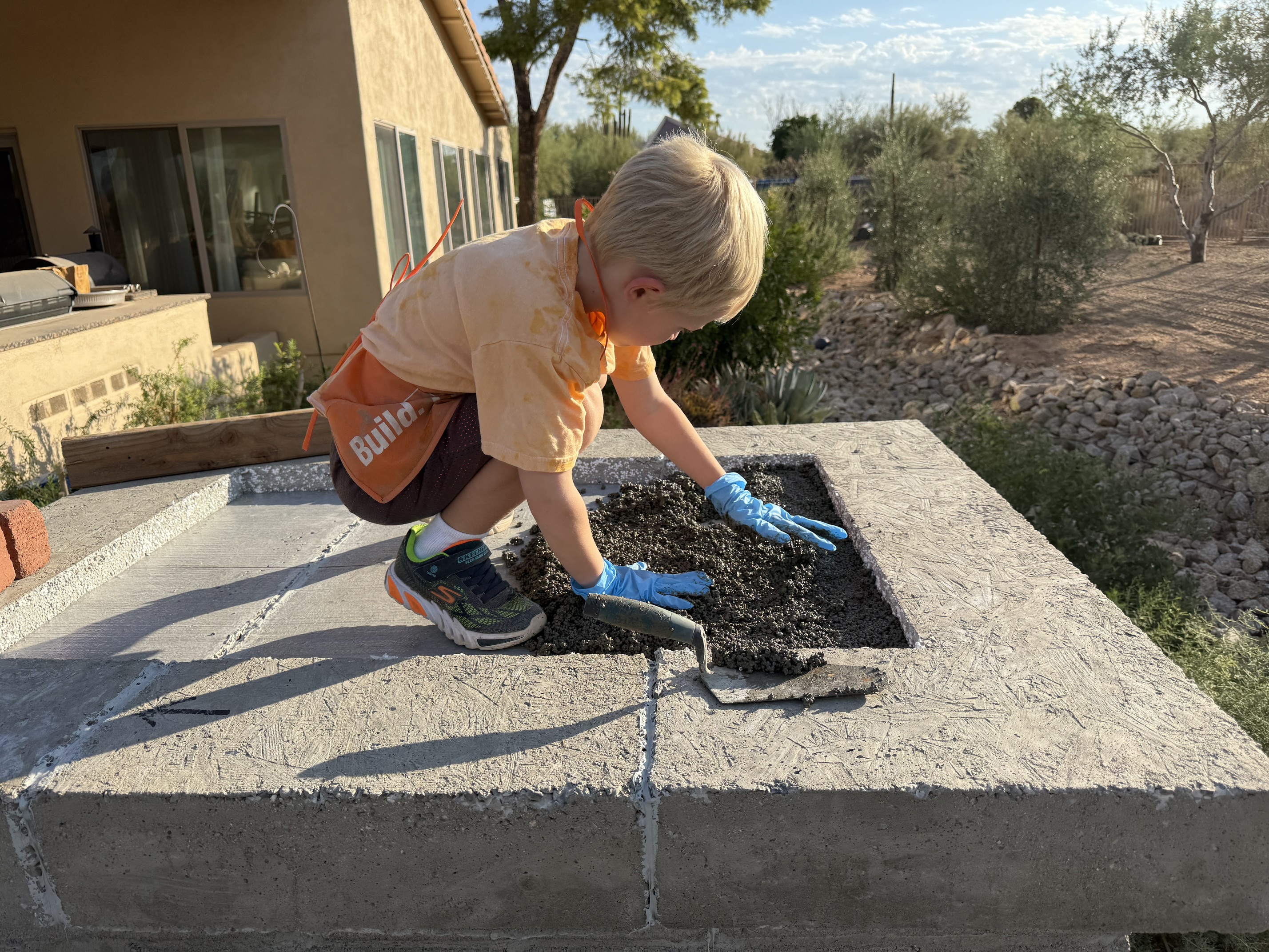

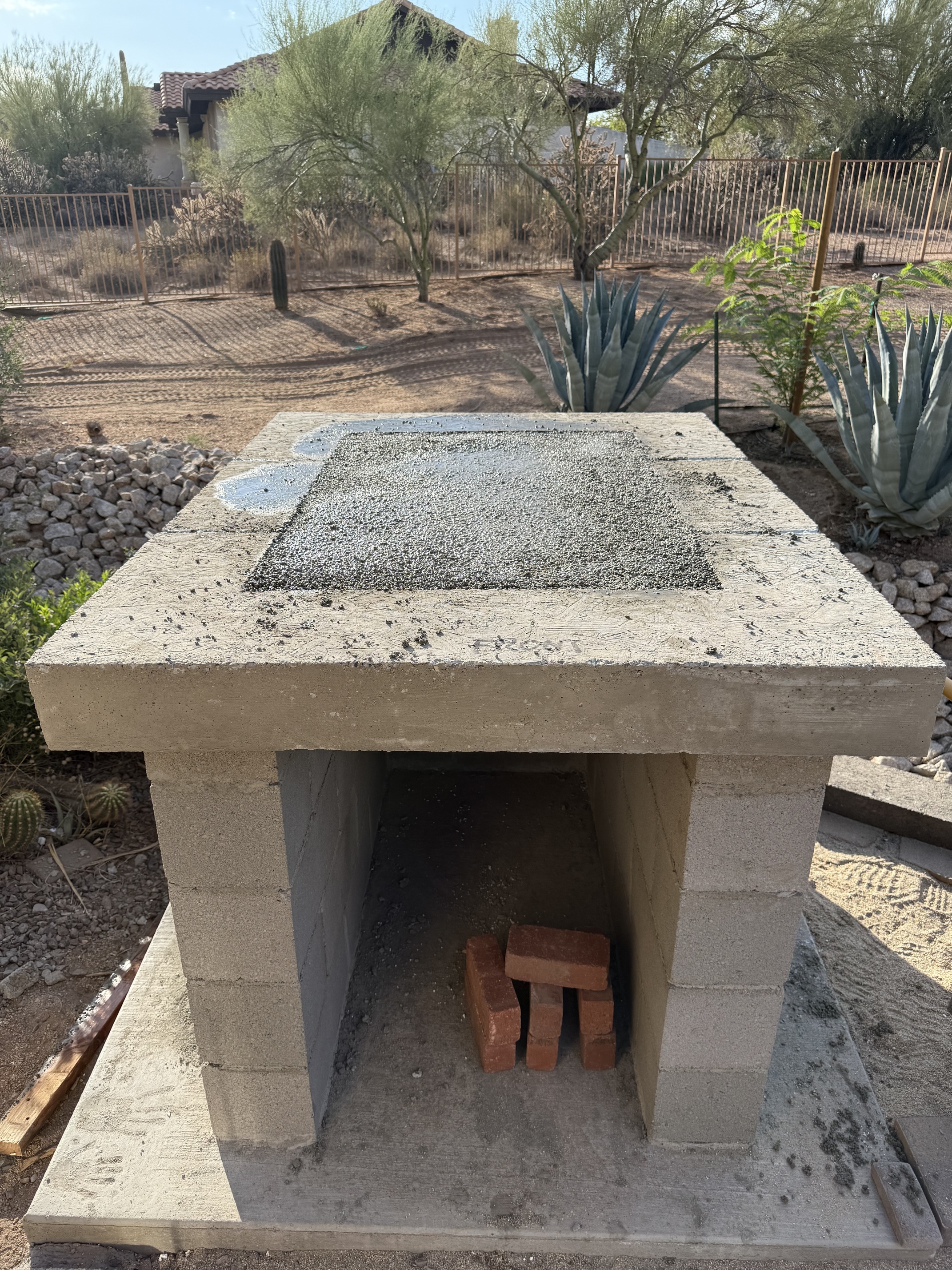

You need Portland cement for the insulated base (filling the void with a mix of Portland cement and Perlite). You do not use Silica Sand for the leveling layer that goes over that insulated slab area. That requires Play Sand, which is an all-purpose sand that is clean and screened, and is coarser than the Silica Sand. (A fine sand like Silica would be a nightmare for leveling because it is so fine that it just compacts in place.)
Sounds like you’ll be good to go…and good luck!
Perfect! Thanks for the help! I do have the portland cement from the base instructions along with the Perlite so I am good for that. Makes sense about the Silica that does sound like it would be a nightmare.

Hi Don. That’s good to know! I am in Cave Creek. I was debating on if I should put a second layer on or not. I of course have the initial layer to put on. We just finished the insulated base so once that cures we are off to the build of the dome.

Thanks @AZDon! I am past that point….just moved past it today actually. Mixed it up and we put the mixture in and are waiting for it to cure. I would be interested in the blanket and wiling to buy it from you. Maybe if you can send me a private message I can get your info and talk about it.
