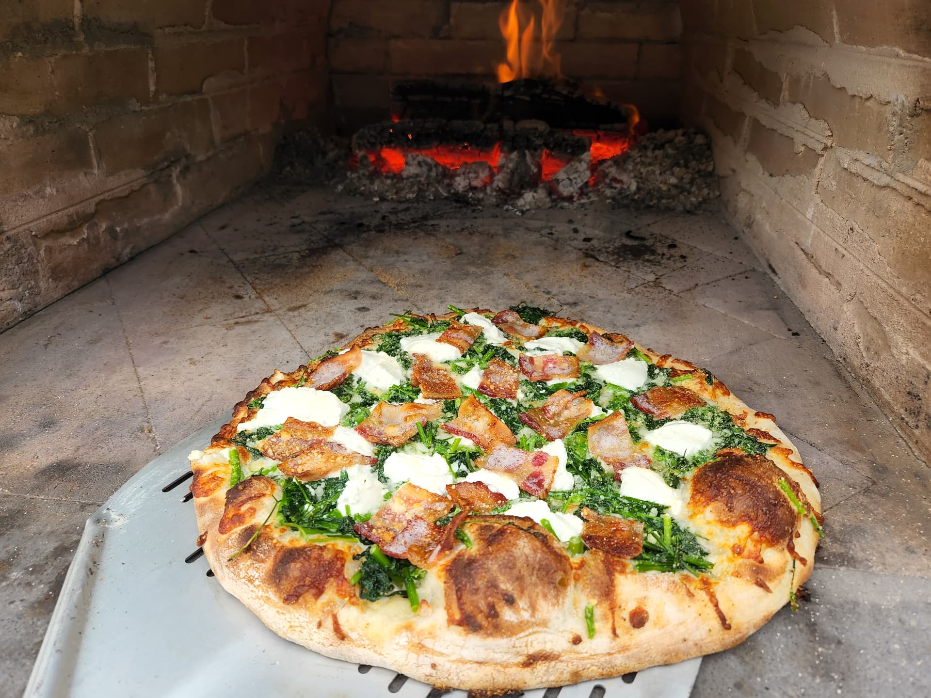

After a little over a year using the oven I am noticing that 2 of the front hearth firebricks have settled a little bit. I have installed the gasket on the steel door. I thought about the possible pitch of the extended ledge which is perfectly level. I am assuming this is from some water getting in. My question is should I be concerned or somehow correct this. I noticed today here in CT after last nights and this mornings heavy rain I had some more water seep in onto the hearth surface. I have never seen standing water but you can tell it’s wet.
Please Enjoy my e-pie!
I’m thoroughly enjoying my Mattone Barile Grande Oven. It makes delicious pizza and works great with my cast iron pans!

Unfortunately the photos don’t seem to show the settling you mentioned. The hearth is “living” in the sense that it is affected by the heating/cooling cycles in a well used oven like yours. It’s a dynamic similar to the one that plants potholes in our fine Connecticut highways.
