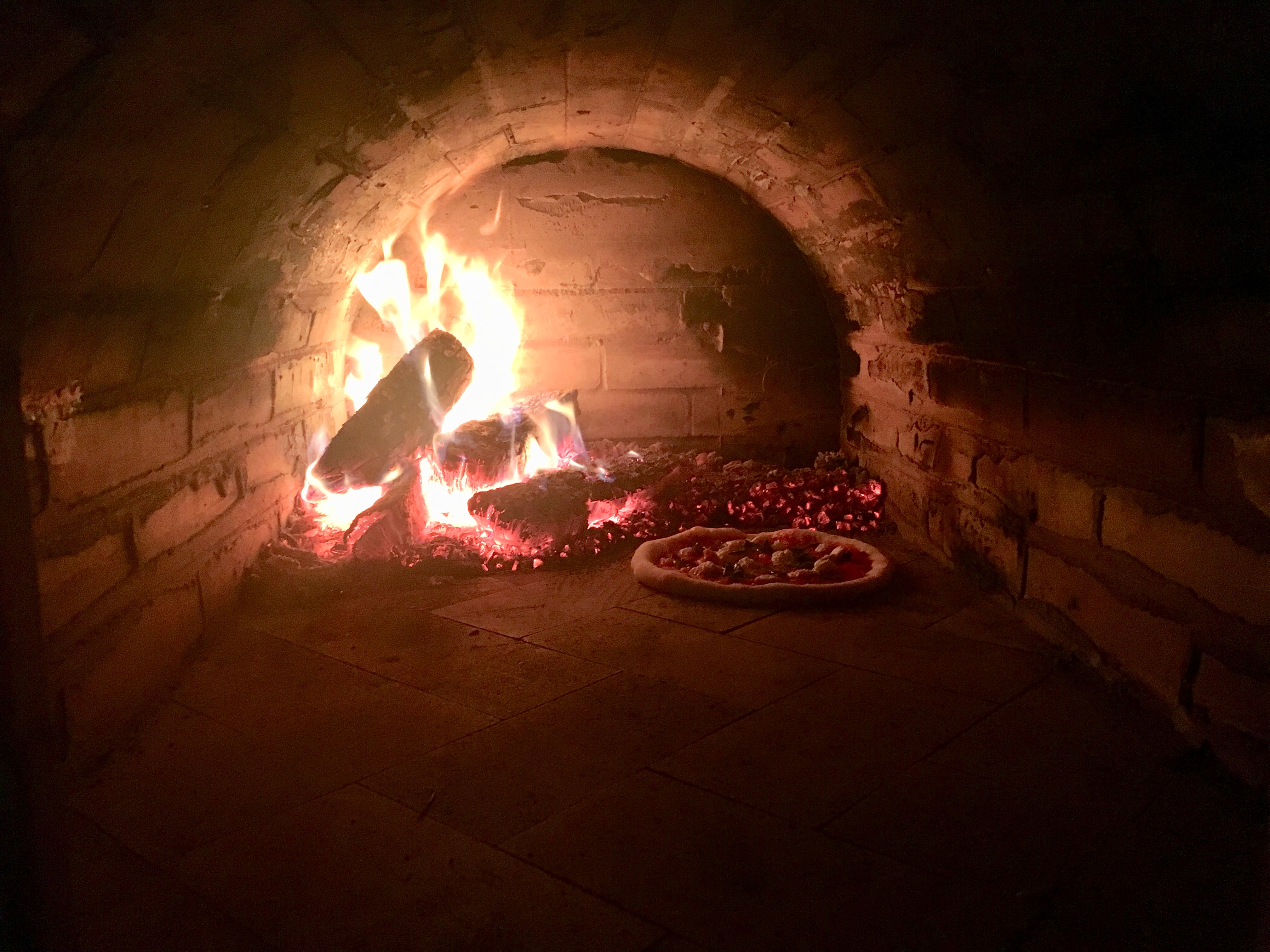

Now, onto more important things, here is that same pizza from above cooking, (Caputo 24-hour ferment, fresh San Marzano puree, pinched mozzarella, basil and EVOO) . . .

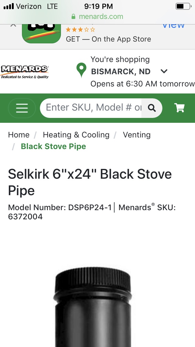

Not sure if you have a Menards in your area, but it’s my favorite place on earth. Here are the parts I used for the damper / rain cap. The Dura Tech is by far a superior product, painted steel doesn’t compare to stainless steel.
The Dura Tech just wasn’t the style I was going for, I don’t think it matched with my oven.

Thanks for showing your materials list for your exhaust kit! Not everyone orders a DuraTech - so the Selkirk kit you’ve shown is a very good alternative.
