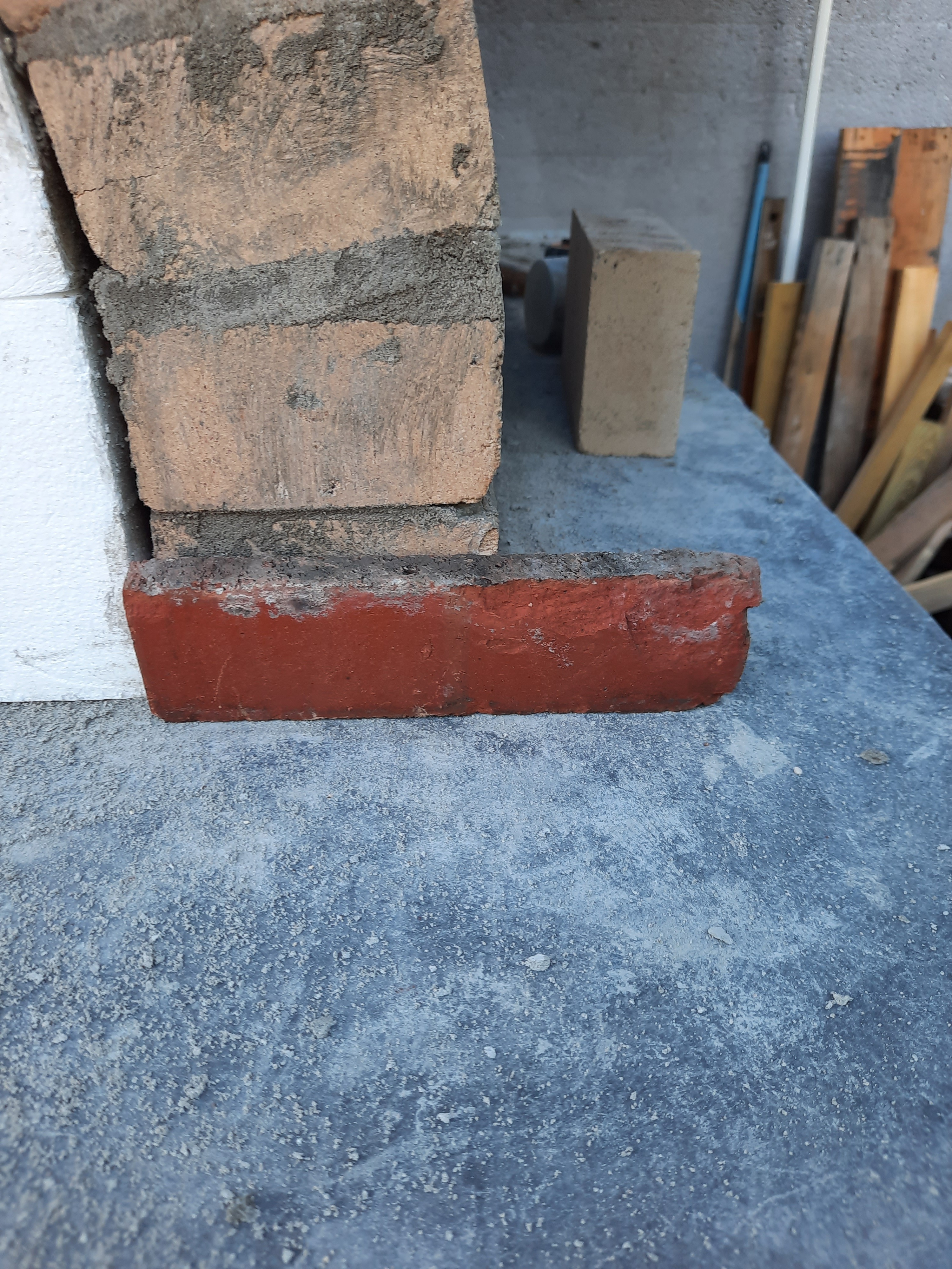

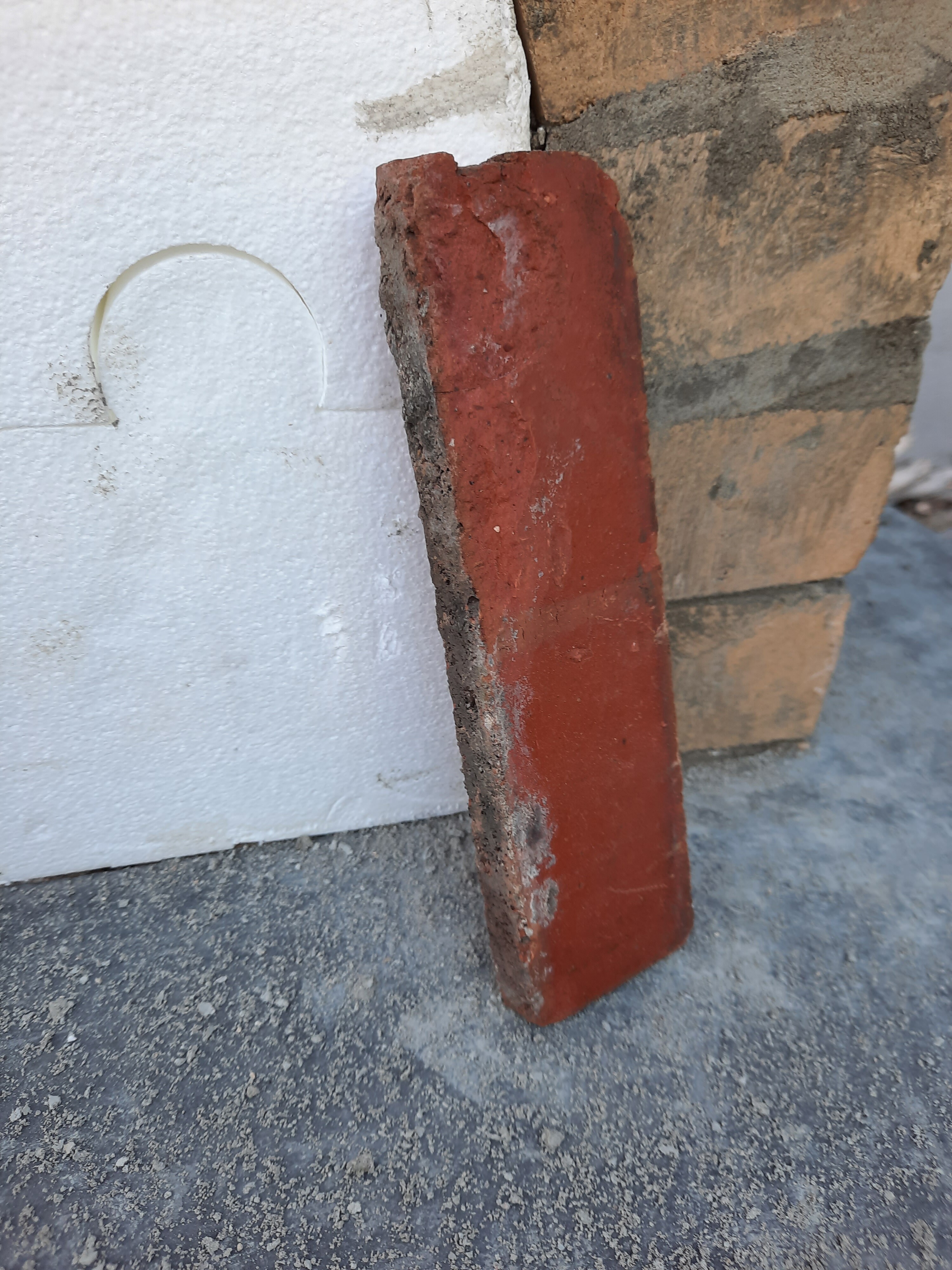

I am using splits that are anywhere from 1/2 to 5/8 thick. Because I’m using the clark oven as my inspiration to finish off the front would I want to start the insul. blanket flush with the front as opposed to setting back an inch per the plan?

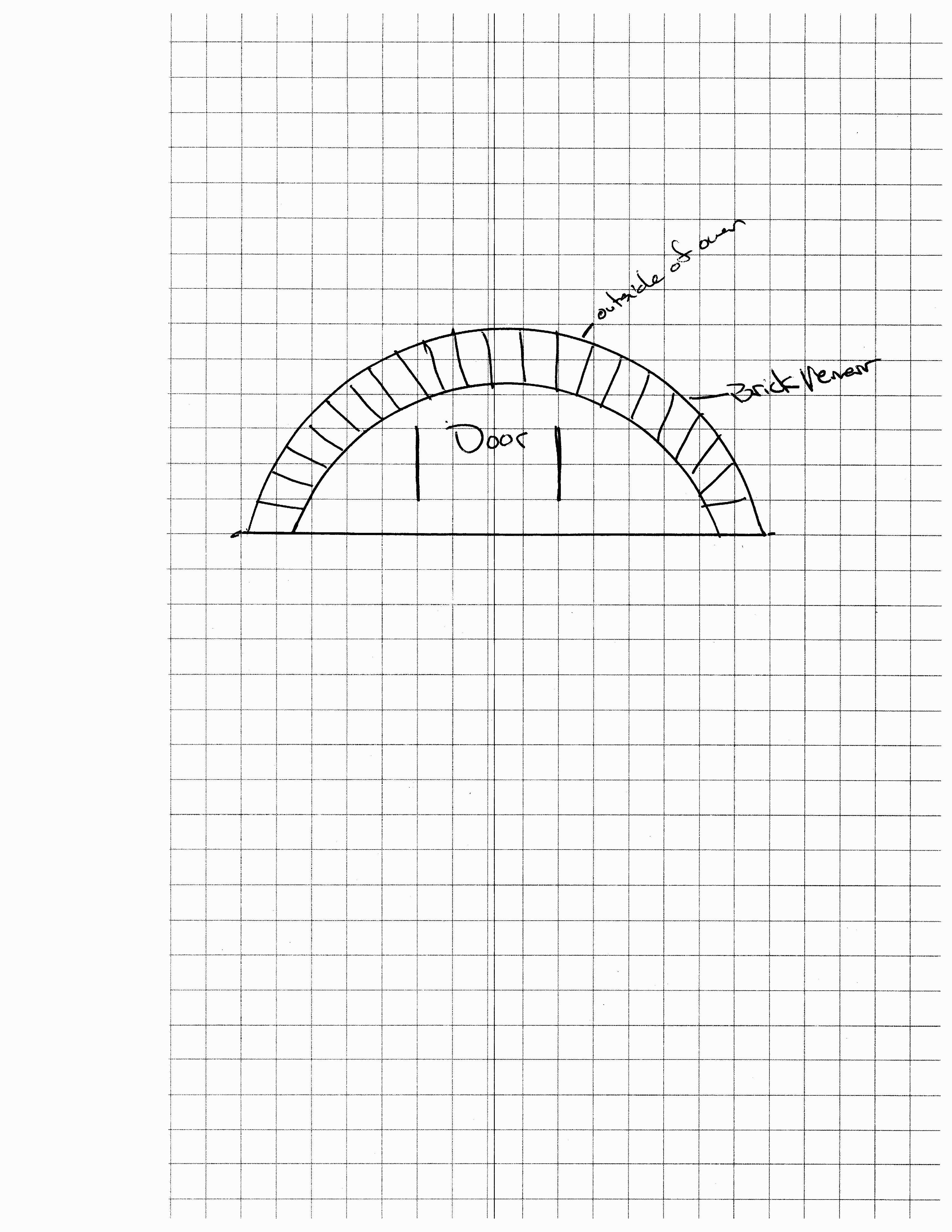

I’m not visualizing that well, as described. Could you send a photo or napkin drawing?
Okay this will help me explain better.
Should the brick veneer continue all the way to the inside edge of the oven interior so when in place the door would sit in front of the brick veneer.
or
Should the brick veneer end at the outside edge of oven door. This would allow the door to inset I suppose. This would leave a small amount of firebrick exposed.
I hope I did a better job explaining
Dave
Jumping on real quick…
The Barile Series door “seals” the oven by pressing against the inside edge of the fire brick.
On the Mattone Barile Grande, the door overlaps the firebrick by 1" on all sides. If you are using the Barile Series door on the smaller Mattone Barile oven, you will have about 2" of overlap.
