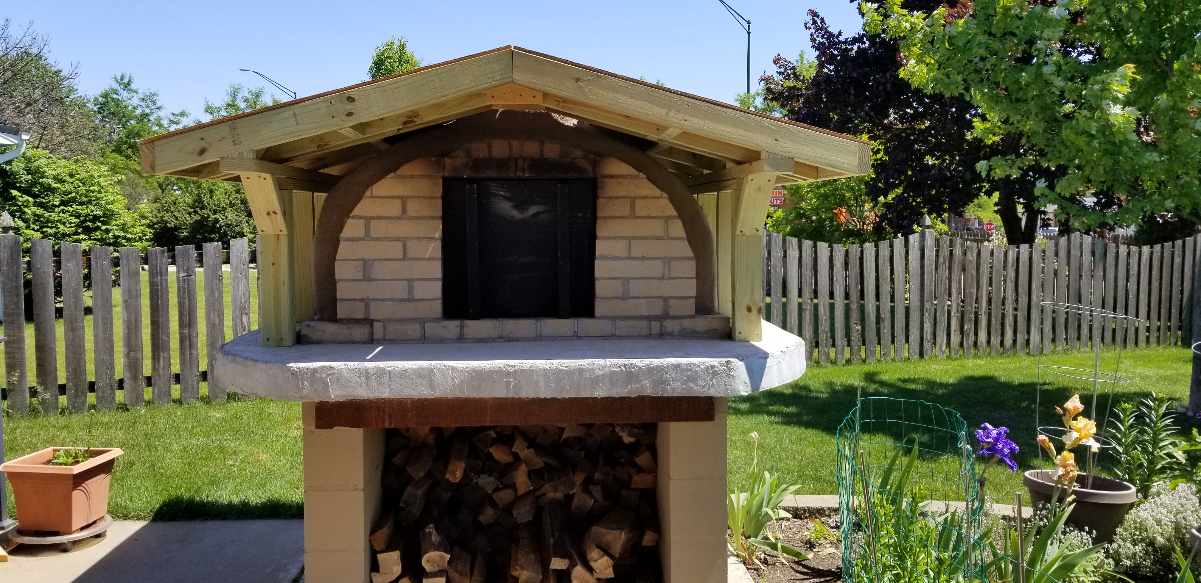

If your going to do what I did and build a enclosure over it then you do your scratch coat or base coat in two layers and paint it to seal it. Here is what I’m talking about as an enclosure.
