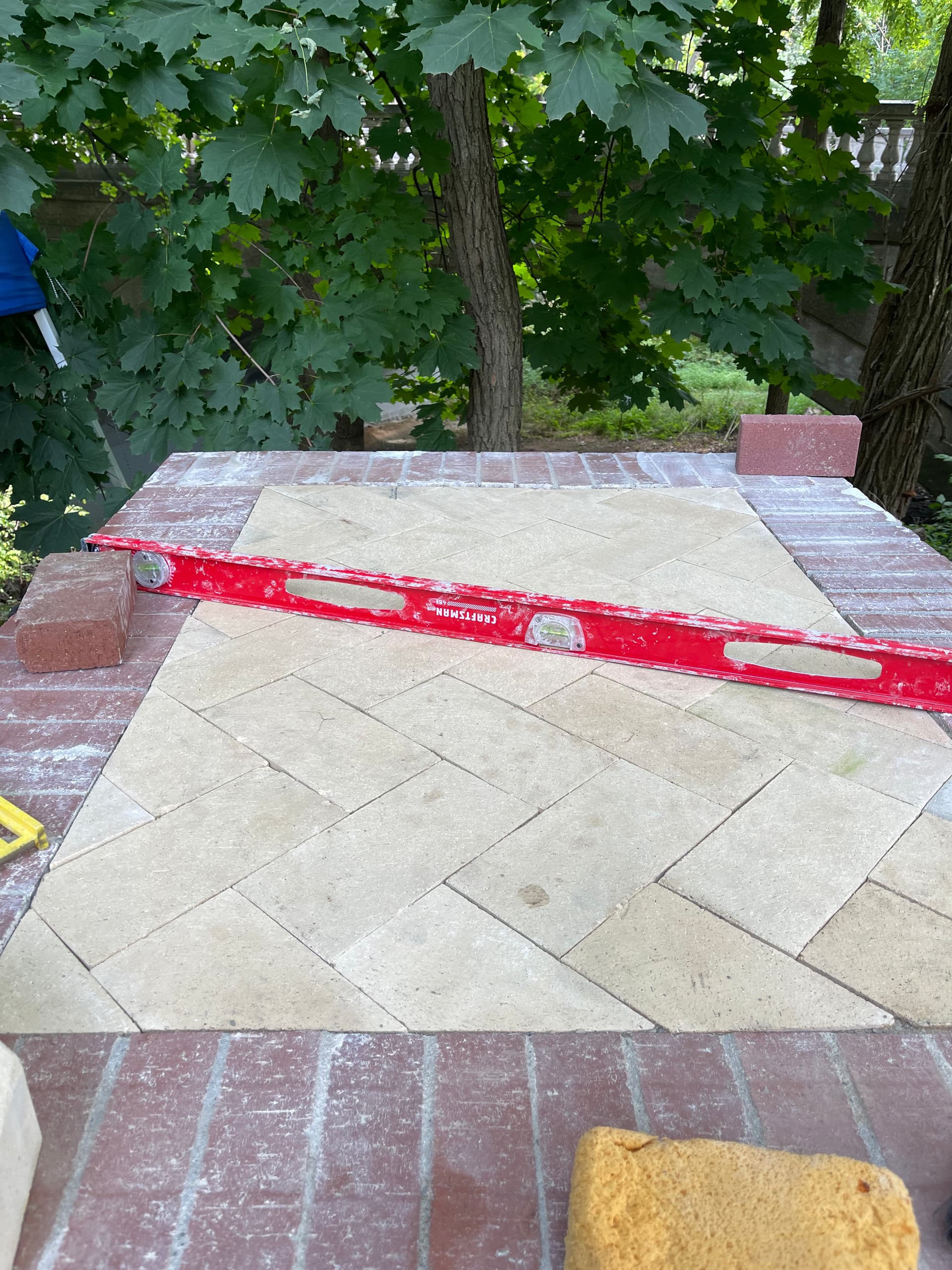

How does this look. It’s level. I tend to be a little OCD. I want to make sure I’m not over doing it. Is this good? Or does it have to be perfect.
That looks great! As discussed previously the edge bricks will be covered by the first course of arch brick. I think this looks very good indeed, and I pronounce it perfect.
Thanks for helping to “walk me through” this. I appreciate your input and feedback.
