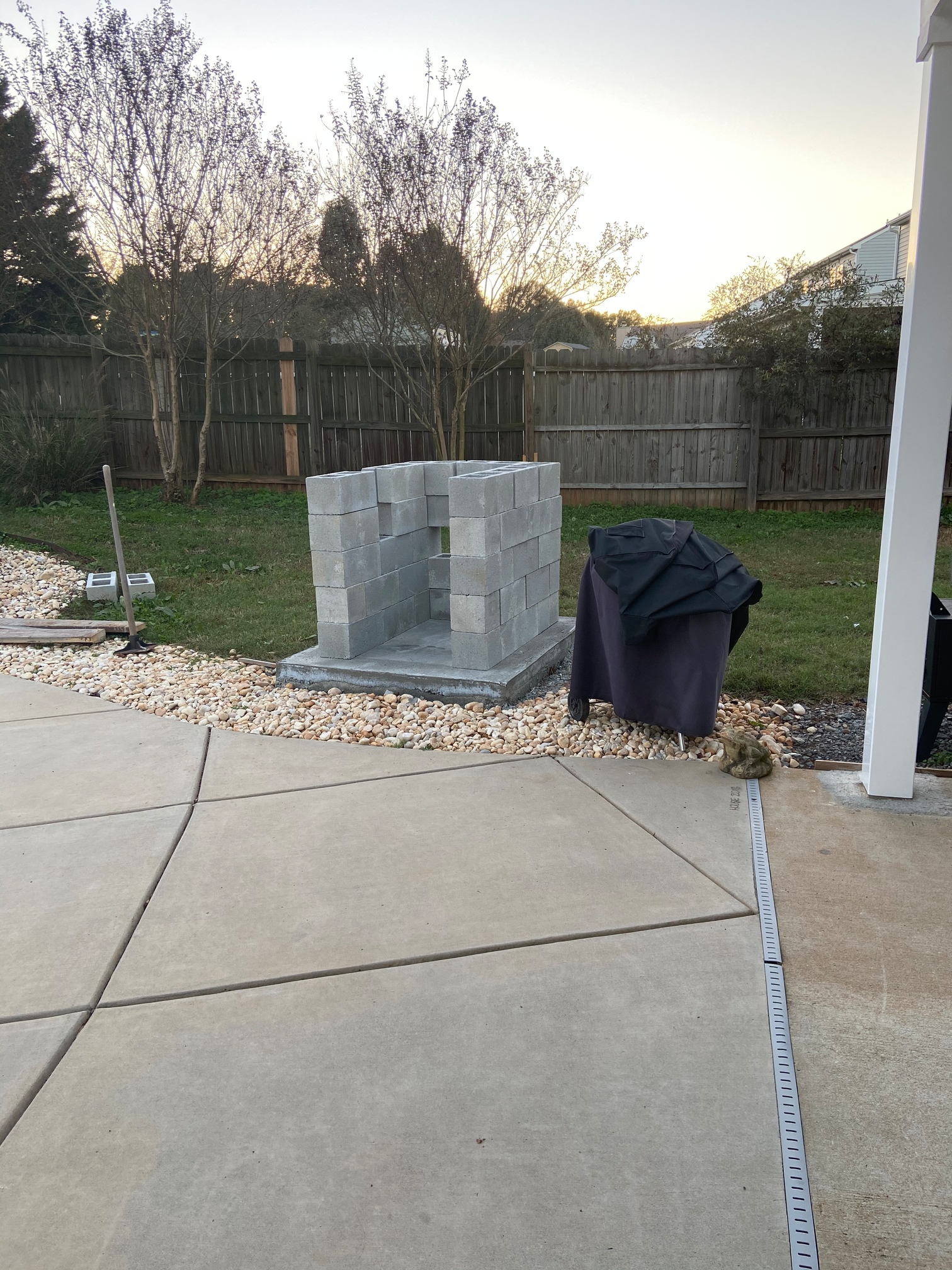

This fall I have started the build down here in SC…going to in corporate a low heat smoker under over in place of storage…bad idea?

I think that’s fine. “Low heat” is the key, of course, but as you already know from building your base and slab, you’ve got a highly over-specced structure there.
I’m not familiar enough with smokers to know whether you still need some kind of venting system. What are you picturing for that?

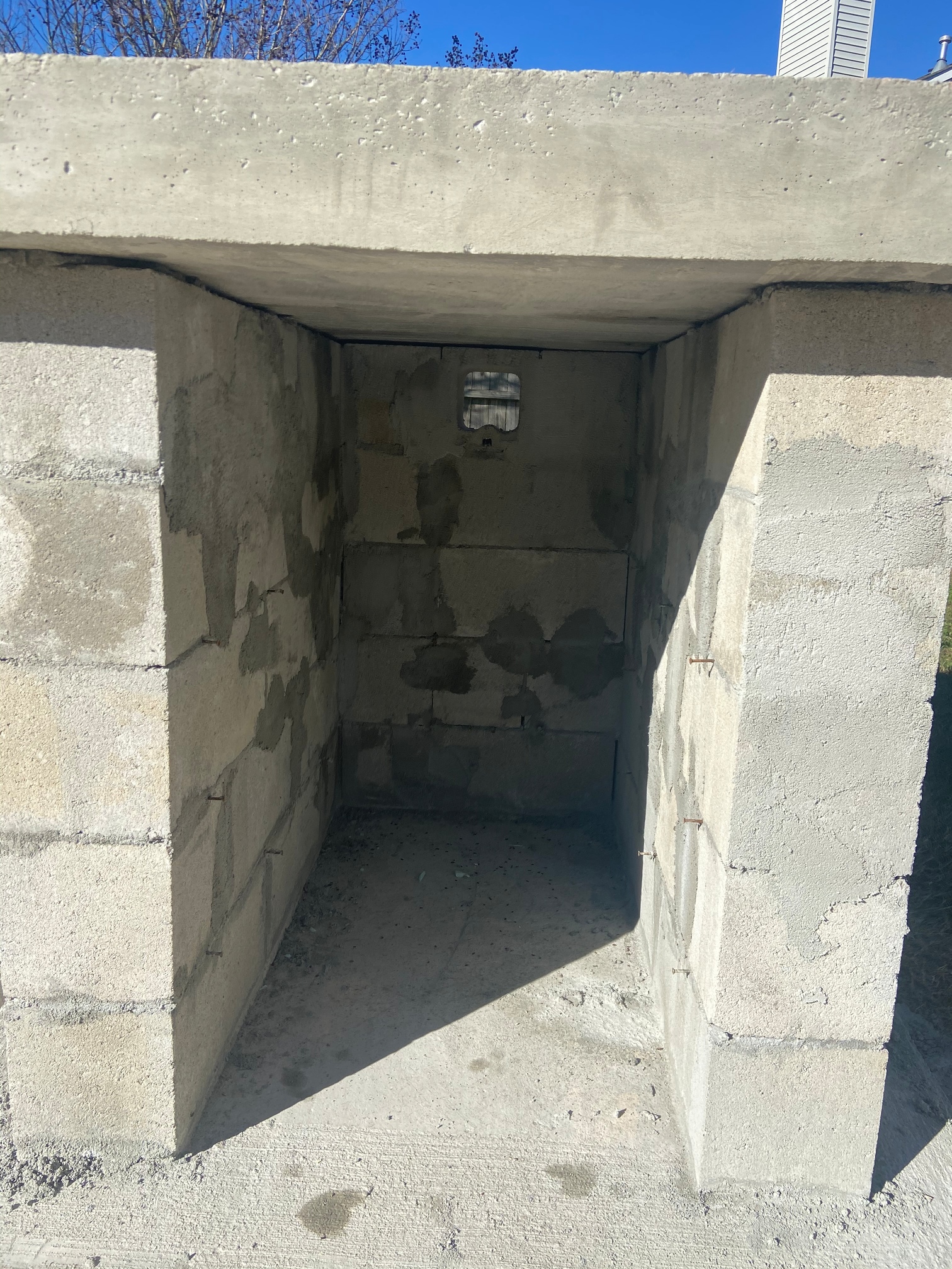

Hey Matt, thanks for reply. My plan was to build the smoker right into the bottom. When I built the base, I turned a 8x8x8 cinder block sideways for a rear vent. I’m having a door made to put in front and the door will have a damper to control the airflow…I think my logic works so we shall see. Worse case I stack wood in there!!!

I don’t see why it wouldn’t work. One suggestion: you might want to grab a tube of high-heat silicone mortar sealant and run a bead along the joint between the concrete blocks and the hearth slab. Usually we don’t worry about that area if there are any gaps, and it’s even desirable to have an air space or two for ventilation. But you don’t want ventilation; in fact it would be pretty alarming to see smoke coming out from UNDER your hearth, except at the door and damper.
And again, keeping your smoker fires low (and ideally isolated from the floor) is going to be important. The area above the hearth slab is designed for direct flame: facilitating it, containing it, and concentrating it safely. The area below the slab holds up your oven. You don’t want to do anything to compromise that.

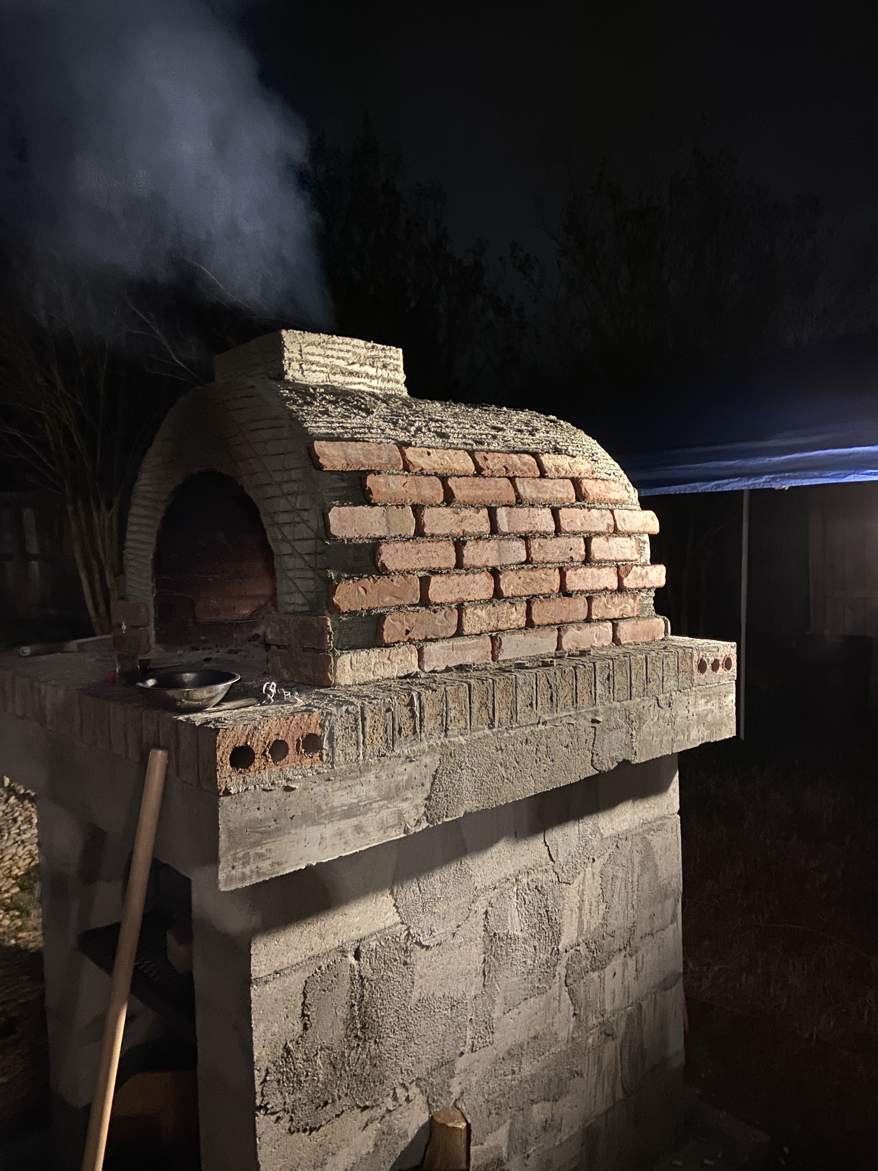

Well we (I) are progressing. Although it’s not perfect, I’m digging it!!! Got a little off on the the oven as I wasn’t perfectly perpendicular to form on a row but it will hide in the shell. Let’s hope my stucco skills are better than my mortar skills.
Hey guys, it’s been awhile…we have been enjoying the pizza oven as I’m almost done with the top. The smoker bottom is coming along, I just got the door to smoker so installed it today. Got to work on heat source as I was only able to get to 180 degrees. We need 225-250 steady. The smoker performs functionally correct. Just some learning curves. Up next wrap the base in stone tile!!!

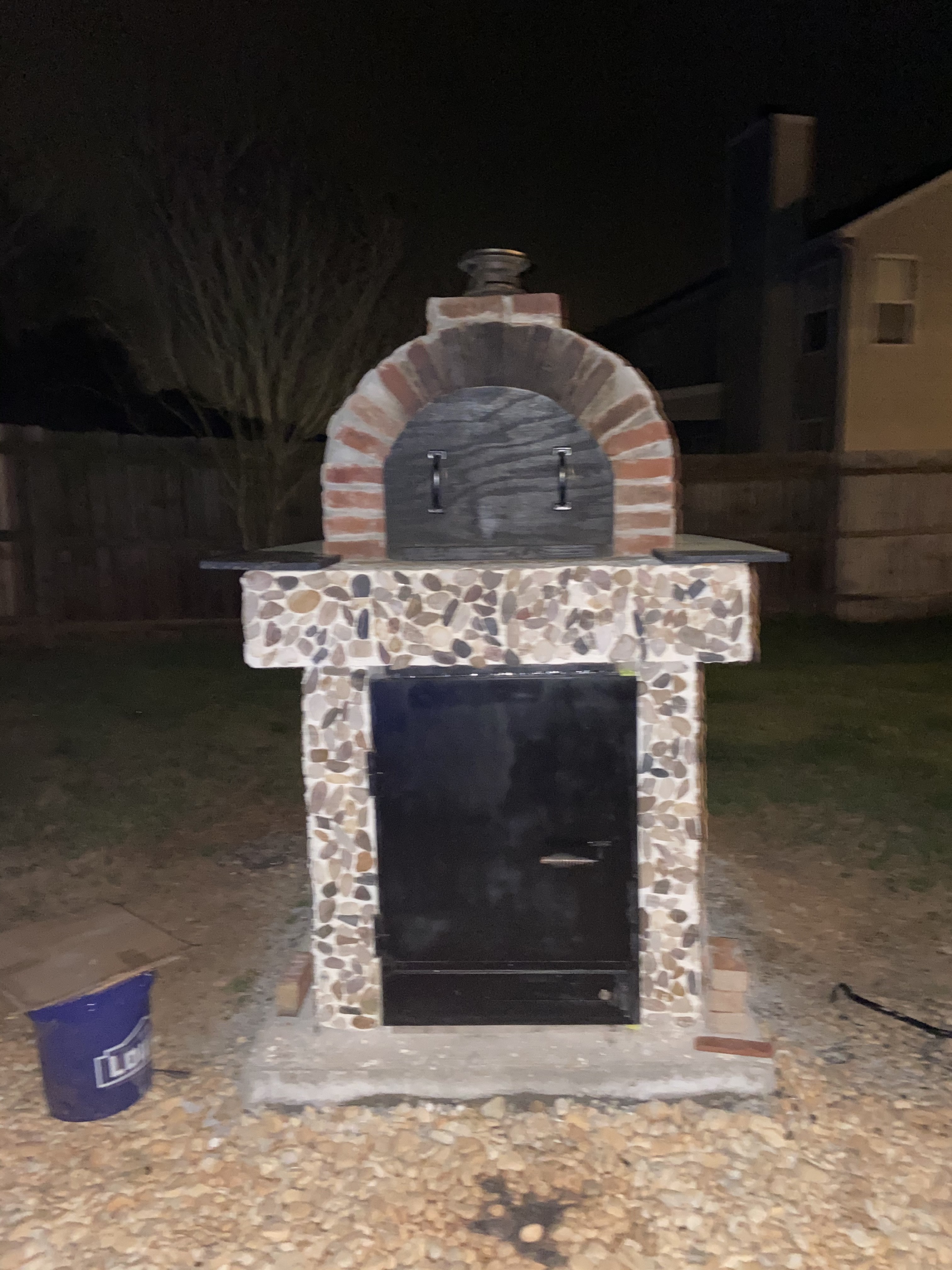

Update today is I am still working on the temperature control and fire technique. I’m experiencing with lump hardwood and wood. The smoke and exhaust is working and expected and I have a damper at bottom of door and a 4” exhaust vent in the back along last row along top cinder block row. As I previously stated, I turned a block sided to create an opening. I am holding a steady 175-180 degrees and have peaked at 250, but won’t hold up there…
The door for the smoker was custom built after I engineered it with a good friend and owner of Noric Steel in Cheshire, CT, Joe Connolly. The Frame is made with 1.5 inch angle iron made from mild steel. I made it .250 smaller than the width, and 3 inches shorter than the opening then blocked up with a ripped 2x4. The frame has .500 holes around periphery to lag into cinder block. The door is .250 mild steel and I put two layers of 600 degree gasket to face of frame and mating part of inside the door. The handle, damper, and hinges were bought from a bbq supply house. Before install I primed all steel and wood, then coated with a coat of High Heat BBQ paint. I’ll update more as we go. I can’t comment on costs at this time. Started this on a napkin last summer
