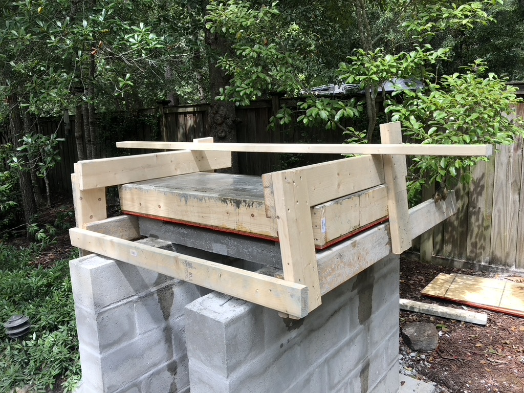

I put the forms onto the base and poured them one at a time, then after they set up I built some wooden tools to flip them over. Wasn’t a lifting problem it was fairly easy to flip.
Note that this was a test fit for the tool. I removed the form sides first and then flipped it over. USE CAUTION.

And finally, more builders in recent years have tended to build each slab in place, as @pebecker describes. Not for nothing, but the wooden tools in his great photo are a lever (the long arm that extends out the back of the base) that pivots at the edge of the slab (which makes it the short arm being levered). Ingenious.

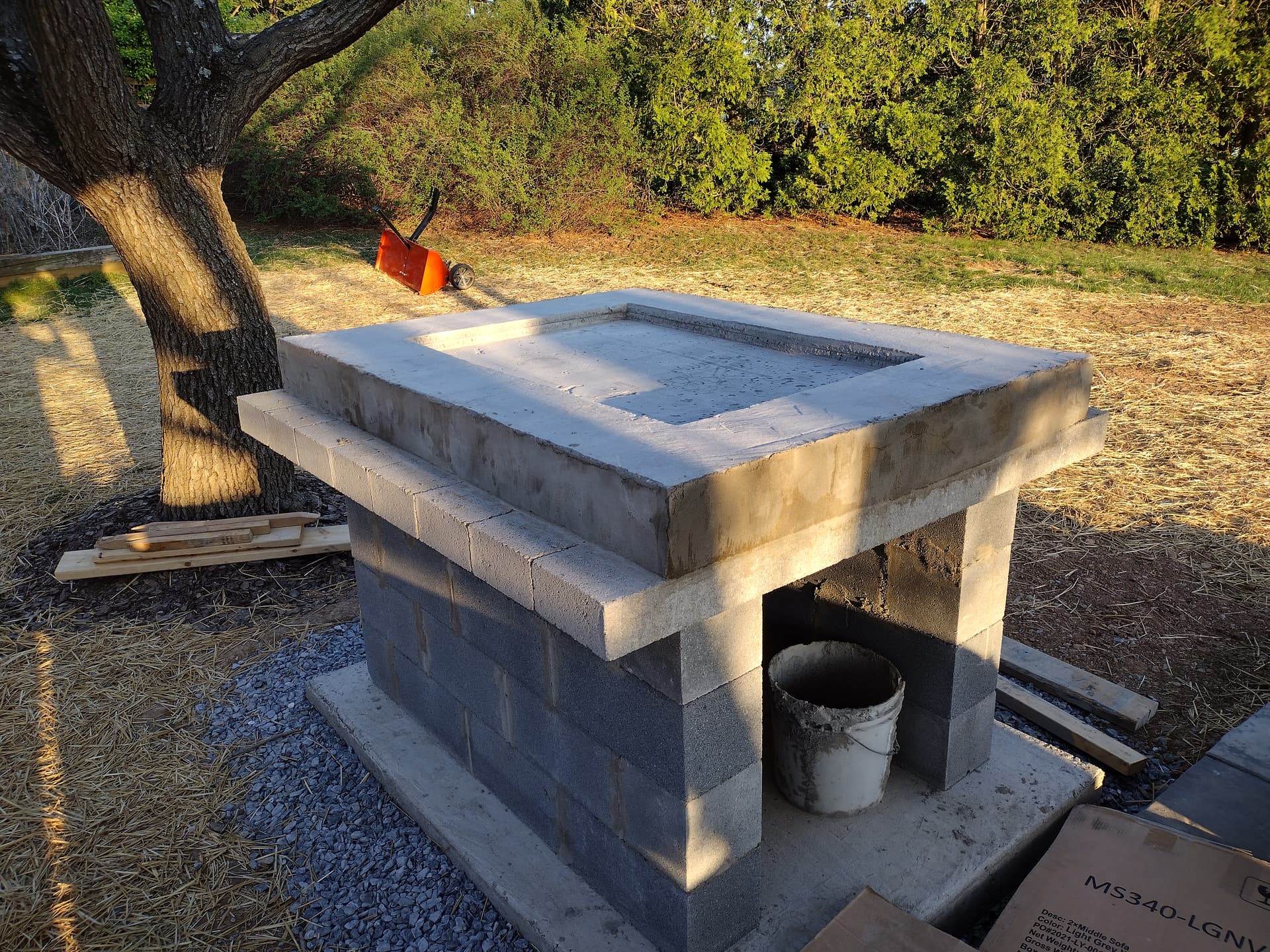

@gspreeman When I built my oven I had the same concern and no available help to lift hearth slabs. As @bikerbudmatt mentioned, some of us opted to build the hearth slab in place doing a single pour. Some built supported wooden forms, but in my case I opted to place individual concrete window lintels on the pedestal and then just build a simple rectangular form on top of them to pour the hearth slab as a single piece. There were pros and cons to this approach.
Pros:
  • No problem for me and a neighbor placing 8 lintels on top of the pedestal
  • Since the lintels I used were wider than hearth, I ended up with nice shelves to place things on
  • No complicated form work, just a rectangle made from the same 2x6 boards used to pour the base slab.
    Cons:
  • Additional cost - while not too expensive the lintels were an additional cost above the original design materials.
  • I was able to buy them from the masonry yard where I bought virtually all the materials for my oven. Lintels are common, but sizes vary and may not be available everywhere.
Hopefully the pictures help, but please feel free to message me if you have questions and search the forum, lots of different approaches taken but there are definitely alternatives to avoid lifting 3 slabs up onto the pedestal.

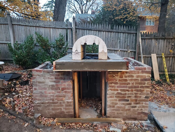

We needed 4 strong able bodied people to lift each of the 3 hearth slabs off the ground on top of the platform - each slab weighed in excess of 300 lbs and lifting it up 4 foot and placing it properly was one of the hardest parts of the job and needed 4 people. Using lintels is a great idea and I would have done it also but we started our oven build a few years ago and had the hearth pieces poured on the ground already…

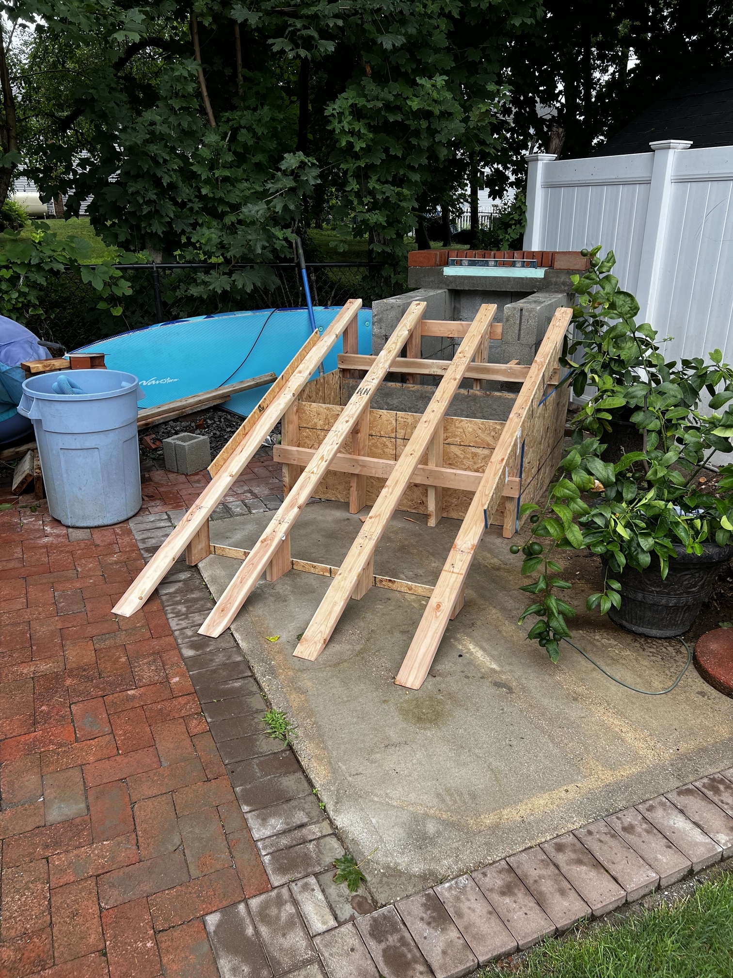

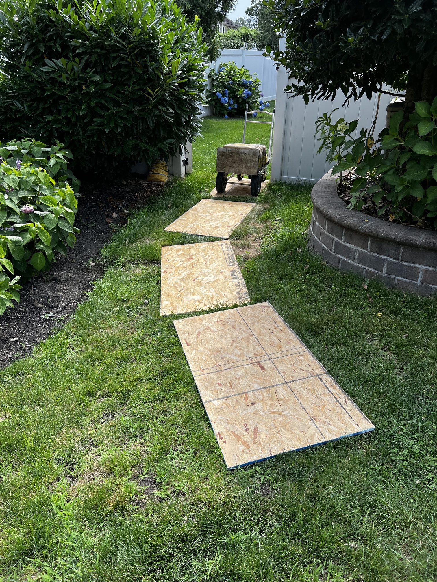

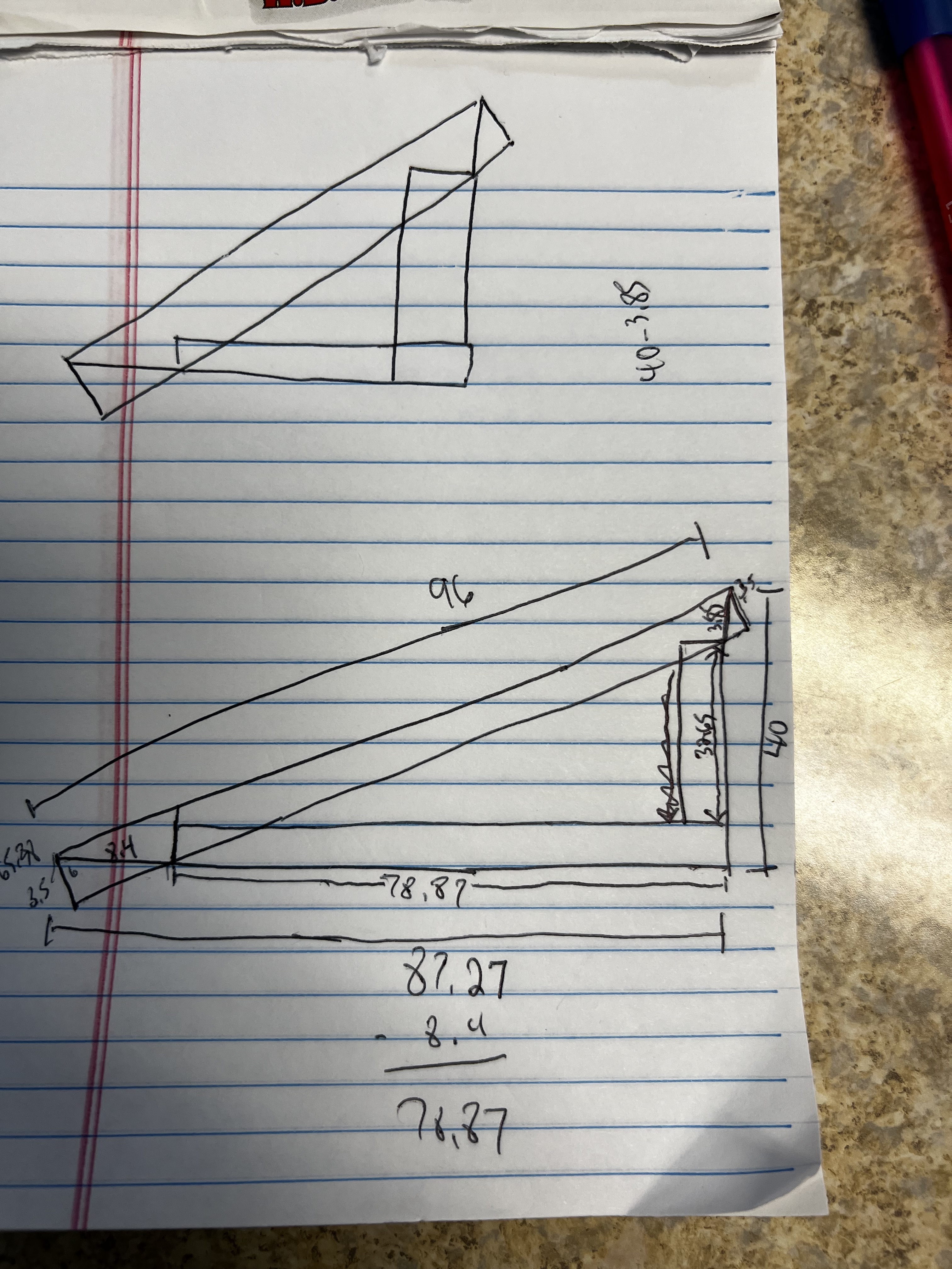

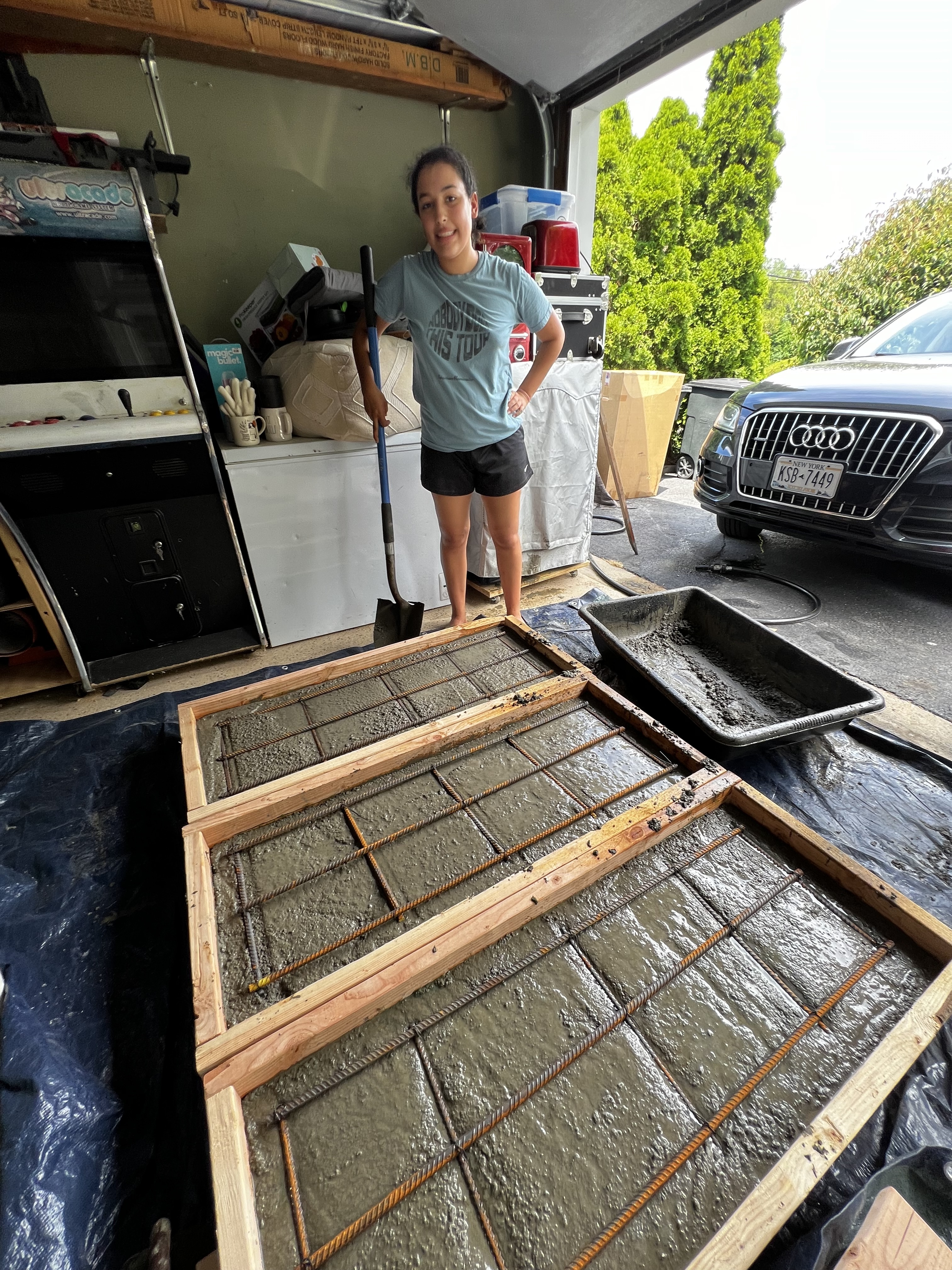

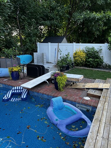

I took on the task of lifting the slabs by myself. Each one 300 lbs !!! No prior concrete experience to draw upon and excited to get started I built the forms in my garage. Then I realized how heavy they were! Fortunately I had a cart/handtruck to move them to backyard. Was a task loading the cart and wheeling slabs to my location. Then hoisting onto the base alone was impossible. 2 hours just to transport and lift just one!! I thought of the creation of the pyramids. Built a ramp. Measured the angles cut a frame from 2x4 wood and levered the slabs up position from the bottom of the ramp with a 2x4. Next two slabs took less than an hour. My contribution, if need to lift slabs onto base build a ramp. Much easier and a hundred times safer. The first slab took 2 hours because all my attempts had to protect me from having it fall one me. If I had to do it again building slabs a in place seems easier. If this is not possible, build close to final location (hard to move) use ramp and a 2x4 lever. simple, sturdy and much safer. Probably much safer with ramp because you don’t attempt to lift slabs at all. You just tilt, slide, rotate. Never lift. Slabs are always on a sturdy base. Ground to sturdy ramp, slide onto sturdy base. Risk of hurting yourself and others much reduced.
