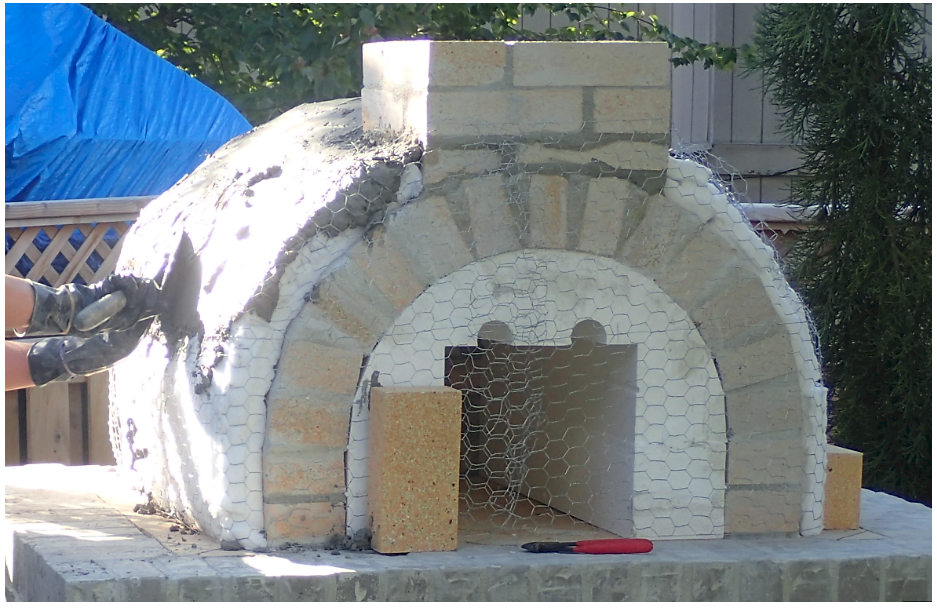

Dry mix the sand, lime & portland cement together and avoid creating clumps in the mixture. Add water slowly to the mixture a little at a time, continually mixing until you have achieved the consistency of whipped potatoes.
Mix for a minimum of 5 minutes then apply the stucco starting FROM THE TOP OF THE OVEN AND WORKING YOUR WAY DOWN TOWARDS THE OVEN BASE. If you apply stucco from the bottom of the oven and work your way up, after awhile, the weight of the stucco (combined w/ the water & gravity) will create a large stucco bulge at the base (basically a big glob of stucco).
