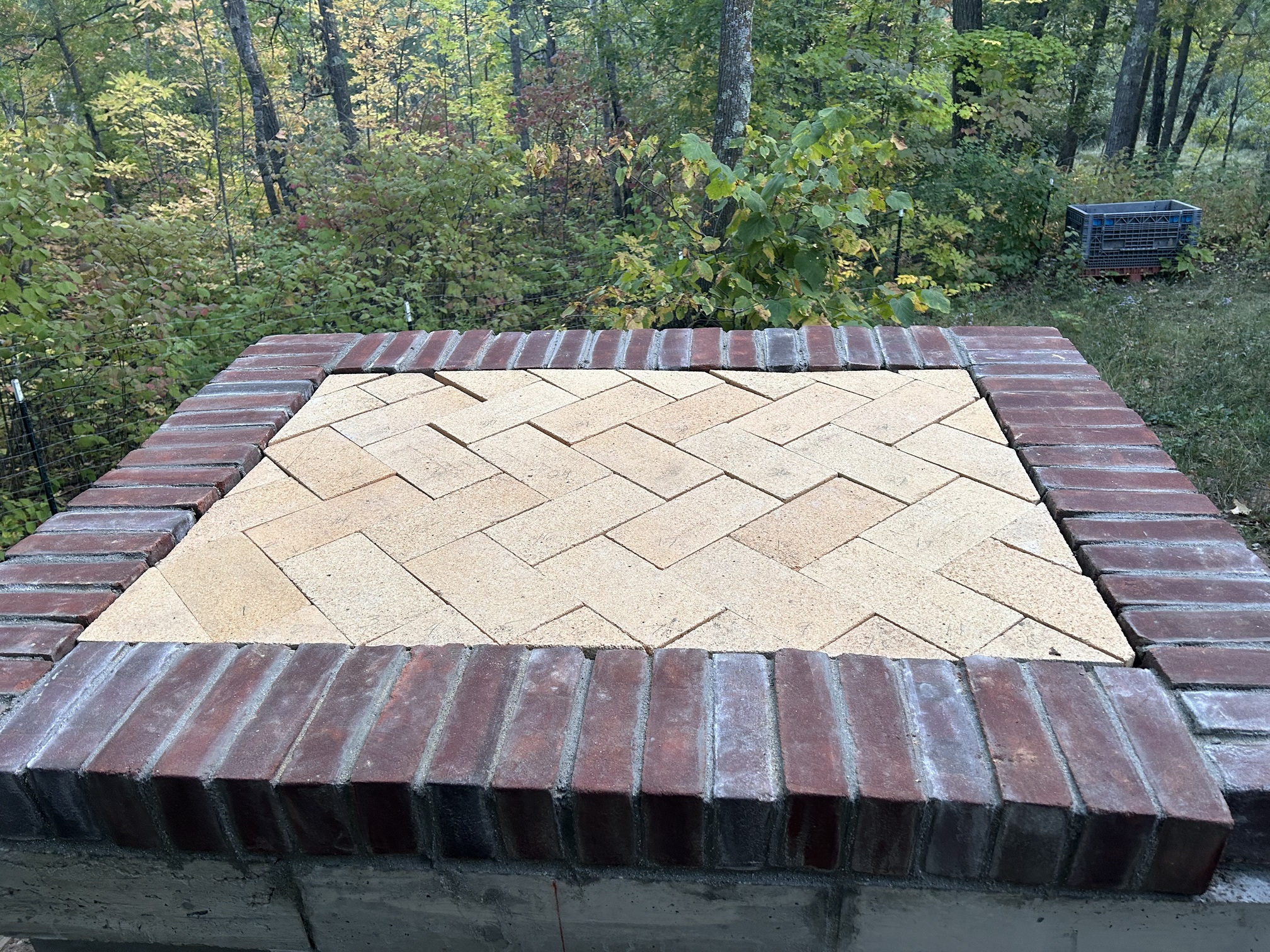

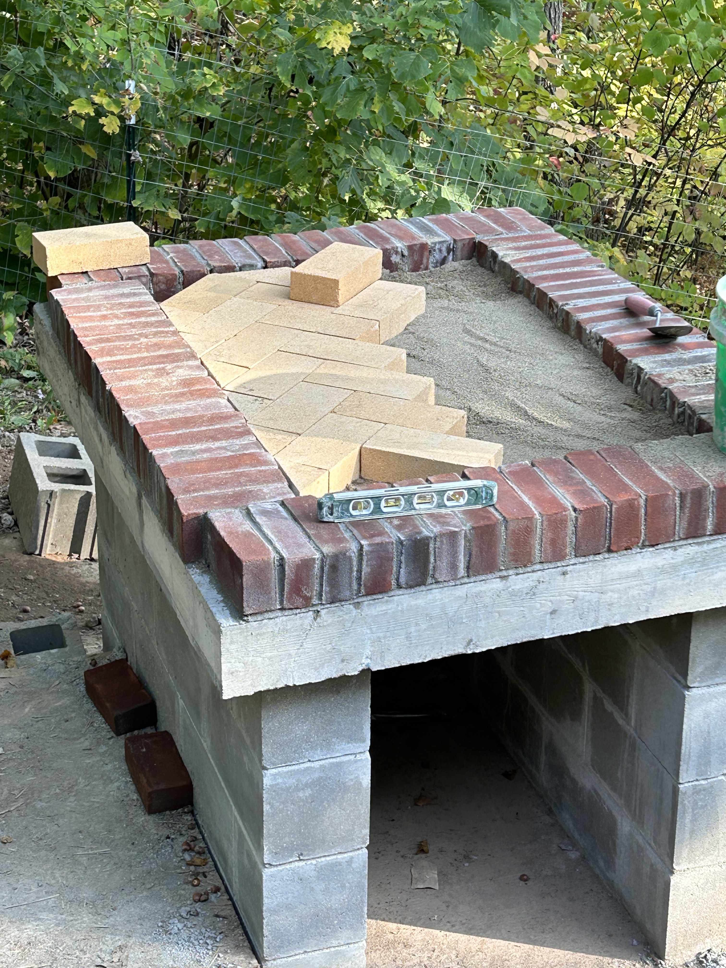

I was reading in the forums about leveling the cooking surface fire bricks and ran across a comment that said I should have used the refractory mortar for the red bricks!! I used ‘N’ mortar. Now what?
I was so proud of myself as these are the first bricks I’ve ever laid. I had to chisel off the first five already and redo them. I’m afraid I’ll have to chisel these all off and buy new bricks.
(I’m still leveling the fire bricks)

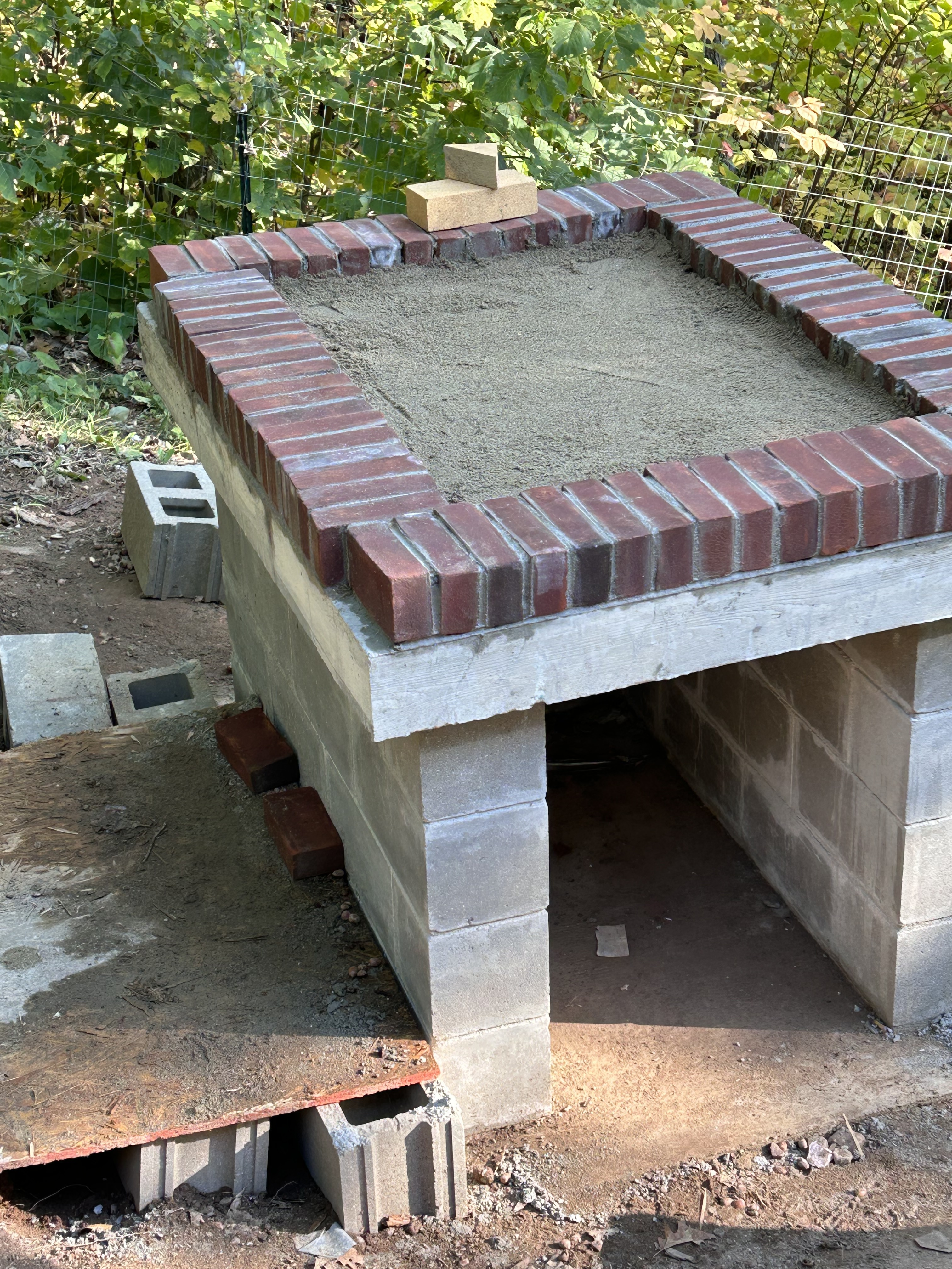

The reason this works won’t be obvious until later in your build. The oven arch will rest on the joint between the firebrick hearth and the outer frame bricks. Those red bricks will not be exposed to direct flame. They will get warm and maybe even hot occasionally, but it’s literally the case that “those babies were born hot.”
The mortar might gradually deteriorate a little bit over the years, but not where you can see it and not in a way that is going to cause your oven to fall apart, ever.
So keep on leveling out that hearth, and keep on building. You’re doing fine, and your concrete work looks amazing!
