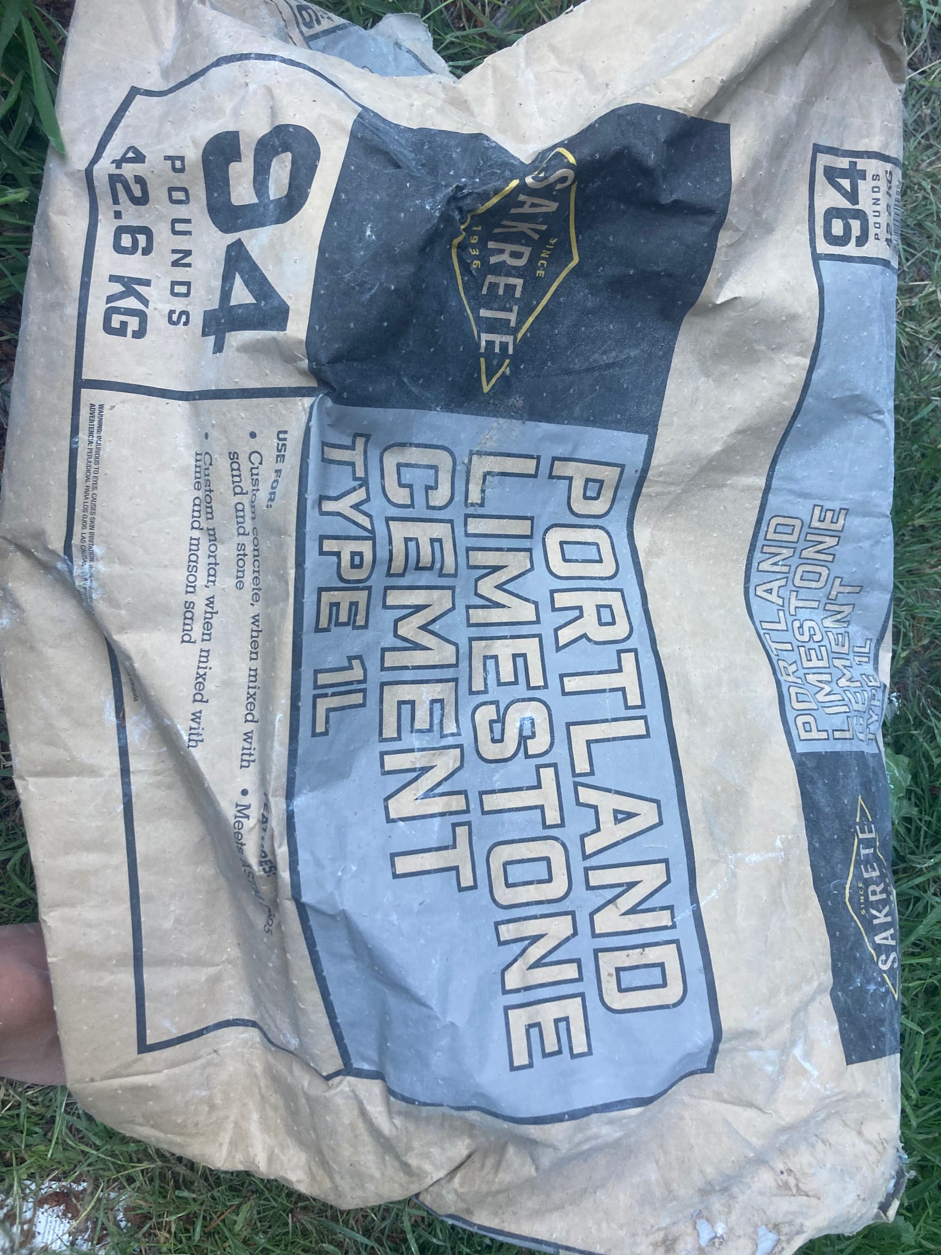

It would help to know the exact ratio of cement to lime that was in the premixed bag. A photo of the bag itself would be ideal, as there should be a mix ratio table printed on it.

Thank you so much for the response! It is Sakrete Portland Limestone Cement type 1L. I can’t seem to find where it has the ratios on the bag.

As @bikerbudmatt says, a picture would clarify a lot.
Hope this helps.
Thanks for the photo, Chelsey.
This seems a little extra-weird, because the closest thing to that name that Sakrete lists on their website is type “IL” (I for Indiana), and I couldn’t find a type “1L”. @kgondoly Ken is our mortar expert on these boards, and I know he’s done extensive research on the different types and mixes. The “IL” mix is an industrial mortar, and has some serious safety considerations attached.
Without knowing what’s in it, it’s hard to advise you. Who supplied the mortar to you? Can they give you more information on the ratio of the mix?
Interesting. I called up the help line a Sakrete. That’s a brand new product that they are switching to because its a “greener” product for them to manufacture. It’s not on their website yet but they are going to email me a data sheet which I’ll post when I get it. They indicated that you can use it like normal portland cement though.

It looks like what you inadvertently did was create a mortar somewhere between a Type N (1 part portland and 1 part lime) and a Type O (1 part portland and 2 parts lime). The good news is that, in general, Type O mortar still has about 70% of the strength as the type N. Given the size of the pizza oven I think you’ll be OK but, for sure, proceed as @BrickWood suggests.
