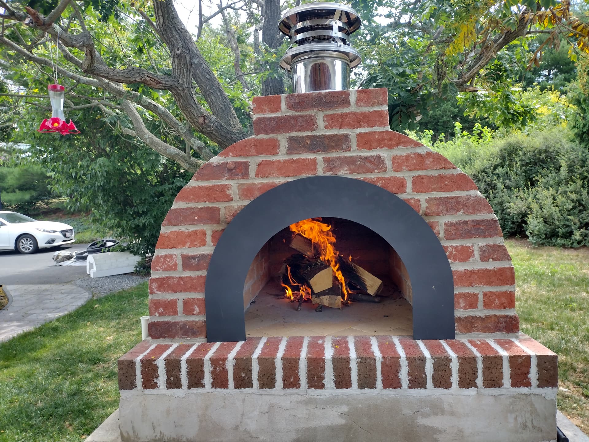

On the subject of closing off the oven a bit. There was a post some time ago where someone fashioned something made from metal. The picture got my attention and should have followed up. I don’t recall if it was made from steel or iron. This device followed the arch of the opening actually looking like a somewhat attractive piece of trim. In essence making the entire opening smaller by a few inches all around the opening. I believe the BWO door was able to fit in front of it as well. I thought there was some sort of flange on the inside to fasten to the brick and recall it was a very nice install. Matt or Kevin do you recall this?
@dlacroix I had a local welding shop make this steel arch for my oven, not sure if it’s what you were referring to. It effectively reduces the size of the opening by 3 inches along the entire opening and was very simple to secure. It retains heat and reduces the amount of smoke escaping the front. $200 (I made a cardboard template of the opening and brought it to the shop).
Very nice! Can I ask how the steel piece was secured to the front of the oven? Is it removable or is it permanent?
Thanks! :cowboy_hat_face:
@AZDon To secure it I purchased a tube of high temperature adhesive / sealant (Amazon.com) and some fireplace fiberglass rope gasket.
I used the adhesive to first glue the rope gasket to the top edge of steel flange. Once it was dry I then applied the adhesive to the rope that is facing up from the flange and then pressed the flange and adhesive onto the brick face. It dried and secured quickly.
Thank you very much, sir!! - appreciate the info - will be trying this.

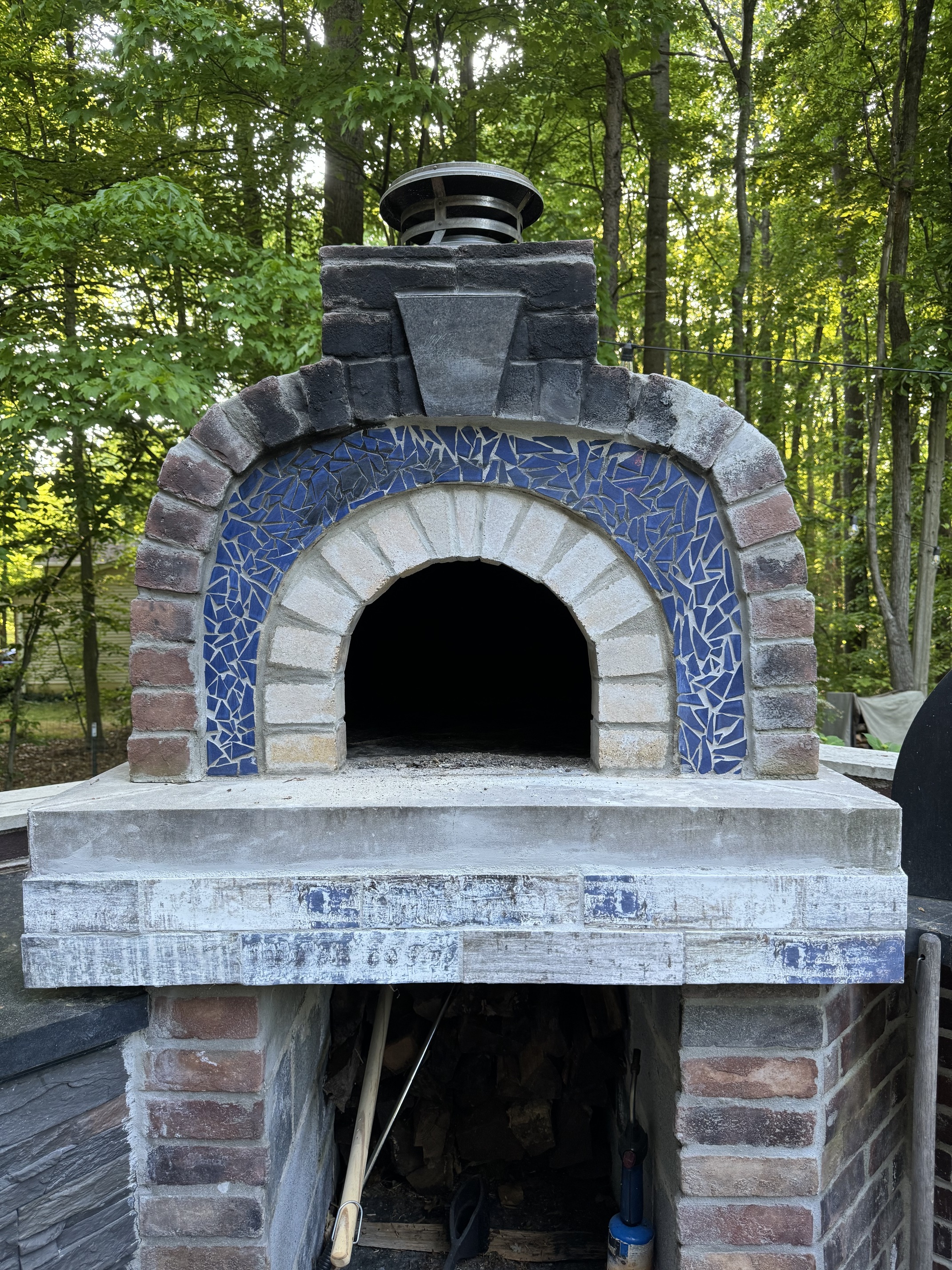

Went ahead and finally did my “inner arch” this past weekend. I did 9” bricks cut in half and that gave me a total opening width of 16.5” and height of 15.5”, I’m gonna give her a go this weekend and see how much of a difference it makes. I still plan on adding the mosaic to that portion hopefully soon as well.
