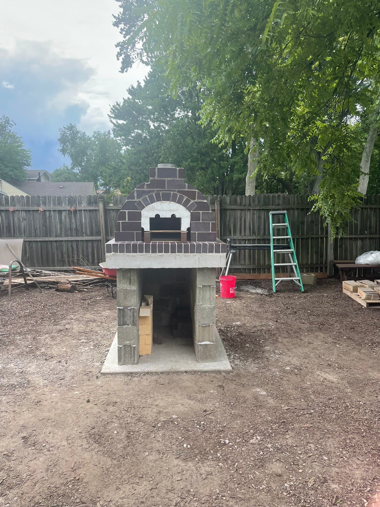

I was able to rescue part of the original for, and cut it smaller to create the closure arch like this. If you can do the same I think you can adjust your brick size however you want.
Hi Bill, and welcome to the BrickWood forum!
Good thinking on your part. Many of us have had to pretty much destroy the foam in order to extract it from the cavity, but as your photo shows that’s not always the case.
Is this a current photo, or is your oven now complete? We’d love to see your final build!

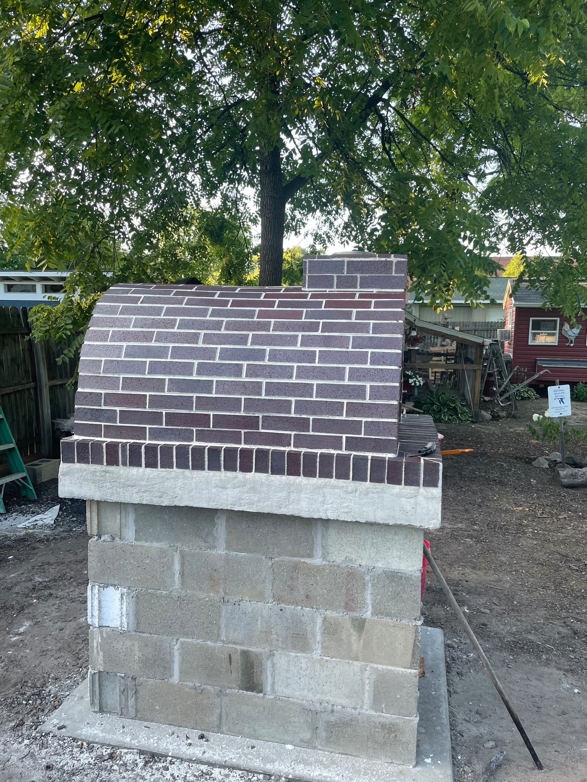

Yes, I started my build right after the 4th of July 22. The oven is complete and cooking pizza. I do still need to cover the cement blocks on the base, we’re currently trying to decide what we want there. It’s definitely been a fun project sourcing’s some of the materials was a bit rough but we got through with out to many headaches.
Love the darker veneer on your arch! You’ve definitely got it going.
That was an issue for several builds that have happened in these past couple of years. The supply chain has been stabilizing and building materials are starting to come down in cost, but I’m still waiting (for example) on a couple of sheets of beadboard that I order (and paid for) back in March.
Have fun finishing off your base. You probably already know this, but you’ll want to use a concrete filler product to smooth over the block ends with ridges on them before you start adding veneer.

Thanks for the tip, and you’re welcome. My only true issue was finding enough fire brick. I live in central lower Michigan and didn’t realize how few brick suppliers are in my area (1) lol.
Beautiful Oven @Bill
Love the look! And I like how you closed off the front of the oven. Looks great!
Thank you, we’re very happy with the way it turned out

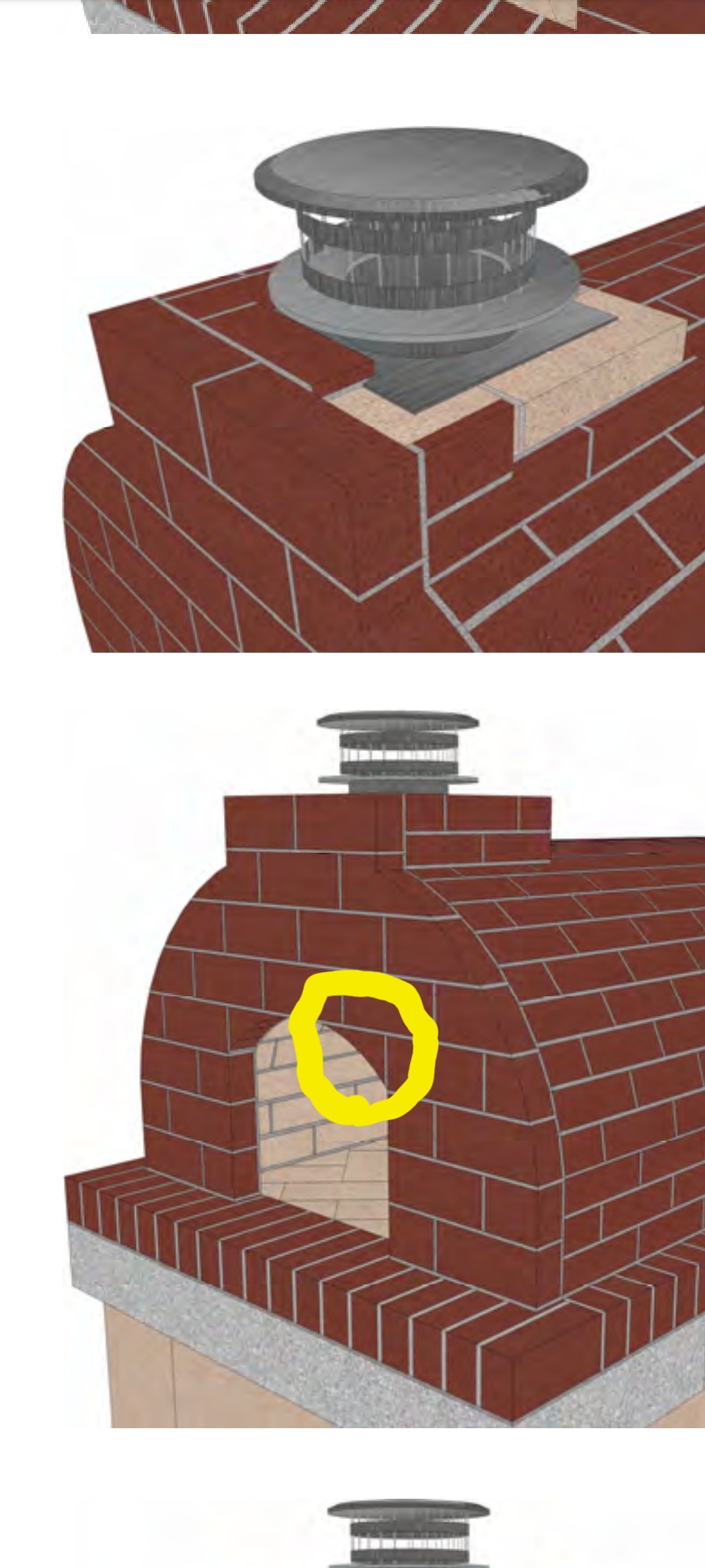

Looking at the diagram, I see 2 bricks that appear to be attached to the under side of the angle iron (making an arch). I don’t believe mortar will hold to the steel, Wondering how to attach those bricks to the angle iron? Would Fuze it by liquid nails work?

@BrickWood might chime in here, but my understanding of that instruction section is that it is not meant to be a firm plan; the idea there is to show one possibility of applying the ratios he describes in that section. In that illustration the two little arcs look like they’re more decorative than anything else.
Look above in this thread at the photo of Bill’s technique to achieve an arched look. That will work with mortar alone because it is another arch and has two means of support:
  1. the “legs” at either side resting on brick
  2. the two half-arches “falling toward” each other
You can also simply go directly across the top of the angle-iron, placing the brick so their ends face out. You should still be sure they are flush to the facing surface so the door closes properly.
My suggestion would be to not take the illustration literally, and to trust your intuition concerning what will look good for your oven.
The angle iron is only 1" or 1.5"… so if you mortar brick to the bottom of the brick sitting on the angle iron, you will need to apply mortar to the portion of the brick that is not touching metal. It will most likely be a small piece being attached, so that little bit of high-temp mortar will hold that piece.
