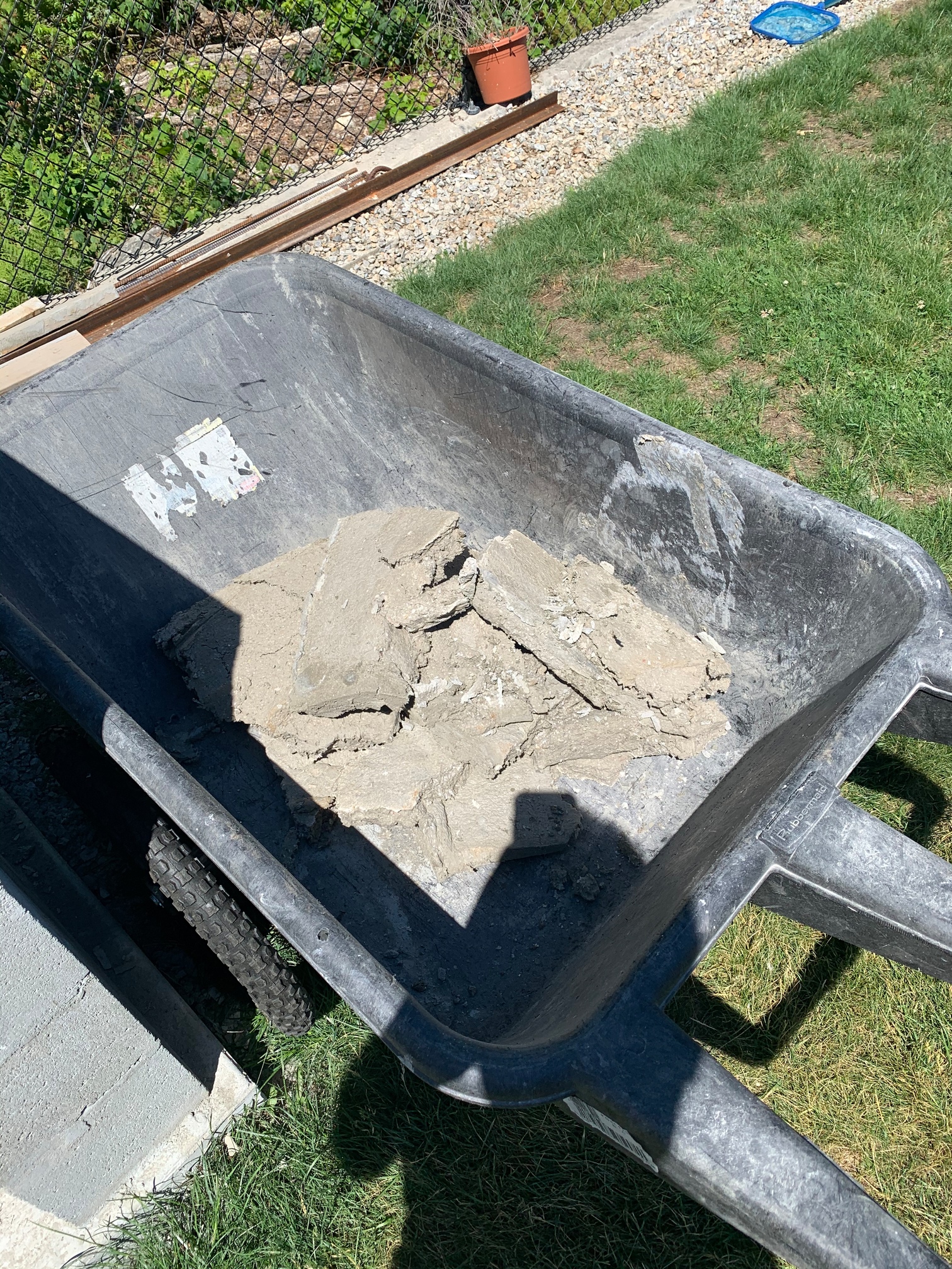

Hello. I’m glad I seen this post. I’m currently on the insulation part for the slab and used the Harbison Walker insulating cement and it cracked on day 3 after pouring. I emailed them and still waiting on a reply. Anyone else have an issue with this product?
@EfranC, I wish your seen my post first! I just poured my oven on Saturday and did the insulation last week. I’m just a few steps ahead of you. Harbison walker insulating cement is the WRONG product. It’s basically rockwool fiber mixed with cement. It will NEVER cure rock hard and will always have some compression to it, NOT what you want under 1,000 pounds of oven. You need greenlite 45, that’s the stuff they recommend for sub hearth insulation. I’d you call them and ask for sub hearth insulation, that’s what they’ll recommend IF the sales guys knows what he’s doing. However, after doing exactly what you did, I ended up going with the perlite/cement mixture and it worked perfectly. Please learn from our mistakes and just go that route. Another complication for me is that my local harbison closed due to covid so I could get the correct product the second time around anyway.

I Removed the cracked insulating cement and did the perlite Portland mix. It’s pretty light weight stuff. The insulating layer in the void itself doesn’t hold a ton of weight besides the sand and firebrick.

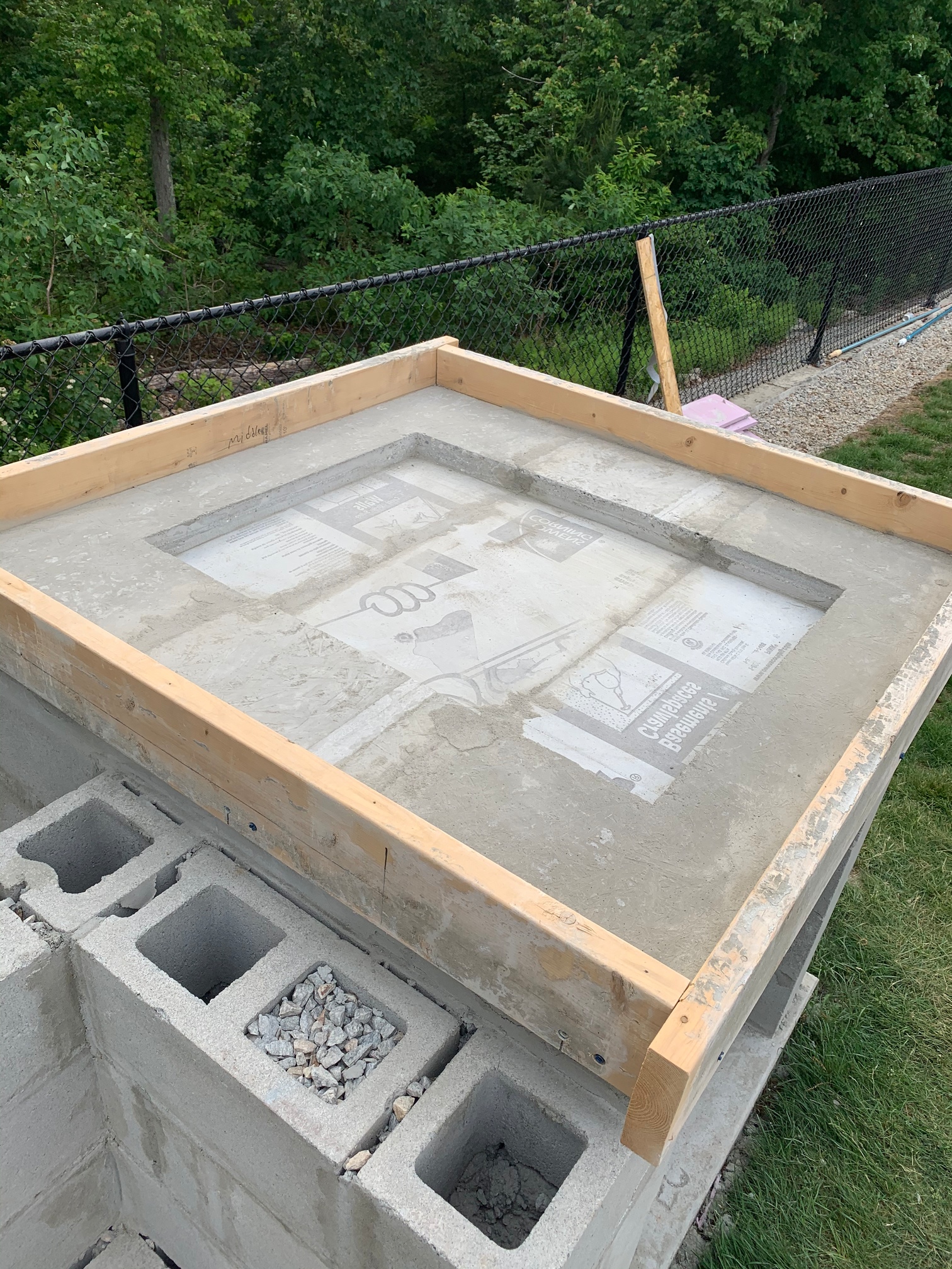

Looks like a perfect pour! It will lighten up overnight and you might see a few pellets of perlite poking up from the surface. Don’t worry about those. The Perlite material has an interesting combination of properties, as it both attracts and repels water. Technically water gets trapped in the microscopic holes in each pellet, but the material itself is volcanic glass so it doesn’t retain the water.
I’m building the 28" cupola as well. Part of the oven’s rim will sit on the firebrick, most of it actually. Only an inch or two on the sides and back sit on the red brick perimeter. Or in your case the concrete perimeter you made. Looks good.
