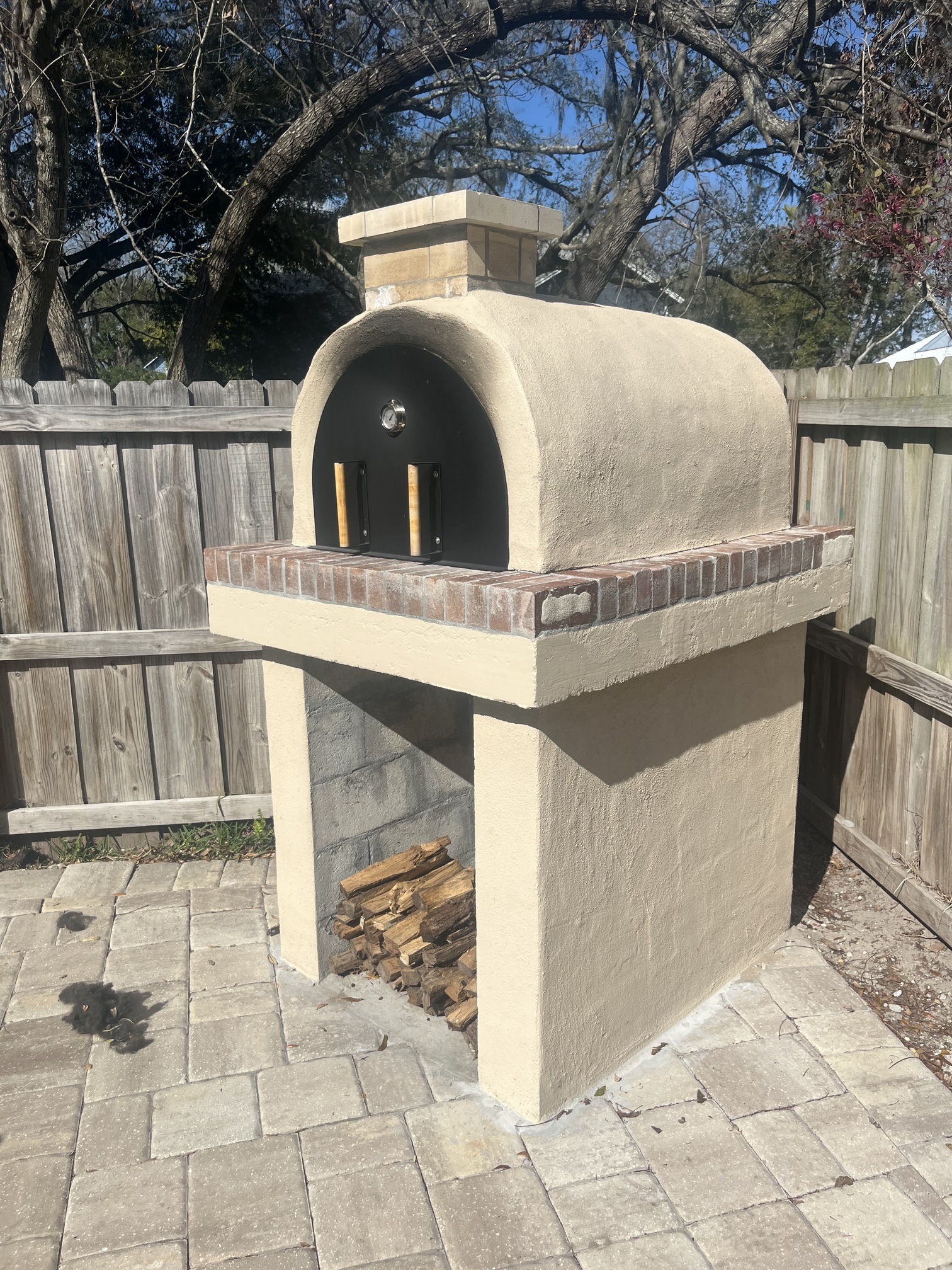

I have had my oven built for about 6 months now. I can get the inside temp to 1000 degrees with no problem but the floor temp only gets to about 350 max. I started a fire about 2 hours prior to cooking last week and let the coals burn down in the middle of the oven. I moved them to the back and kept adding wood to the fire. The floor only got to about 350 especially after I cleaned it with a wet rag. Any advice?

Agree with Matt. Nothing much to add except can you provide a picture of the inside of your oven? Might generate some ideas…
Nice looking oven, looks like a great spot to make pizzas.
I agree with ‘Hawkeye’ @bikerbudmatt, it looks like moisture in the pedestal. If the interior gets soaked the moisture will transfer heat to the hearth and sides. Did the hearth or sides feel warm to the touch? If so, drying fires are needed to drive moisture out of the interior.
Getting a reading of only 350 degrees on the floor after a 2 hour burn is surprising, I would expect at least 600 degrees F. I noticed a thermometer on the door. Can you please elaborate on how you are measuring the oven temperatures? I use an infrared thermometer that is calibrated for brick and masonry surfaces.

I built the floor based on the specs given in the Brickwood plans. I wanted to use the insulating castable on the floor but I could not find it at any of my local suppliers. I settled for the perlite and Portland cement mix. I don’t think I have had any water infiltration into the slab but I am not ruling it out. All seems to be dry inside. The only water may be coming from the chimney as I have not put a cap on it to this point. I am open to any ideas as to what I can do to remedy this issue. The oven is well insulated otherwise. After reaching 800-900 degrees, it will still be 300 degrees 6 hours after the fire goes out. I just can’t get the floor to heat up as well. Our local grocery store bakery sells pizza dough balls that we are using to make our pizzas. The top of the pizza will burn before the bottom is done. With the time and effort I put into building this pizza oven, I want the pizzas to be exceptional. Any help would be appreciated. How can you tell that there is moisture in the pedestal? Is there anything in the picture or are you assuming that is the issues? I will send inside pictures later today. How do I prevent moisture from getting in the hearth?

  2. Sparks. The cap also has a spark arrestor screen. You have two large flammable areas I can see in the photo: the well-weathered fence that’s very close to the hearth, and the tree limbs in the next yard. In dry seasons the right spark can touch off a blaze. (I live in Connecticut which was not known for dangerous wildfires—until last summer.)
I’m looking again at your concrete block base (I first saw the photo on my mobile phone) and realize that what I thought was moisture looks more like latex mortar patching.
Wet hearth brick won’t be obvious to the touch. But you’ll recall from building that you’re advised to soak the firebrick before cutting it, to keep down dust and produce a more accurate cut. It’s one of the reasons for the curing fire cycle, because the brick will later appear to be dry even though it’s saturated.
What’s your climate like? Are you having frequent rain/snow/drizzle or other moisture?
For sure, you would be well advised to cap the chimney as soon as you can. I know that current materials costs have made stainless steel caps more expensive, but it’s both a safety and performance issue that you’ll be addressing.

Thanks so much for the response. We live in North Florida on Amelia Island. The weather usually stays fairly humid. I am going to purchase a cap for the chimney asap. I will also build a couple of fires to dry out the hearth. Hopefully I can keep it dry going forward. Also, to answer another response, I have an infrared laser thermometer to measure the heat of the hearth and interior while cooking. I will keep you updated.
