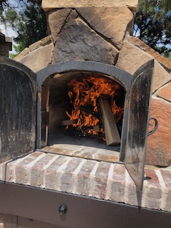

Fair enough. I cured the oven over a two week time frame. Small fires each day, gradually making a bit larger. I’ve fired it up to cooking temps 4-5 times. Right now I’m cooking only pizzas. It has taken about 3 hrs to get temps of between 550 and 700 depending on area of the oven. Once I cook a pizza the oven floor temp drops significantly. By the time I do a third one it takes several minutes to cook. About my fire, I build it in the middle of the oven and over time move some embers to other parts of the oven. When I’m about to cook, I move wood and embers to the right side of the oven. I have an andiron placed there to keep new wood with plenty of air surrounding it so it can burn more efficiently. The flames do lap the oven roof as I cook. I usually place a new piece of wood or two on the fire as I start to cook. I generally will place a piece or two of wood on the other side of the oven so it can warm up and fire up as soon as I put on on the fire. No lag time. I see here you put your fire to the rear of the oven. Do the flames heat the roof ok that way?
The entire project time was a couple months. Weather delays. So it’s had time to cure naturally as well. Thoughts?

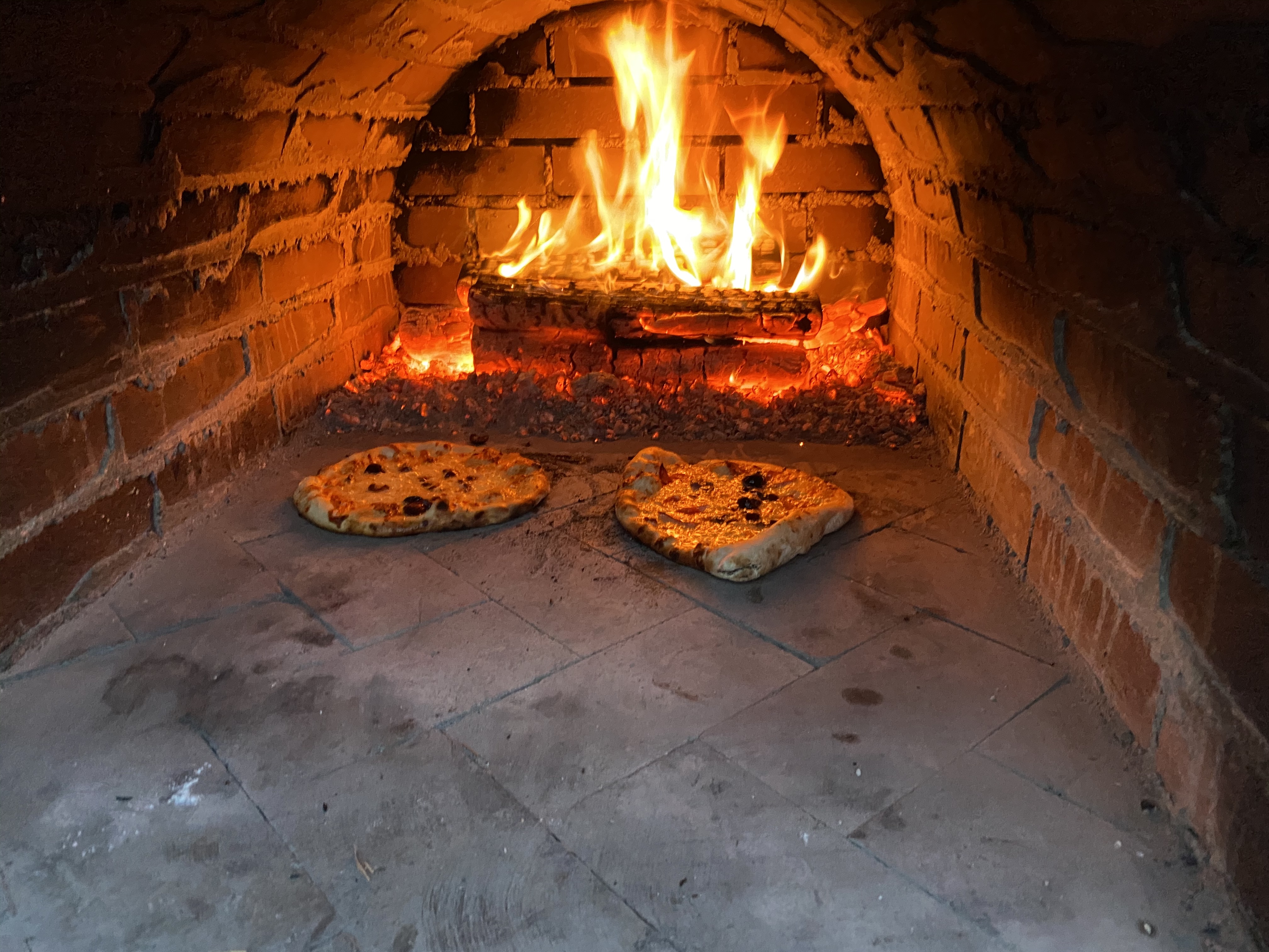

- You asked about the fire being to the back: yes, that’s the place for pizza-ready flames. The design of a barrel oven encourages us to do this for pizza. In my photo you see a white-hot concentrated bed of embers, 2 to 3 flaming logs…and notice how the light from the fire (which equals infrared heat) is distributed equally to either side. The heat goes straight up and forward, with the exhaust gas from the flames being drawn forward toward the chimney opening at the front. In this particular photo the floor is between 650° and 700°F where the pizzas are baking.

Thanks for the info. In fact she’s cranking now so I’ll give your advice a try. The dough is resting till room temp. I’ll keep the fire blaring till ready to cook. I have an andiron that I’ll push the embers under and keep the new wood on top.
Thanks for the kind words on the build. It was quite the project. Never did any masonry work before. I have one later fire brick, ceramic blanket, three layers stucco and then finished it with stone as you can see. So add another layer of mortar and stone. I’m not concerned I don’t have enough insulation factor. If you want more pics just let me know.
