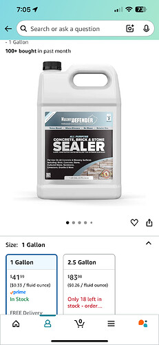

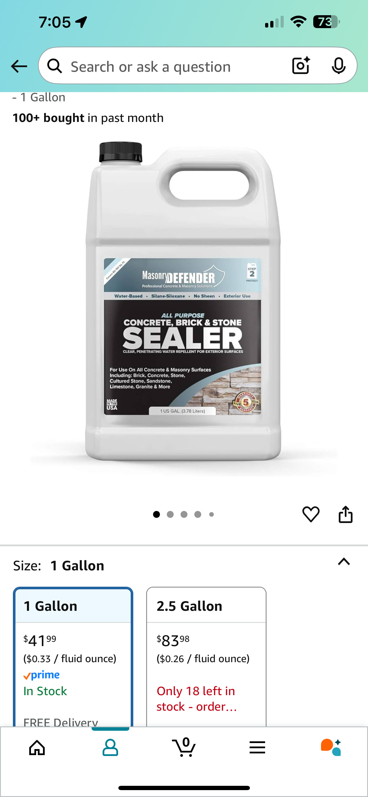

In the first year of using the oven, I had a similar problem where I could not explain the moisture in the ashes. I did two things the first was seal the edges of the Mattone Barile where it meets the base. I was thinking this would prevent water from resting on the base and being absorbed in that groove. This did not solve my problem. Second, I sealed the brick with a brush on concrete sealer to provide moisture resistance but allow the brick to breath. This application was dull/satin and did not affect the texture or look of the brick. Once I did this, I have had NO further moisture problems inside my oven. My oven has a door. However, it appeared, the water was collecting in the back of the oven, not near the door. Since sealing, the entire external structure with concrete sealant I leave the Ash inside and to this day after now a year it remains completely dry. Always.
My conclusion, the porous brick soaked up the moisture and this moisture was trapped inside the structure. It responded to drying fires but always came back after it rained.
@Drpizza Thanks for sharing! Which concrete sealer did you use?
