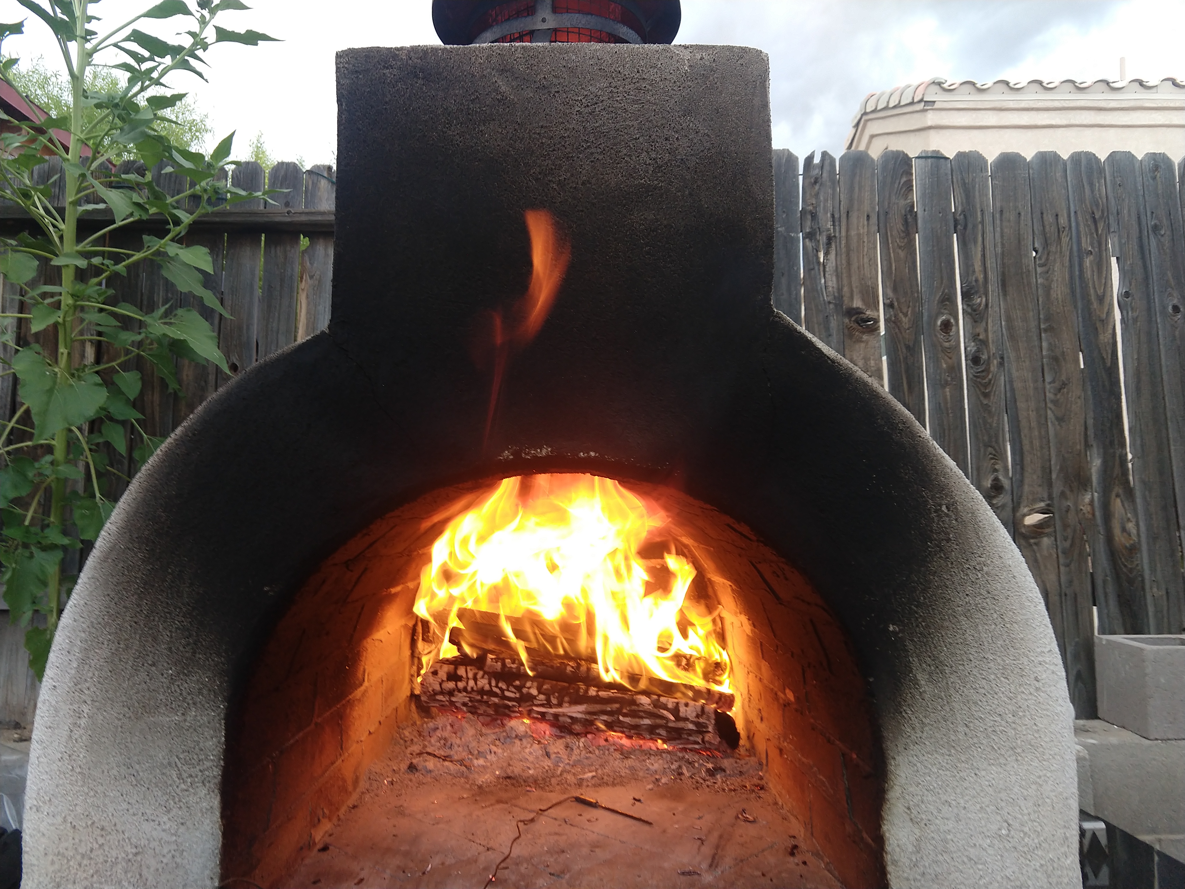

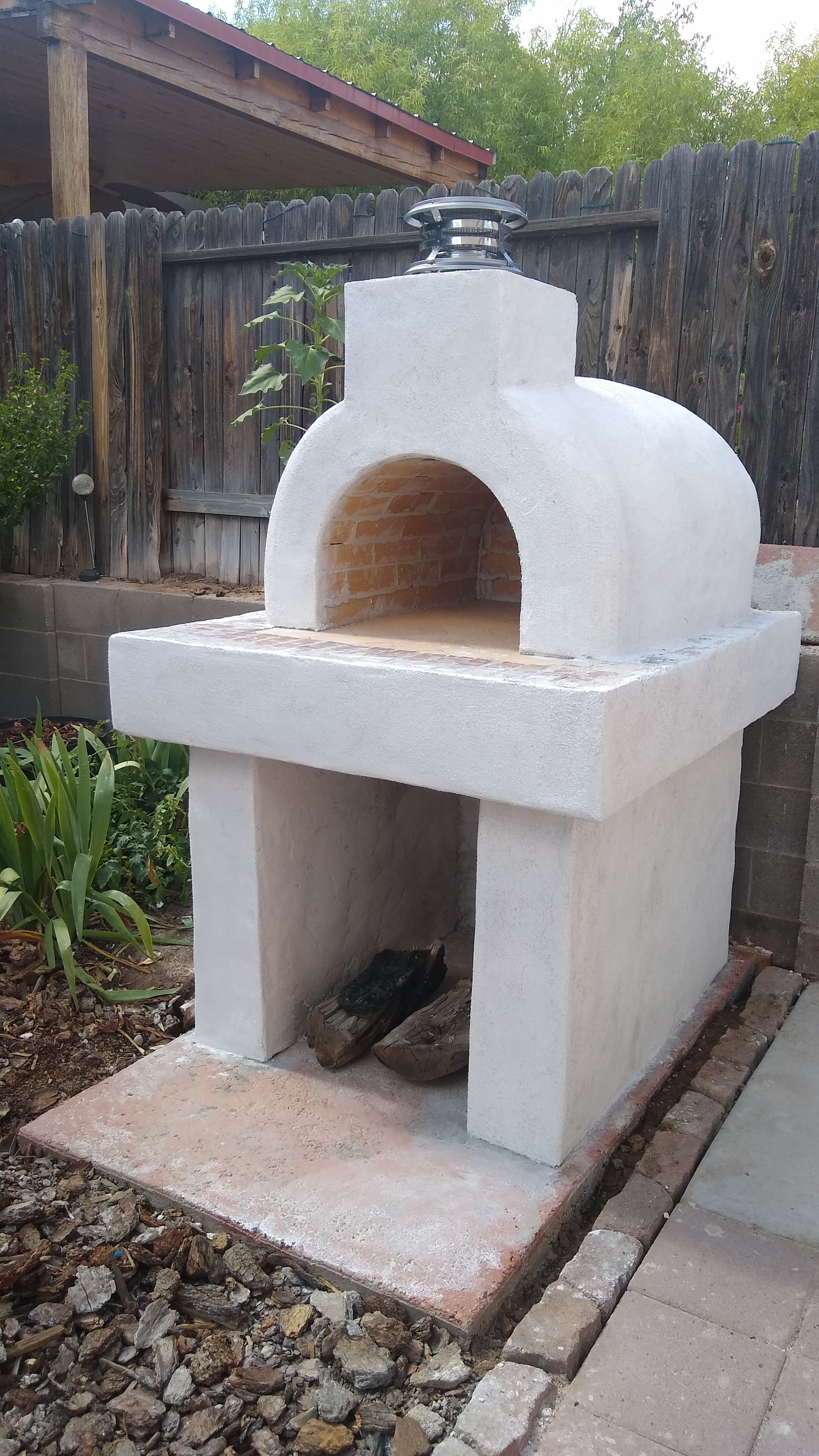

It took a bit. I did it more or less alone. With minimum masonry skill. I think some of the tools I had really helped. And one or two slowed it down.

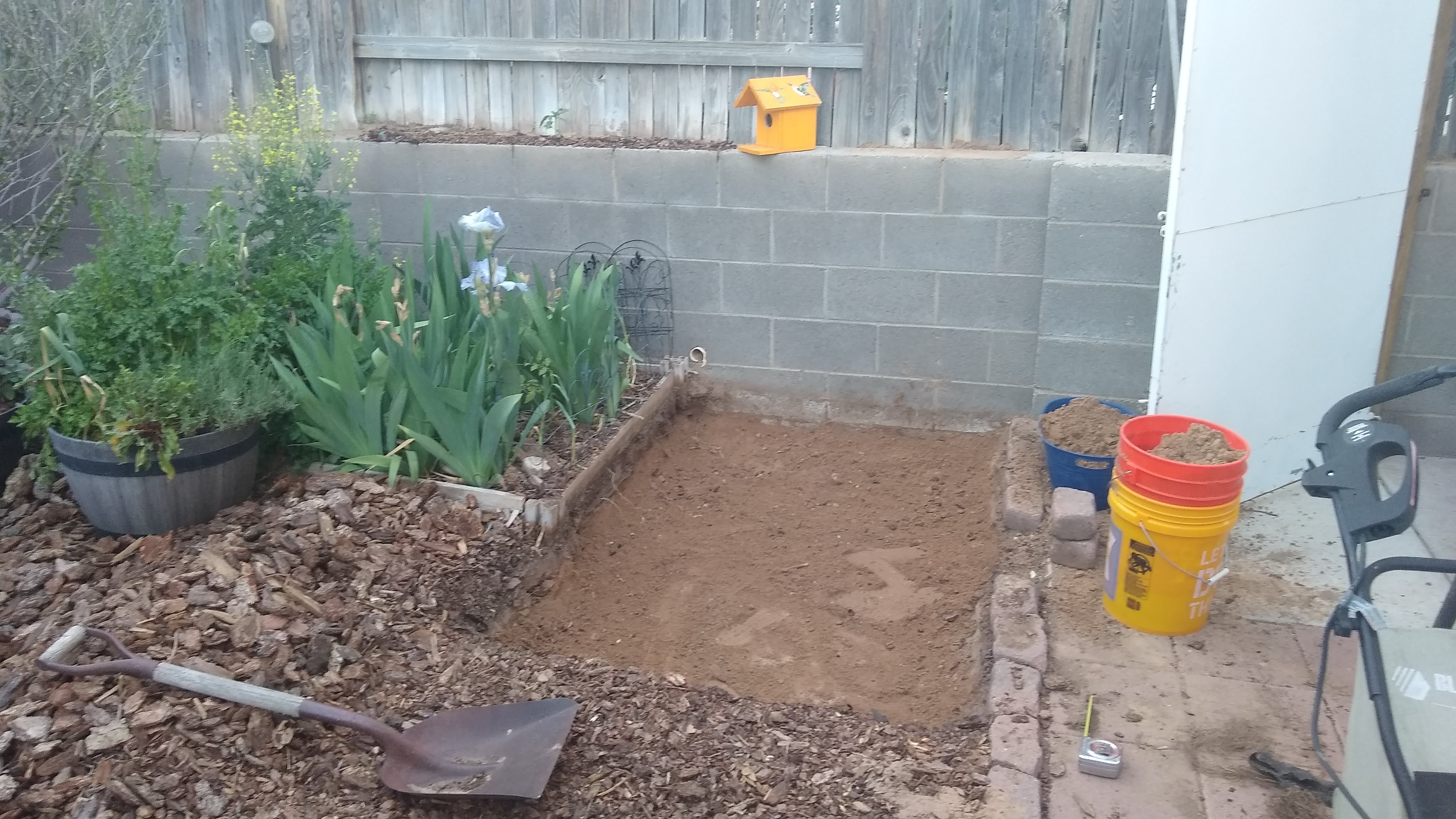

Some factors that slowed me down may not be an issue for you. It took me a day to dig the hole for the slab and to pour the slab. I spent an hour and a half the day before prepping and planning that out. The biggest issue was I had to cut a bunch of tree roots as I dug.
It took another day to cut the rebar and to build the concrete block frame and pour the concrete.
A couple of hours to pour the slabs that go on top of that frame. 40 minutes and about eighty dollars to pay the neighborhood highschool football players to put those on top of the frame. Best spent money ever.
About an hour to mix vermiculite concrete mix and get that into the void. Two to two and a half hours to do the standard bricks around the edges.
The herringbone floor was the hardest thing for me. I just could not get it level because it was so damp. It turned out that my neighbor had a busted sprinkler head that was shooting over the fence in the morning. I think a reasonable time for me absent those setbacks would be four hours. I won’t disclose the number of hours I spent trying to dry and level the nonzen garden.
Eleven hours in July in Texas to do the arch (it was in the hundreds so had to take a lot of breaks) six hours to do the back wall of fire brick (several breaks because was still July). I spent two hours organizing and planning the day before.
The chimney was difficult to cut but only about an hour to get it in place once cut. Angle grinder helped with the first level of the chimney and a masonry blade for my circular saw made the chimney indentations at the top go easily.
About four hours for stucco and insulation. I’d say but for playing in the sand, about fifty to fiftyfive hours. I had a very small concrete mixer which helped immensely as did a 1/4 in pointing trowel especially getting those mortar joints into the bricks in the arch. I would also buy a 3/8 in one for doing the standard brick frame.
10 in single bevel miter saw slowed progress. I had to do multiple passes in the herringbone bricks and free hand the final cut. Twelve in dual bevel miter saw would have been a game changer. I would have been able to cut some of the bricks for the first level of the chimney and one pass on the herringbone angles.
I think you could shave another 5 hours off of that if I had done this in September or October. I wanted pizza and have no regrets. Setting up scaffolding would save a lot of time too but was cost prohibitive.
I enjoyed it very much. Not as much as soppressata and candied jalapeno pizza but one has to come first

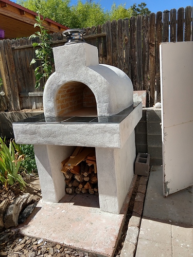

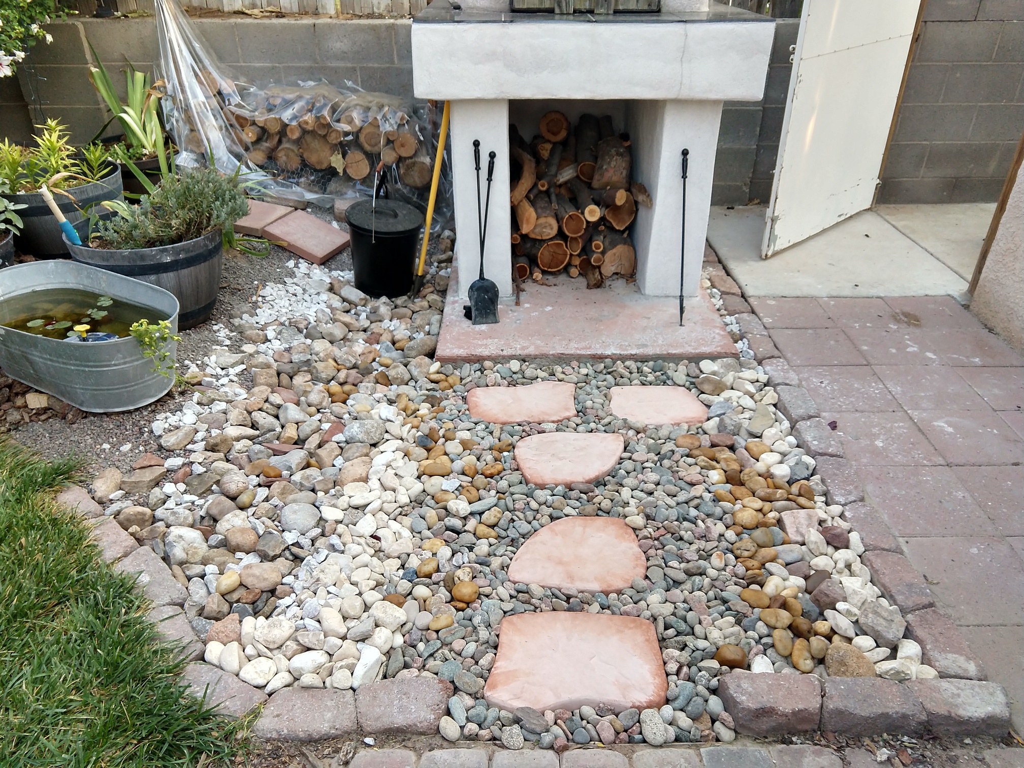

Wish I could help here, the stopping, starting, curing and “I’m taking this weekend off” makes it impossible for me to calculate the hours. Also, probably half the time was trips to home depot for mortar, tools and scouring the town for fireclay, firebricks and things that were tough to locate.
Taking a few weekends off and going at a nice hobbyist pace probably didn’t help either. Not to mention the customizations(custom arch shape, granite counter-top, stucco’d entire outside,zero-scaping)…all-in-all front to back the project took about 2 1/2 months of Saturdays…if not more LOLz!!

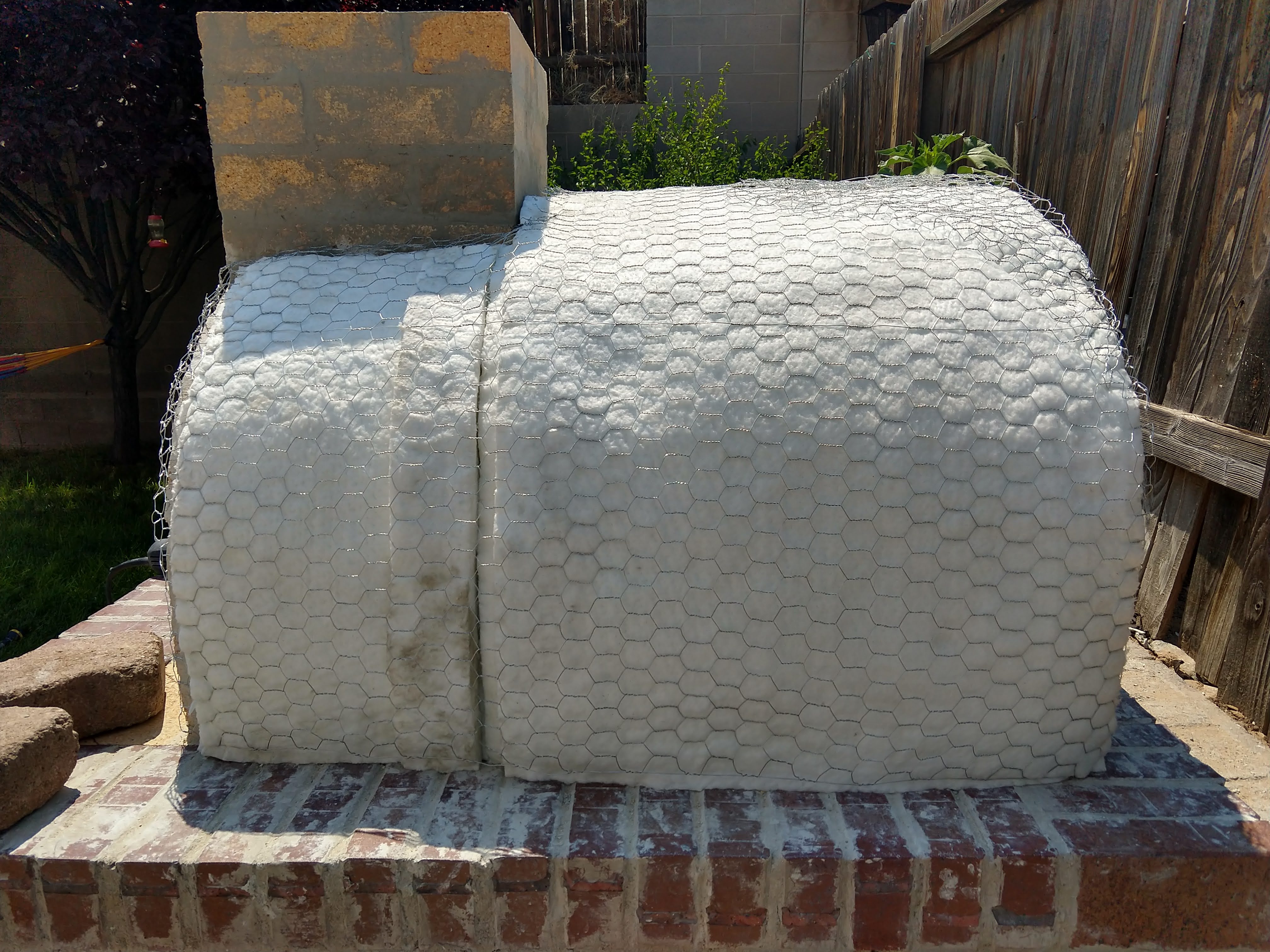

Update on where I am at…Placed the form 15 minutes (kept the chimney part off) Day 1 - 3 hours mixing mortar and and laying the 4 rows of bricks on each side. I found it easy to wear gloves and use a 10 quart paint bucket from the big box store. For measuring I use 3 solo cups of sand, and 1 solo cup of each (clay, portland, and lime). Mix it all in the bucket buy hand (wearing nitrite gloves) and then dump in a big black mixing tub. I then mix a second batch and leave it in the 10 quart bucket without water! I am too slow so the mortar starts setting up if I try to mix larger quantities. About 2-3 hours to get both sides to 4 rows. I also keep my bricks soaking but found that they need to be out for 5-10 minutes before adding mortar or the mortar slides off. The next couple of rows took tons of mortar and the top last row is difficult because you have to mortar both sides. I just shoved mortar in the cracks and used the a thin piece of metal about double the length of a Popsicle stick 3 hours. About 2 hours on the back wall as well. Overall the form was straight forward and no issues. I will be adding the blanket this week…Pizza’s in October!!! The entire oven and brickwork took less then 7 hours. This included cutting the 10 bricks in half to start (used a 19 dollar 10 inch miter saw blade from Amazon), and cutting the bricks for the backwall, and mixing all the mortar. The chimney part was tough because I have a 4 inch angle grinder…a larger angle grinder would save alot of time. The oven itself was definitely less time consuming then doing veneer work!
Sounds like you’re doing great, Chris! Overall your experience sounds like it’s on par for this particular course. The mortar in particular sounds sooo familiar—I recall having to throw out a few handfuls of it that I could no longer use because I’d mixed too much. It really hurt to do that!
You are definitely on your way.

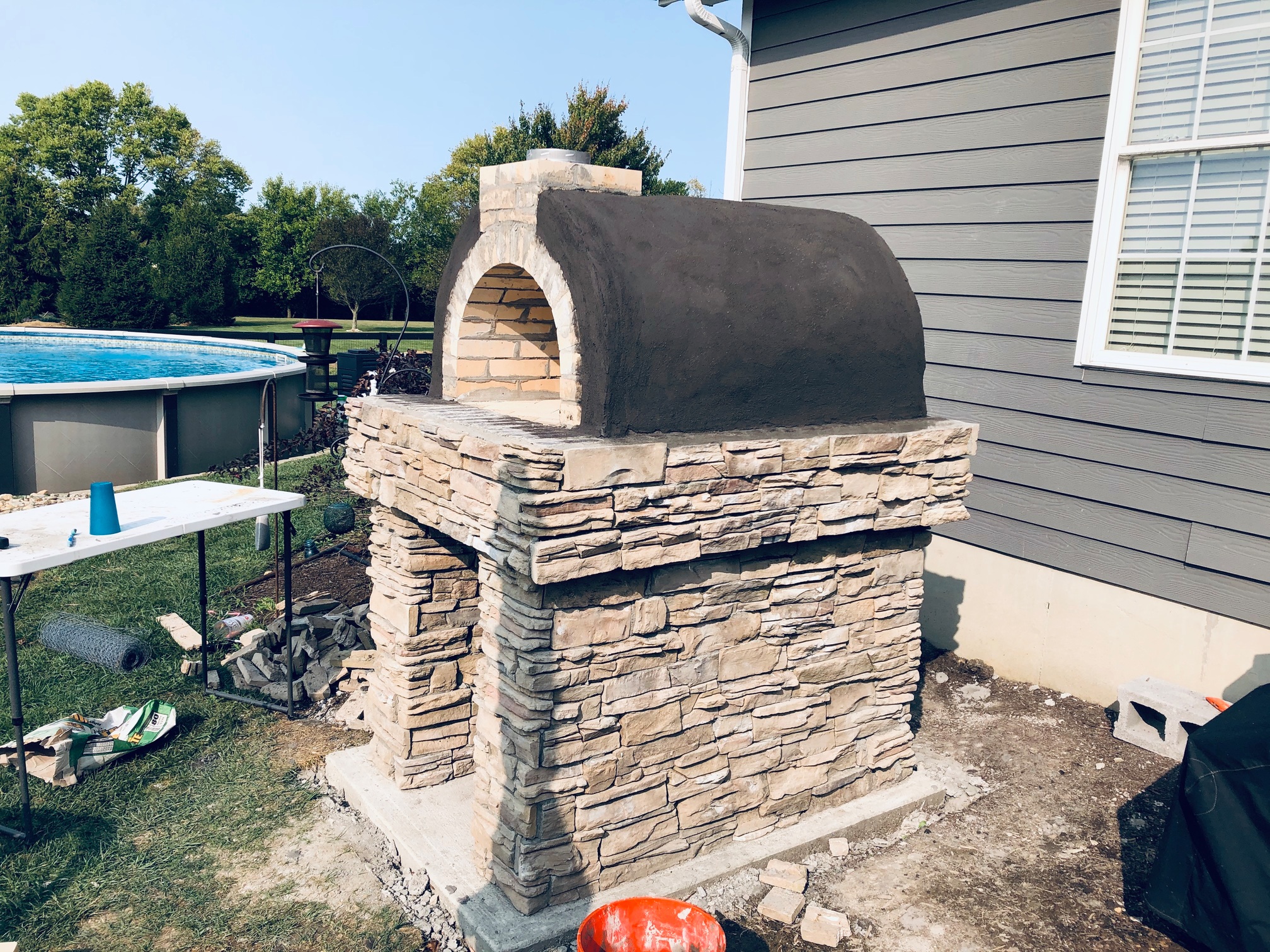

Looking good, final render with type S on today with quickrete black additive. Due to covid brick veneer is 4 plus weeks on delivery
That looks awesome. Stone veneer is a great look.
