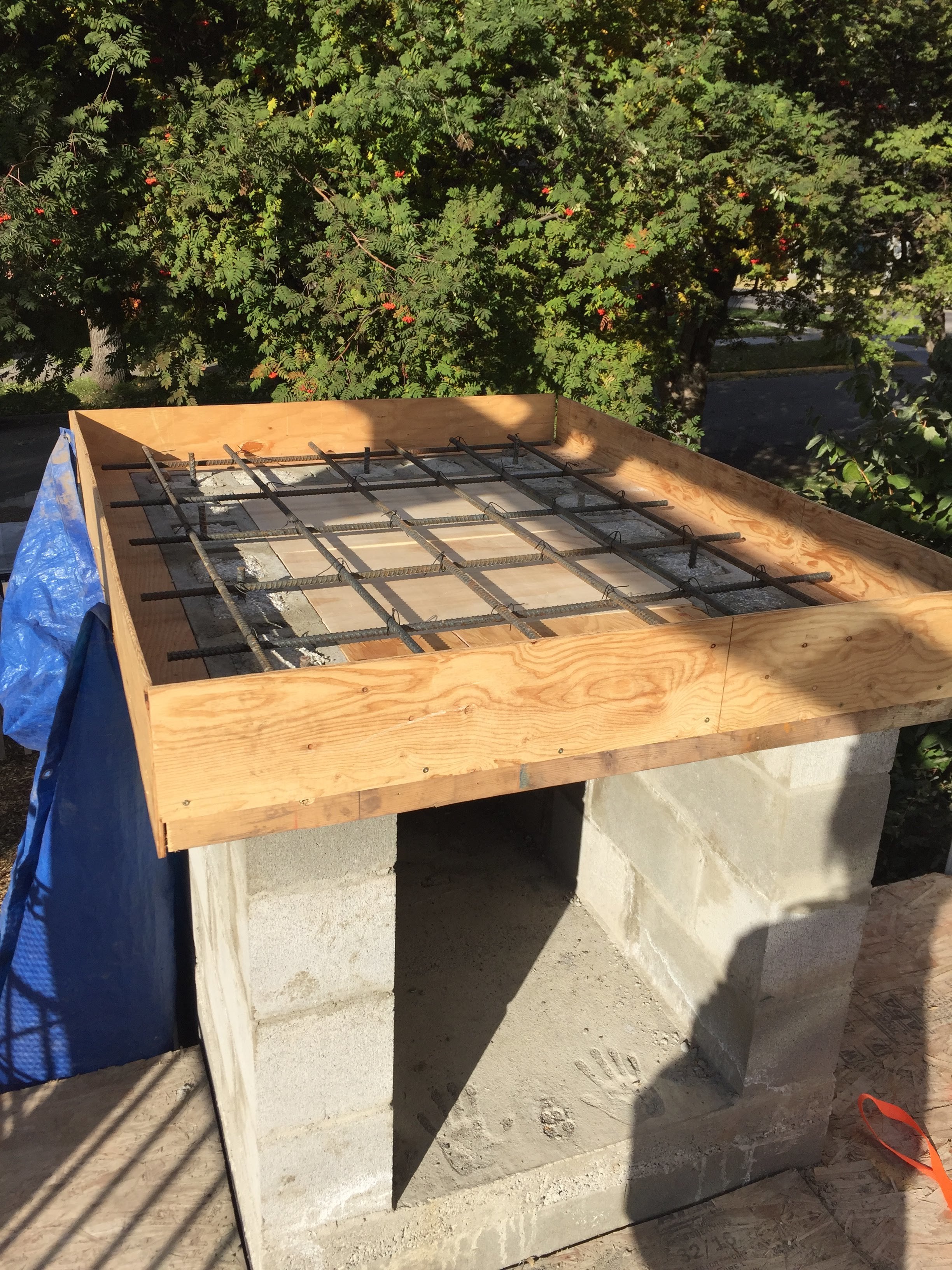

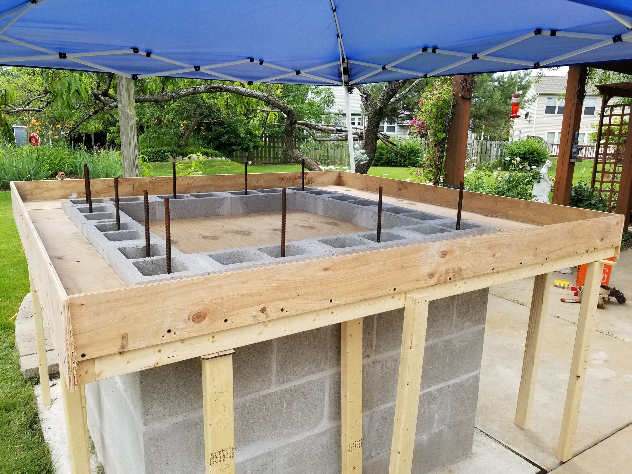

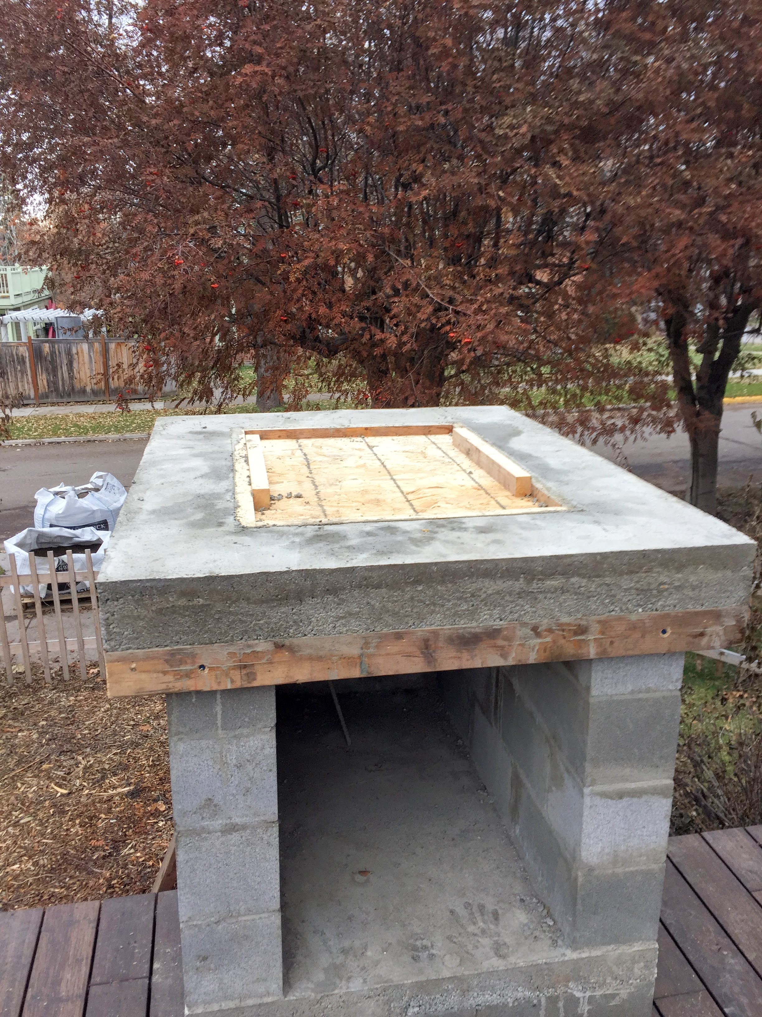

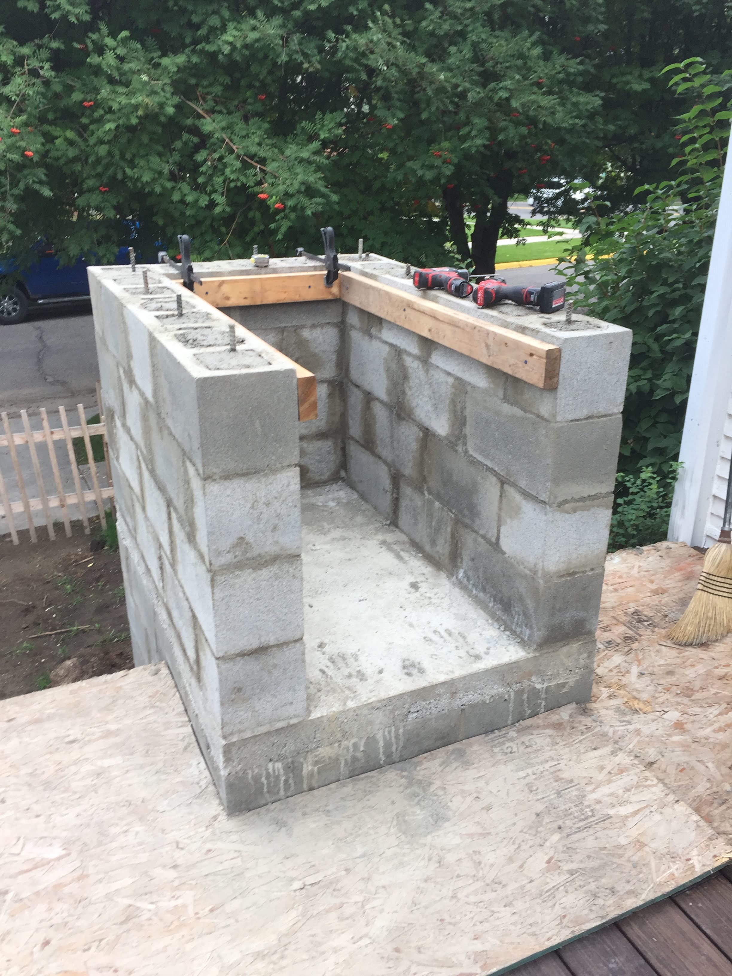

It seemed easier to me to pour the base in place. Especially since my oven is integrated into a raised deck. I have a few pictures that are attached.
- I affixed lumber to the inside and outside of the base using concrete screws.
- Inside the base, I added some plywood to hold the concrete in place from below
- Outside the base, I used 4x4s and then used some vertical plywood to hold in the concrete.
- I built a form the size of the indentation. I poured the concrete until it was at the correct height to place the indentation form. Then I placed the form over the concrete and fixed it in place to the sides of the form (not shown). Then I poured the rest of the concrete. (That was done as one pour so I didn’t have any cold joints.)
If I did it again, I would have used thicker plywood for the sides. The 1/4" stuff I had laying around bowed a very small amount. Oops. Probably no one but me will notice.

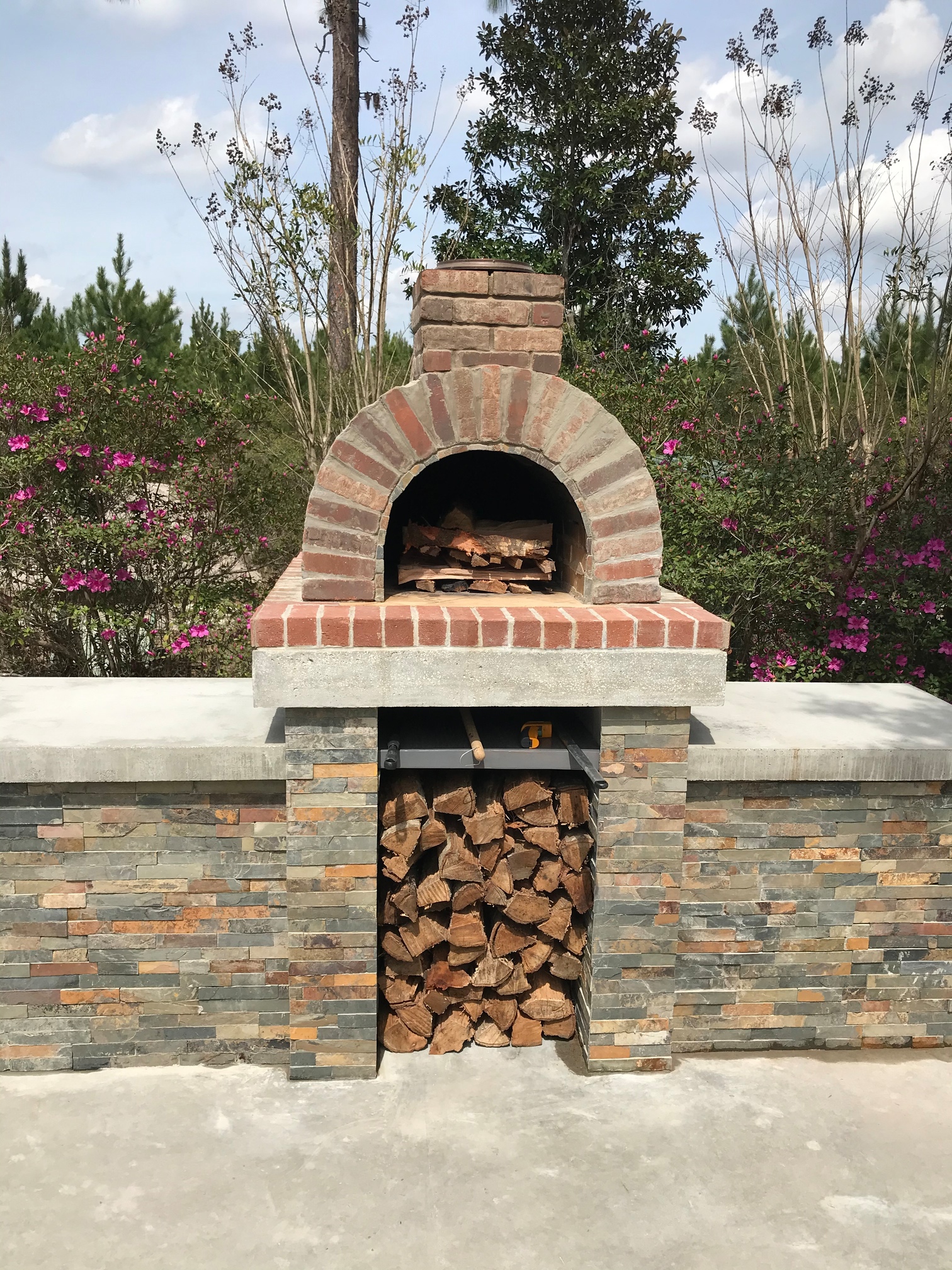

Love how you did this! Could you provide any other detail on how you built the counter space?
Thanks for the review. What I did was lay block just as I did for the oven, but only went 3 high. Instead of the front open, as on the oven base where I stack wood, the back is open on side counters. It gives a little more storage space for other items if needed. I put a stone veneer over the block which dressed it up on the sides. I then poured the tops only 3 1/2 in. thick using rebar just as I did in the oven base. I used a very smooth laminate board so my top is really smooth. Another suggestion is I sprayed olive oil non stick cooking spray inside the form which really helped from sticking. I used the same procedure on my foam form of the oven and it slid right out, and believe it or not, if I want to build another oven I could use the same foam form again. Hope this helps, thanks again.
