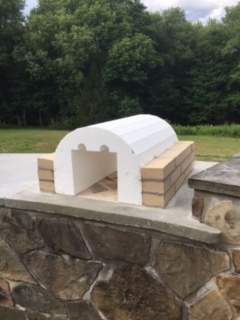

Day one of dome building and all is well! The tips and other experiences posted in this forum are invaluable. Since I much prefer mixing mortar and pretending to be a brick mason to wearing a mask in public, I plan to take this stage slowly and methodically, over a few days.
Based on what others have experienced and posted, and on my overthinking disease, I decided to lay three courses on each side of the mold to address the mold potentially moving. Everything went smoothly - thank God!
Again, based on the tips and experiences of others, I mixed small batches of mortar and still found myself getting nervous that the mortar was setting up toward the last brick or two.
My last observation to share is that I might swear that the area for placing the third course of bricks against the mold is not perpendicular to the floor but actually contains a slight angle, much less noticeable than the subsequent courses. I mention this only because I didn’t seem to come across this anywhere in the forum. Granted, the angle is slight, but the bricks fit better at a slight angle than flat, and it will certainly help the mortar joint for the fourth course.
Again, thanks to all who continue read and help! Today was energizing after the yips and anxiety subsided!
Good going, Bill! Just know you are in a large majority of folks who have never mixed mortar in their life, let alone laying two bricks together.
My mold is in pieces, of course, so I can’t swear to whether the third course angles, but you are the one on the ground, and as previously advised following the mold is your best course of action.

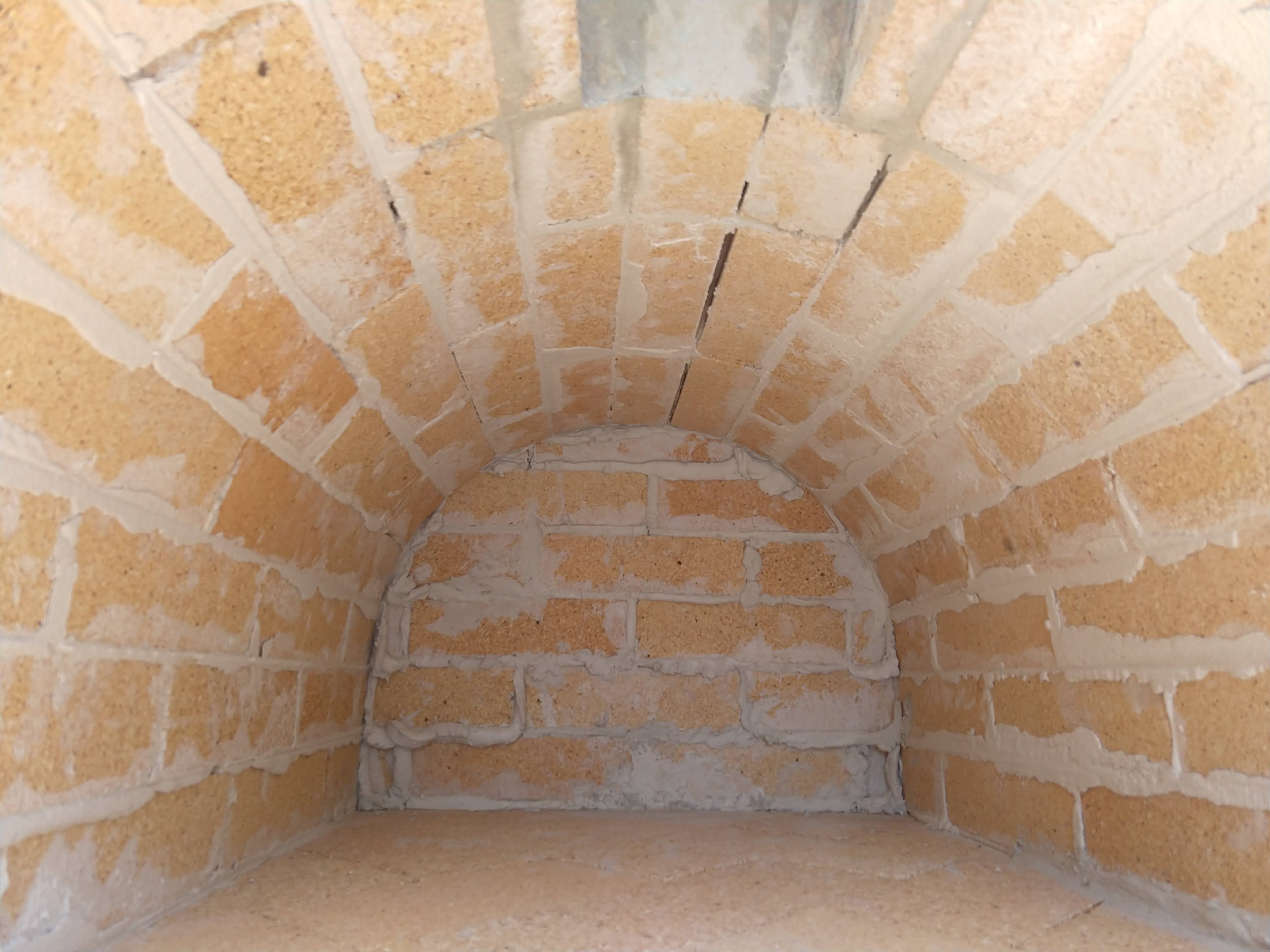

FWIW, I followed the mold pretty much exact. the only deviation was humand error. Once you get on the corner the mortar joints are thick, really thick! I had good luck buttering the brick I was laying down, and double buttering brick I was laying it on…I think in this way I got good coverage. It would always be a little high, then I would tamp it down a bit with a rubber mallet…then wipe away and compact joints at a the same time with a basic “patching trow”.
Thanks, Carlo! I am hoping the inside of my oven looks like that!
I just want good good and consistent joint fill and coverage.
