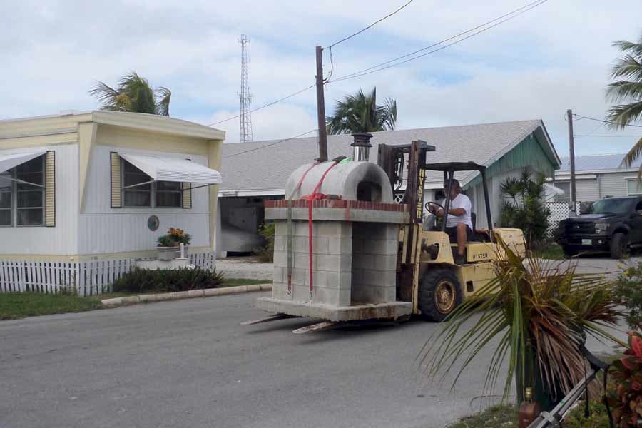

It your oven is a CORTILE BARILE or MATTONE CUPOLA, it can be done and it HAS been done!
Here’s a pic of the COTIE FAMILY Cortile Barile pizza oven moving from one house to another in my home state of Florida. If you click the image or the link below it, you will see several pics of the oven on the move…

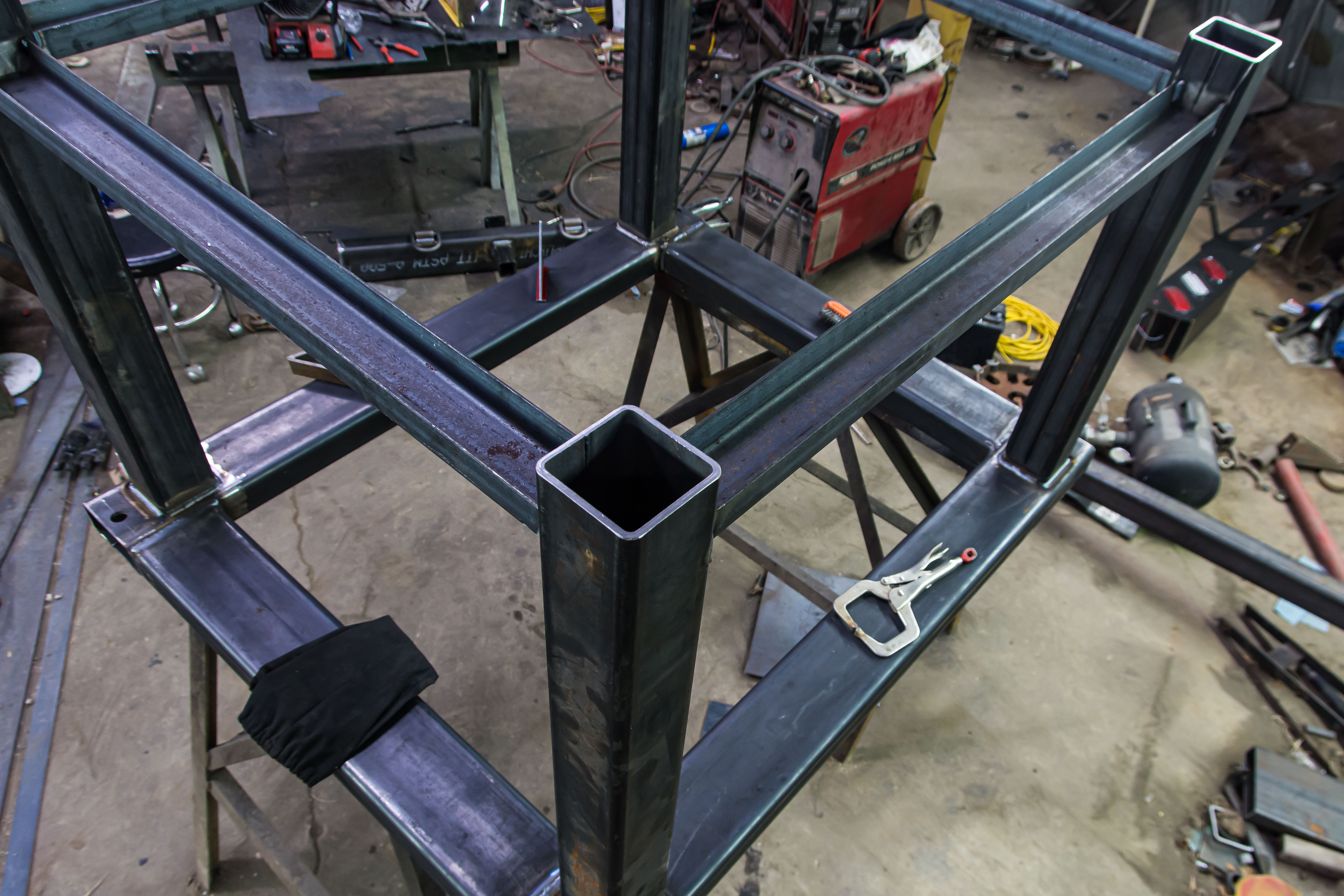

This is obviously too late for anybody with an already constructed oven, and perhaps I should make a new post of it for anybody who might be interested in the idea in the future. But my brother is a welding and fabricating whiz, so we decided that instead of a cinder block base we would make ours specifically so that it can be moved with a forklift or loader.
That is FANTASTIC! It looks like it can hold the weight of 5 ovens!
Do you have a rough list of materials used or perhaps the gauge of the metals?
We get a lot of requests for Metal Base Plans (obviously, it’s on the “To Do” list), but if you had any info / insight on your base, that could point several pizza oven base researchers in the right direction for metals.
Thx for sending and if you can add any more pics, we’d love to post them!
