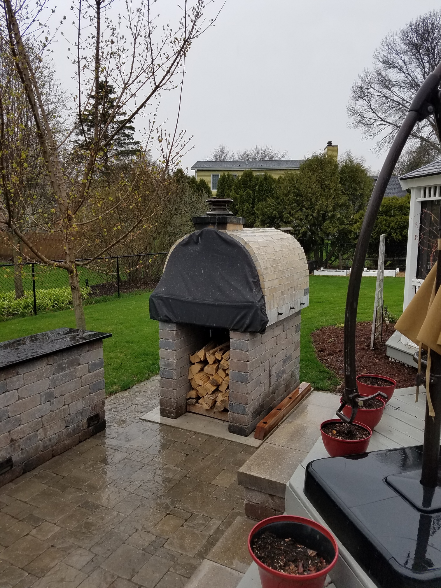

I had trouble getting the floor hot enough, and noticed moisture seaping through the joints under the base when firing the oven. I also noticed even with the metal door in place rain would find its way into the joint between the hearth and firebrick. My wife and I made this cover with Sunbrella fabric using a bungee cord through the hem and grommets that are hooked over screw heads underneath. It has rubber garage door gasket molding glued to the back where it touches the brick edges. It isn’t too pretty but after heavy rains I can take off the cover and the brick is completely dry. Now the floor gets up to 750+ without a problem and stays hot for the 5 pizzas others have talked about. I do move the coals from side to side if cooking more. If you can’t get the floor hot enough or keep it hot after moving the coals you may find the firebrick has moisture taking your heat away. Good luck.
