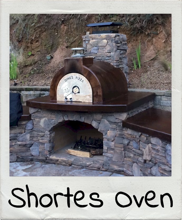

Just last month, I received several pictures from a customer that built their pizza oven directly over a fireplace - and it looks great! Functionally - I’m not sure how well it works (when they are both firing at the same time). And you are going to have to use CASTABLE REFRACTORY for the Fireplace ceiling / Pizza Oven base. Are you able to get 3" of Castable Refractory and 2" of insulation material (Perlite / Vermicuite & Portland) on top of the refractory slab?
Before we spend too much time on the topic - Is this the look are you are going for?
What is the dark brown finish of the oven and bar tops? what was the process? any feedback a year later on how the oven/fireplace combo is working?
