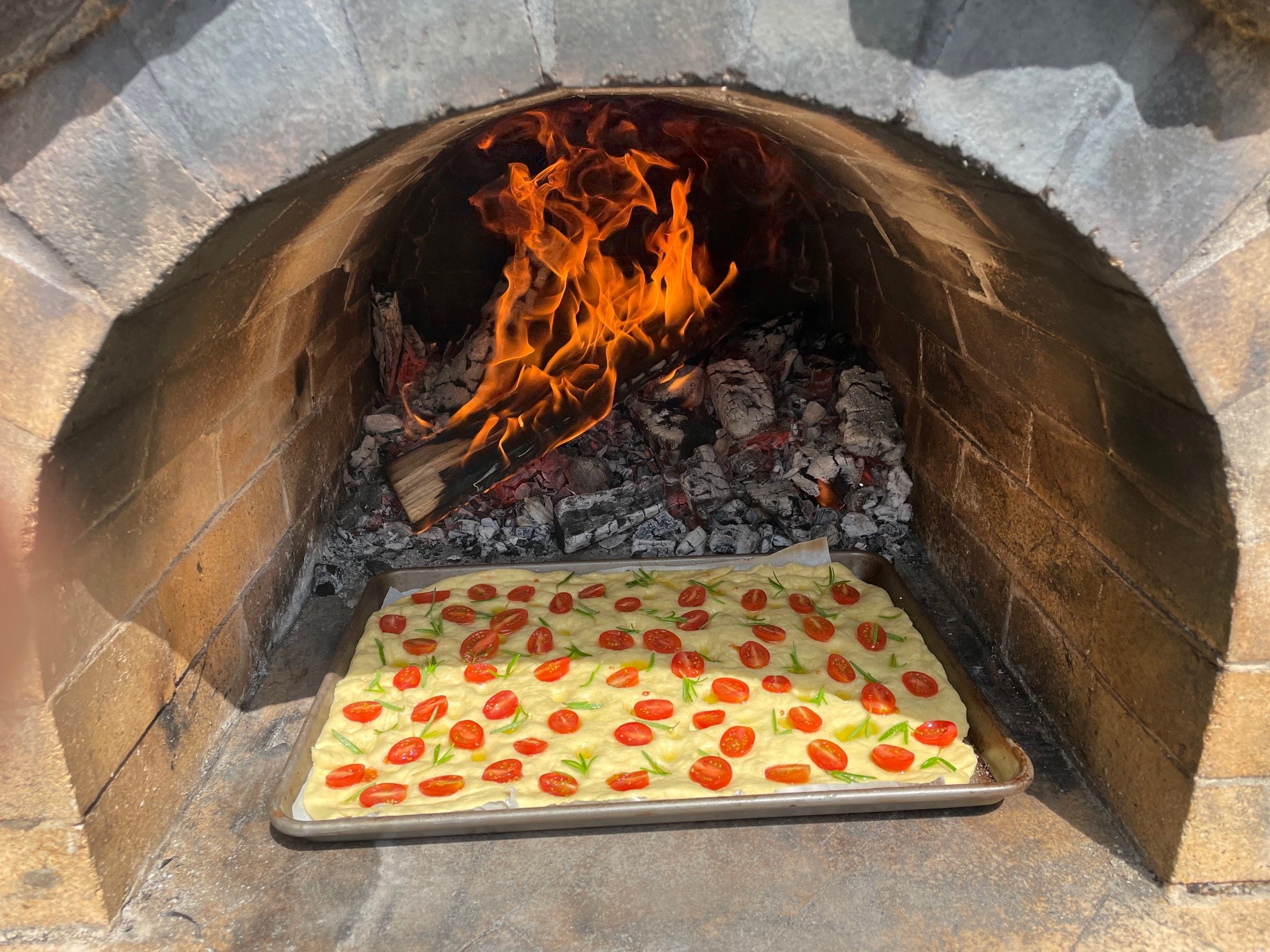

Never did that for pizza. Here is a picture of a focaccia bread that uses a similar technique though. (note: this one needed more rosemary)
Yes, I run the oven a bit cooler with a smaller fire, keep the pan near the front of the oven and rotate it a lot. I wouldn’t go hotter then 600. The cook time is longer, maybe 10-15 minutes because you need the slow heat to cook it through.
The picture is from when I first put it in the oven. I don’t have a picture of one that is cooked. It’s never lasted long enough for me to snap a pic…
