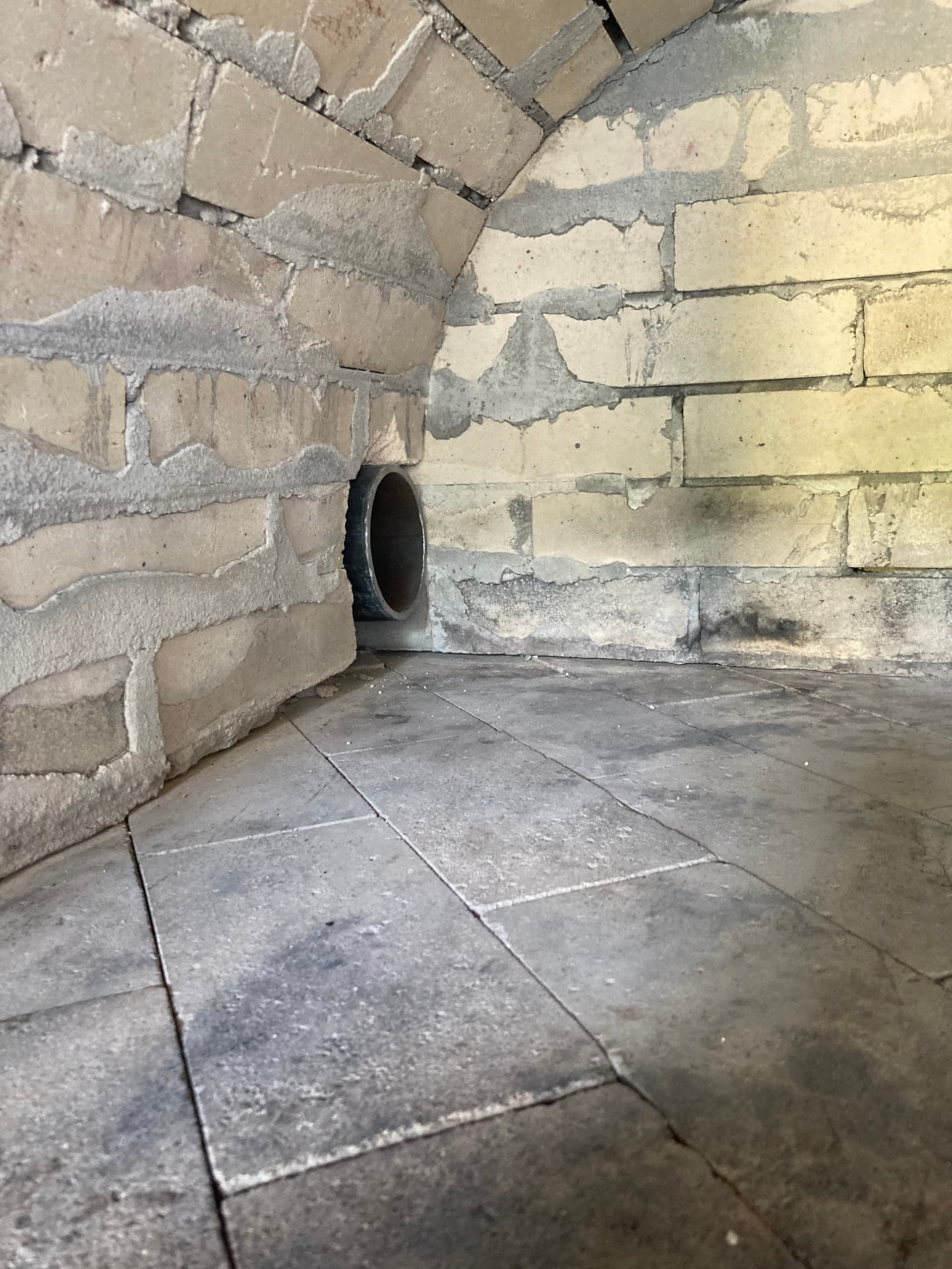

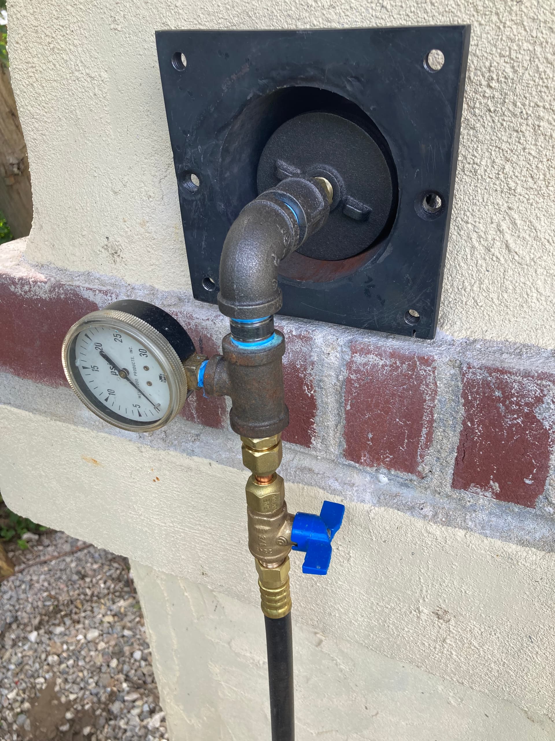

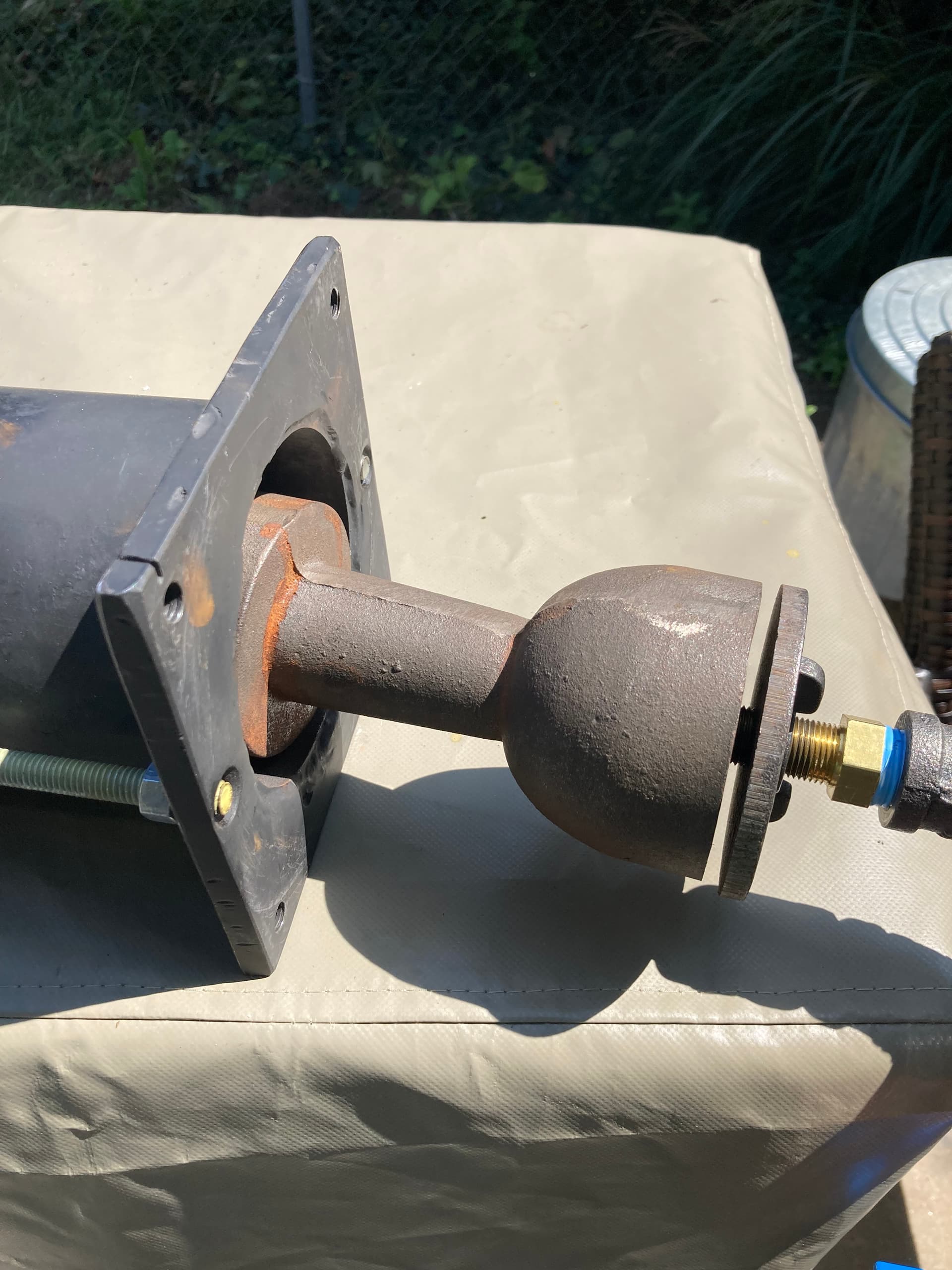

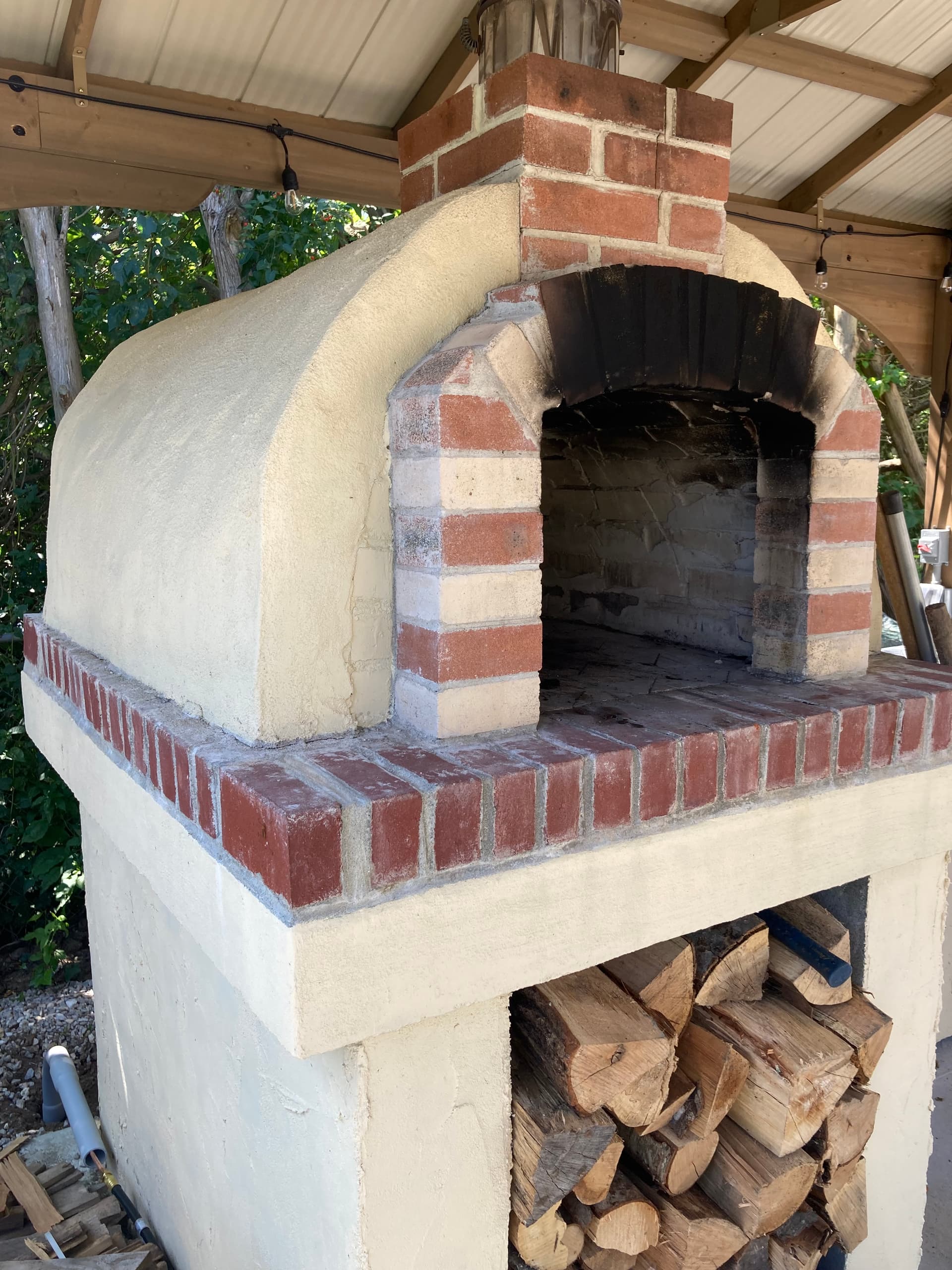

Following an example I saw here, this is my retro fit after the oven was built using a Ward burner. This works well alone or as a supplement to wood.

Just wondering if that Milwaukee tool you used to bore the hole is yours, or did you rent it? That would be helpful info for folks who are wondering how to punch a clean port into their oven.

The drill was just a hammer drill that penetrated the fire brick easily. I used a grinder with a masonry wheel to cut the stucco and chicken wire.
