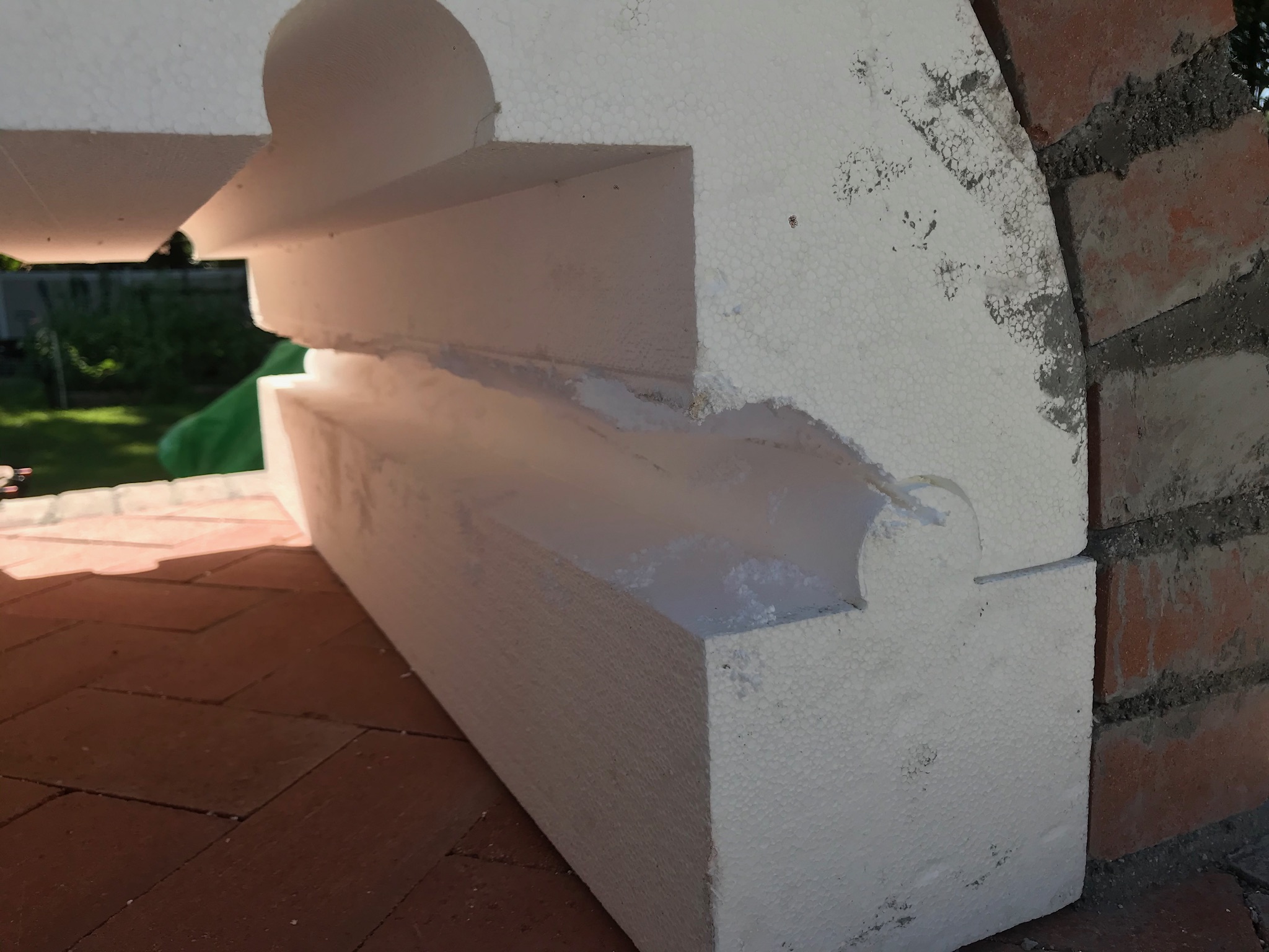

So, I tried something a little different. After finishing the barrel, but before building the back wall, I used my Sawzall to undercut the top mold over each of the legs, taking out just the inner half of the lip on the half-round.
I then proceeded to build my back wall and chimney base.
I pushed inward on one of the legs, and it slid out nicely from under the top piece. The other leg isn’t coming out as easily, but the top is now ready to come out — like a loose tooth.
