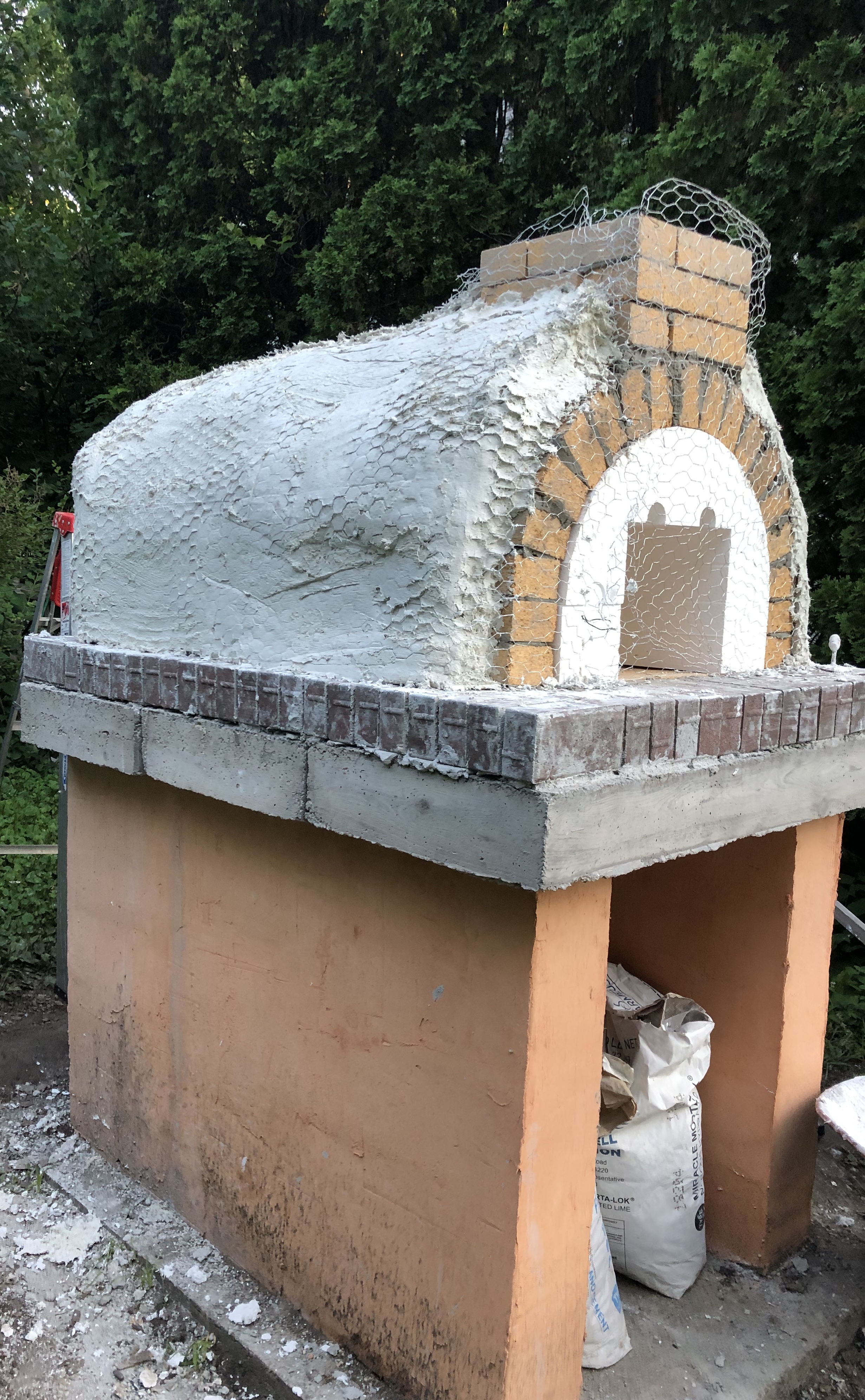

Thanks, all! We built the arch AND back yesterday and are hoping to get on the ceramic blanket and stucco in the next couple of days. Then it will have a good 10 days to cure. That should be enough, I hope, for the bricks to hold. We put a ton of Pam on the foam, but who knows if that will be enough to pull out the form, since we closed up the back. Otherwise, I guess we cut it out eventually.

So appreciate the good wishes! We got the first layer of stucco on yesterday, but I may have to trust my kid (and husband!) to get the second one on in a day or two after I’m laid up.
