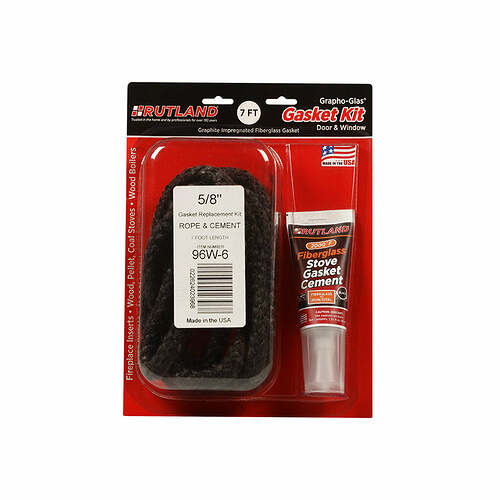

We recommend Grapho-Glass high-temp gasket rope, and they have some rope that is up to 7/8" thick!
