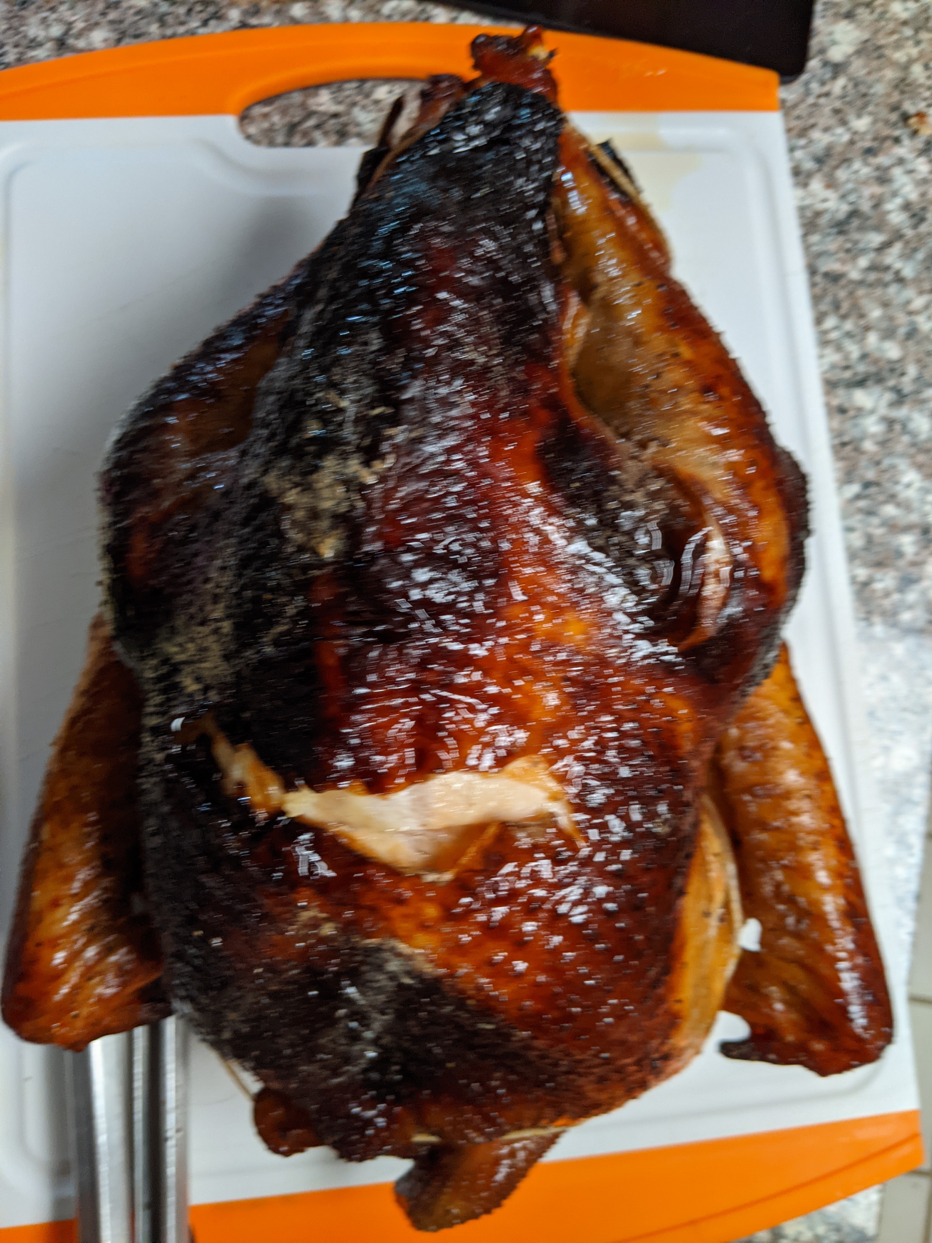

Turkey was a success. My favorite way to cook a turkey I’ve found. I think I’m out of ways to cook turkey. I learned some things. These are the things I would do different.
First, temperature was too high. I’ll shoot for 525 in the back and 500 in the front next year.
Second, 30-45 minutes was far too long per side. I checked after fifteen and the turkey got a little too dark. Tasted fine but I wanted a medium brown skin. I would check after ten minutes. I would spin the bird 180 degrees and cook for less time on the second side before tenting the bird. I did not anticipate getting as much color from the door side as I did. I would do ten minutes on the first side and seven on the second.
Third, I would get a bigger turkey. Normally, we host a big Thanksgiving but didn’t because of the virus. It provided less wiggle room and I missed my target temp in the breasts by a few degrees. 9 lbs was too small. I pulled the turkey at 163 and it was moist but I know I can do better.
Fourth, I did not plan on flipping the turkey over but to get even color I needed to. I would start the bird upside down for a few minutes with tail towards the flame and spin it a 180 degrees for a few (shorter number than tail) number of minutes. Because I did it towards the end, I cracked the skin when I flipped it.
Fifth, I would put all of the sides in the oven when I pulled the turkey. I could have cooked everything with the residual heat but didn’t. That’s more a matter of diplomacy with the wife.
I think it’s a fine-looking outcome! Yeah, I get your point about being darker than you expected on one side, but as you say it’s a matter of expectations.
