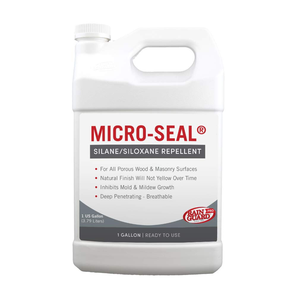

Thanks I’ll be applying a clear over brick. I also found this product that claims it absorbs and dries and does not change the appearance of the brick. I’ll have to read more about it.
Is the Micro-Seal an organic sealer?
I’m not insisting on an organic sealer to protect “Mother Earth”… I’m more concerned about protecting your ACTUAL mother! The only reason I “insist” on organic due to the toxic chemicals that are found in some masonry sealers.
And when sealers w/ toxic chemicals start to break down (when heated), they can put out some rancid fumes - that can put dear 'ol mom face down in the bowl of pizza sauce.
