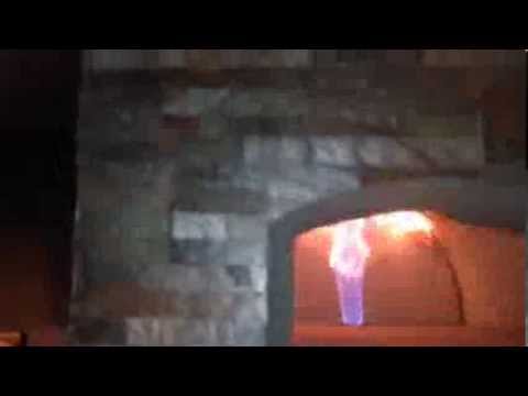

From what I know - and have seen from customers submitting images and videos -
It looks to go in the rear of the oven - right or left side. I’m right handed, so I tend to put everything on the right side of the oven… so I’m assuming I would want the burner on the LEFT side of the oven (so I never push food or even the metal peel into the burner and damage the burner).
Also - it would be easy to make an “L-shaped” S/Steel metal guard to sit in front of the burner (I’m sure they are on Ebay or Amazon)… but just some sort of guard that protects the burner while keeping ash out of the burner area.
A 4" hole w/ a 3" Burner - 1/2" of space on either side… sounds correct.
