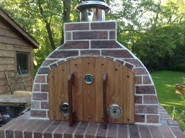

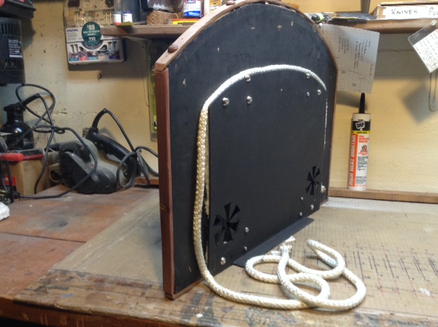

Here’s my solution (see photos…) I cut the original metal door to fit snugly in the oven portal…mounted on a slab of plywood (which fits up to - but outside - the oven; outside cedar boards, and re-used original door handles; also, I got a little crazy and installed air vents; I framed around the metal with oven rope, so it is a really snug fit. When I make my last pizza (mid-December, I will run a bead of window insulation around the perimeter of the door where it touches the brick. This door also acts to keep the smoke going up the chimney, instead of adding soot to the brick facade.

a few more photos…

That’s a great way to protect your oven interior, which is really what’s needed. A lot of work went into the doors, but I’ll also observe that your exterior shell is very well suited to protecting the contents. Wonderful build!
You might not be able to cook through a Chicago Winter, but you’re certainly kicking its butt on the “getting into your oven” front!
