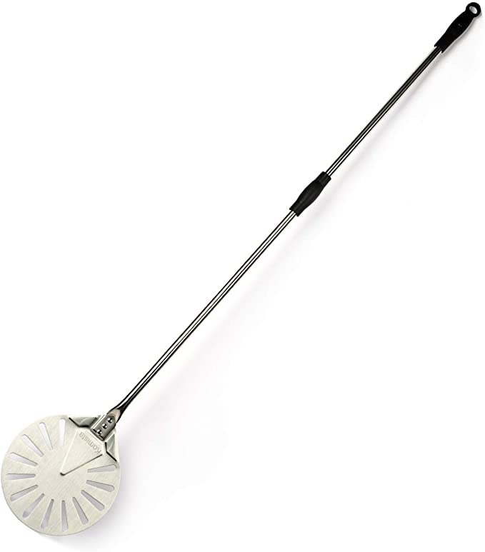

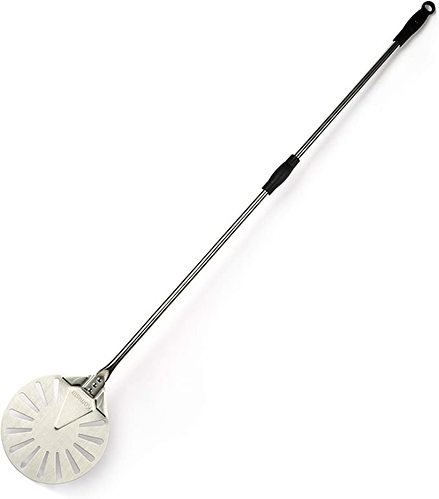

The other thing you must do when cooking front to back is to use a long-handled “banjo” peel to turn your pizzas while they are baking. All your radiant heat is coming from the back, so you have to dig in and involve yourself in making sure each part of the pizza gets its turn to bask. A long-handled peel currently runs for about $50 on Amazon. This is the one I use, but the things to look for are a perforated pan, stainless steel fabrication, a very long handle, and a sliding grip.
This type of peel is just about useless for sliding your pies in and out of the oven, but it is priceless for rotating or turning items while they are baking. You can also use it for tending to your ember pile or shifting splits.
So, my last recommendation is to keep an eye on your baking pizzas, which are going to cook very quickly; and use the banjo peel to lift up each pizza and rotate it a quarter turn. About once a minute seems to work for me.
