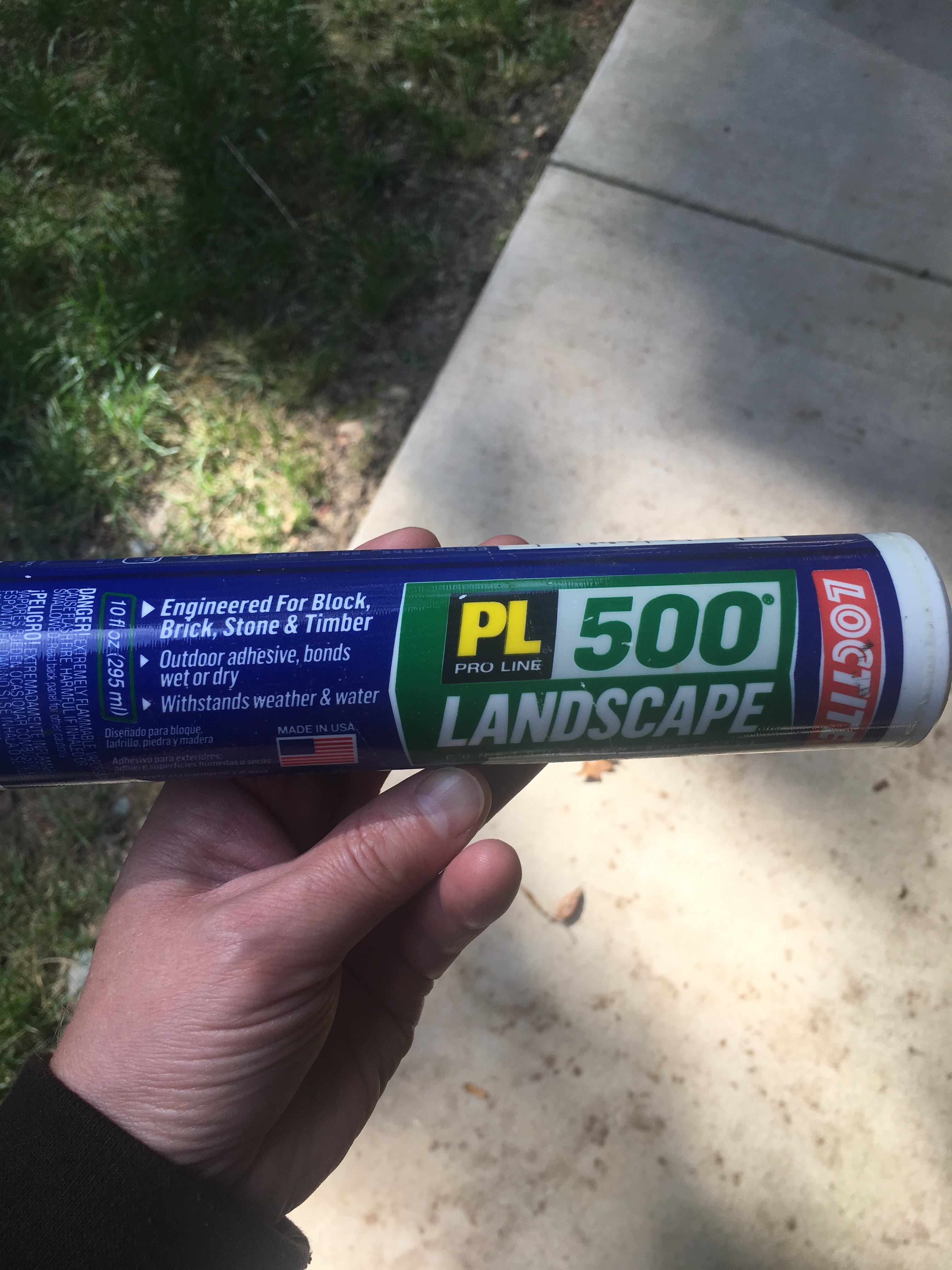

Thanks for this. Yes I have the two layers of stucco/mortar already applied. I was actually wondering if a glue would be better than Thinset for the long haul. The primary additive in Thinset is concrete and it might adhere better to the stucco mortar layer? Probably either/or scenario will work. Price-wise I think the Thinset would be a lot cheaper than glue. I’ve used glue on a fire pit for retaining wall block and it works great but we also went through a lot of it. Thanks again.
Edit: I have a similar glue product made for brick and stone and everything looks good until you look at the product warning. Wow what a nice brick oven, KaBoom!!!
That does sound ominous, Mark!
In my opinion it would only be a problem if you happen to be baking and setting your veneer at the same time. It’s the carrier solvents in the adhesive that give off flammable vapors. Once the adhesive cures, the solvents will have “gassed off” and the residue (your actual adhesive) becomes inert.
The particular product in the photo can be applied dry or wet, and is expected to perform in outdoor settings. The adhesive itself needs to be soluble in something besides water, which most often means a solvent that has flammable properties.
I agree with your general point:
Yes it would be unfortunate if one were baking and using that glue to set veneers. LOL I used the same glue for a fire pit and never experienced any explosions post drying. and that’s a good thing! Used the Thinset tonight and it worked like a champ. Adhered fast too. Thanks everyone.

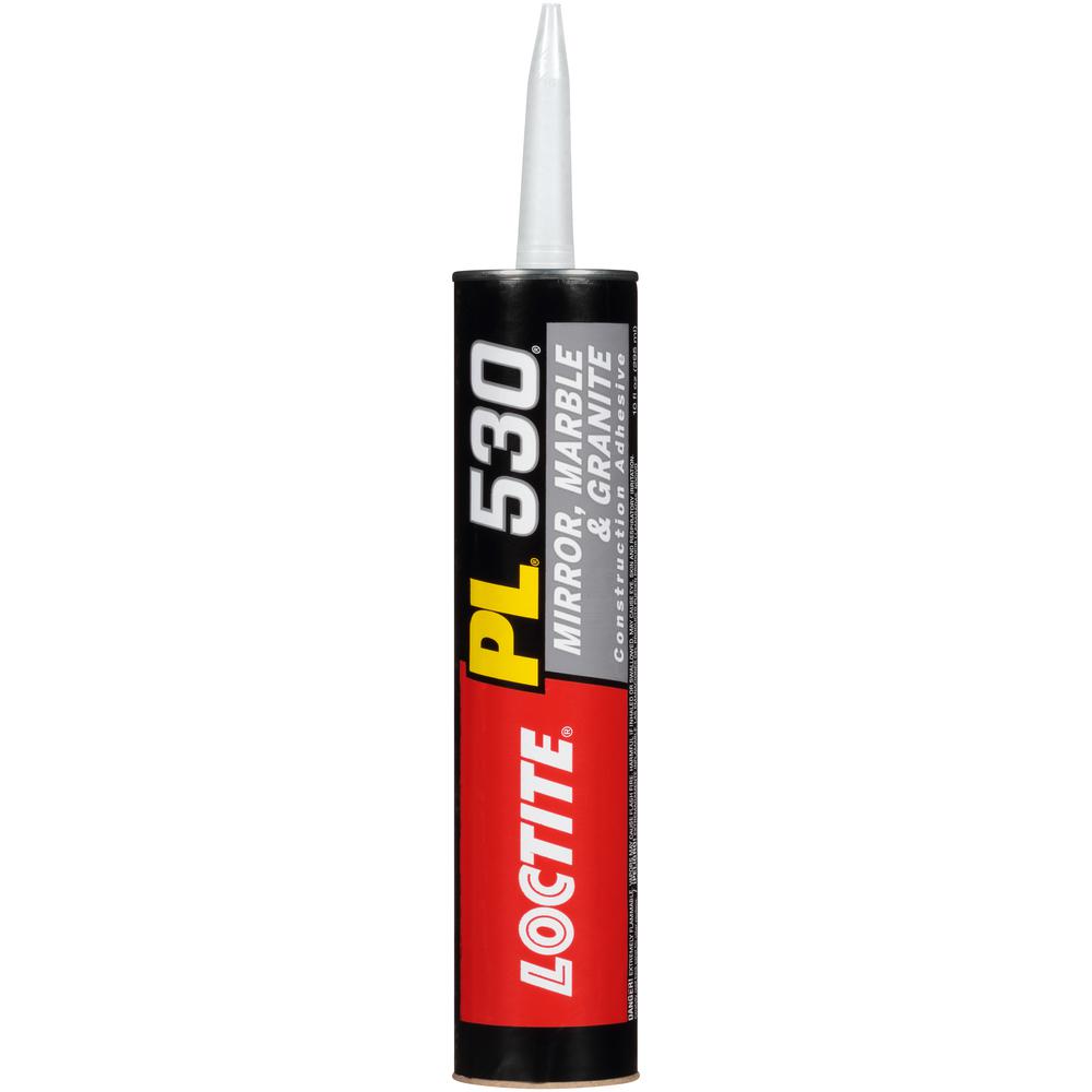

As usual, thanks again for the quick response. I have been looking at the following adhesives. I have a half tube of both, the Rutland Fireplace Mortar and the Loctite PL530 Mirror, Marble and Granite Adhesive on hand.
Any choice between the two? I am nervous about the explosion warning on the granite adhesive…but I read your links above. Once it’s dry, it should be ok? The rutland product is made to take the heat…but will it adhere to the granite? Any thoughts? Dwayne
Hi Dwayne,
I would choose the granite adhesive. The Rutland product is meant to repair joints that take direct flame (refractory), thus the 2000 degree rating. It doesn’t completely cure until it has been fired, which is not your application. (You hope your facing is NEVER going to come into contact with direct flame!)
You spotted both the explosion warning and the note above. You are working outdoors in a well ventilated area. Once the explosive solvents evaporate, so does the hazard.
You might want to pick up the Rutland product and have it on hand. It’s really good for repairing minor cracks in your mortar—about a year into operation, when your oven has had a chance to settle.
