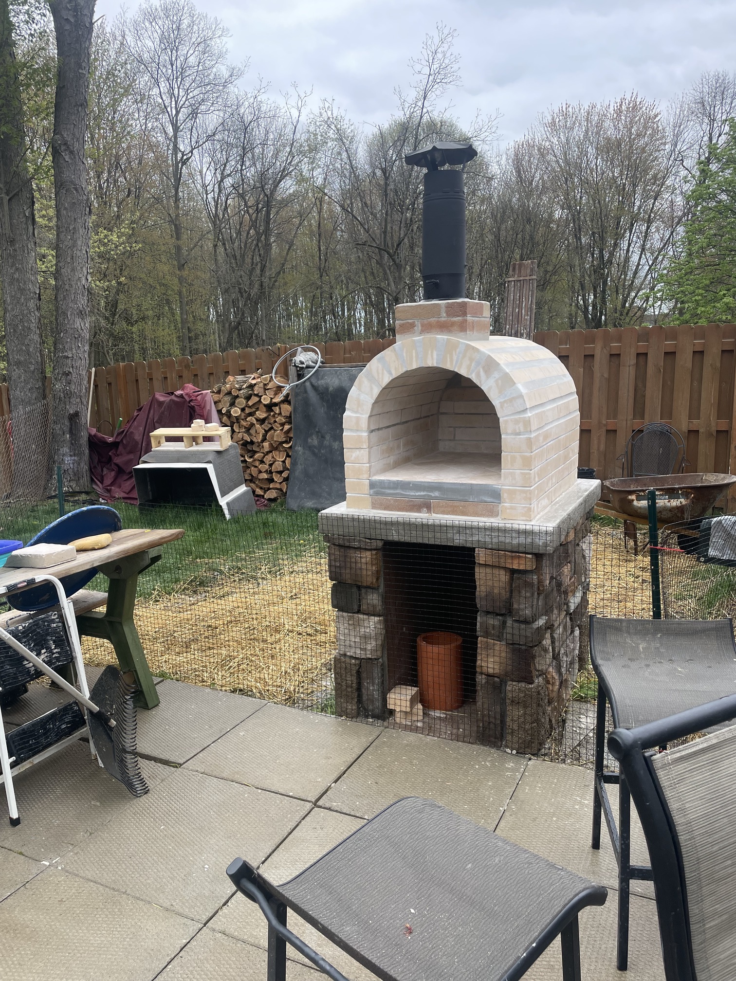

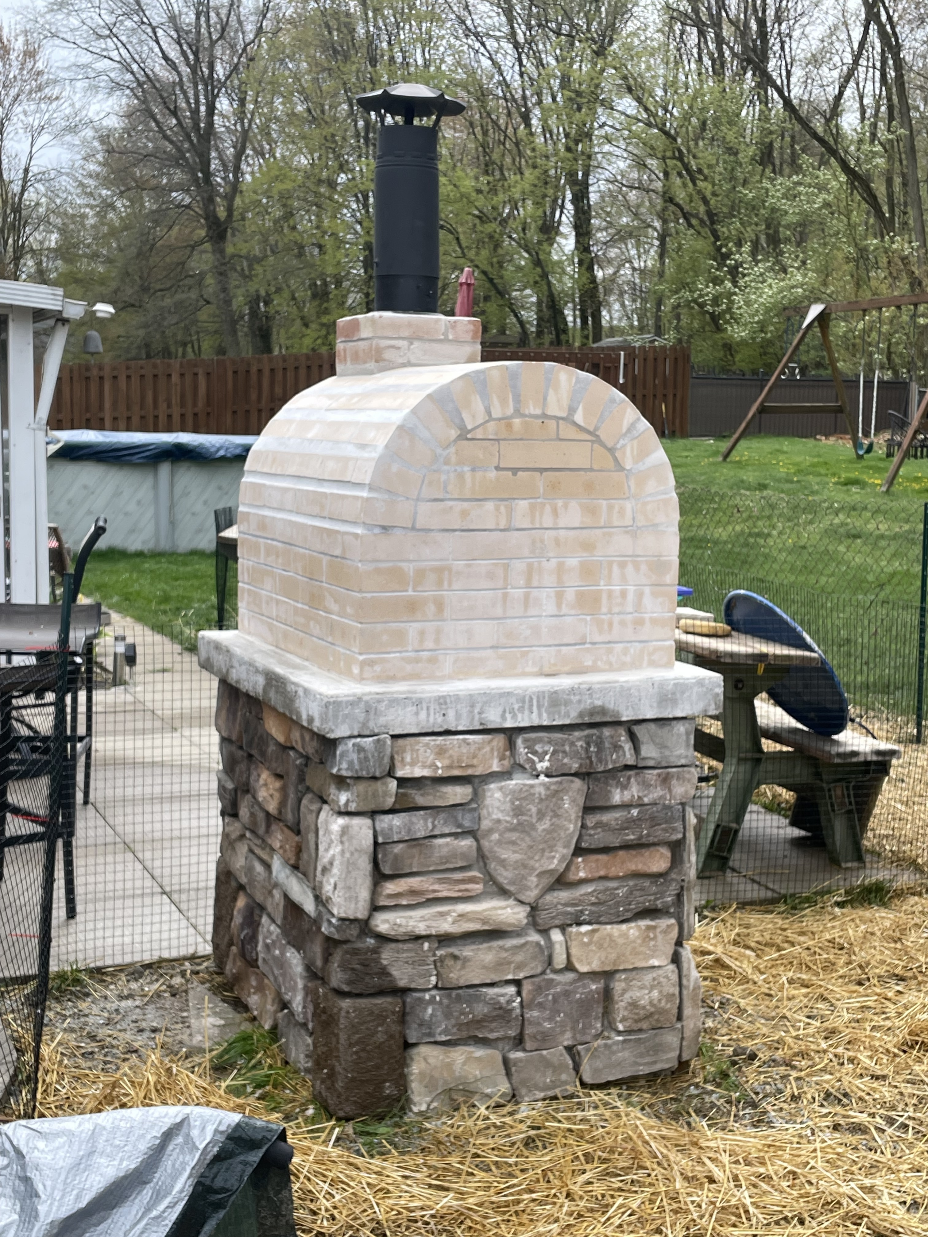

Hey guys , I’m at a stopping point ,
budget wise , my question is ceramic insulation or substitute brick ?
Can I fire cure and use as is keep covered when not in use

I would always go with mineral fiber insulation—for efficiency and relatively light weight. Brick will eventually do a similar job, but not as well and it will take more time to get your oven up to cooking temperature. It will also cost a lot less. Only you can decide which is more important to you.
The balance for me would be how much work, materials, and time I’ve put into the oven build up to this point. I want it to perform at its peak. We get enough frigid weather here that I applied a double layer of mineral fiber, and it works like a champ. To me, that justifies all the work I did on the site and all the materials I hauled in by hand. It almost justifies the day I rented a jackhammer to extract an absurdly well anchored clothesline pole from the site. ![]()
As for firing: if you want to fire it in this state, stop just a minute! Make sure you water-seal the outer shell and chimney before you fire it for the first time. Do that even if you plan to cover it between uses. You’ll have to do that again once your final outer shell is in place (no matter what you decide about which kind), but you will be beholden to the weather and sudden storms unless you do this step now.
You still need to do all the steps of the initial firing as outlined in the manual, and do not skip a single day of that. You accomplish two things there:
Hope all this helps. You’ve got a beauty of an oven on your hands there, and you want it to perform well over a period of years. Let us know what you decide!

I’m hoping that this advice is very clear, because the choices you make at this point are going to affect your long-term use of your beautiful oven. If you have further questions, please ask them now rather than moving ahead—you’re at a point where undoing a misstep involves sledgehammers, and I don’t want to see you have to do that!
Matt ,
Thanks for the swift response, constant needling from the peanut gallery was pressuring me , I’m holding off on insulating and a stucco finish for a later date , not going to fire it either. I’ll continue to air dry and cover when weather is t threatening. It’s a great thing to have you for advice, Thank you
