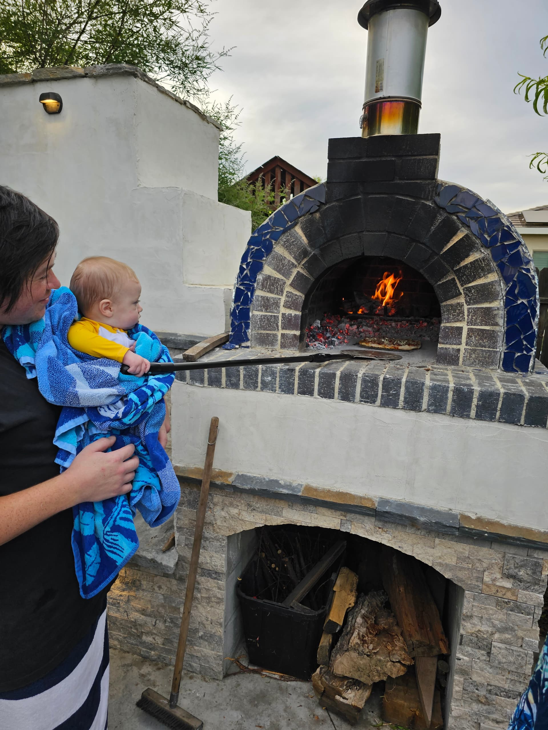

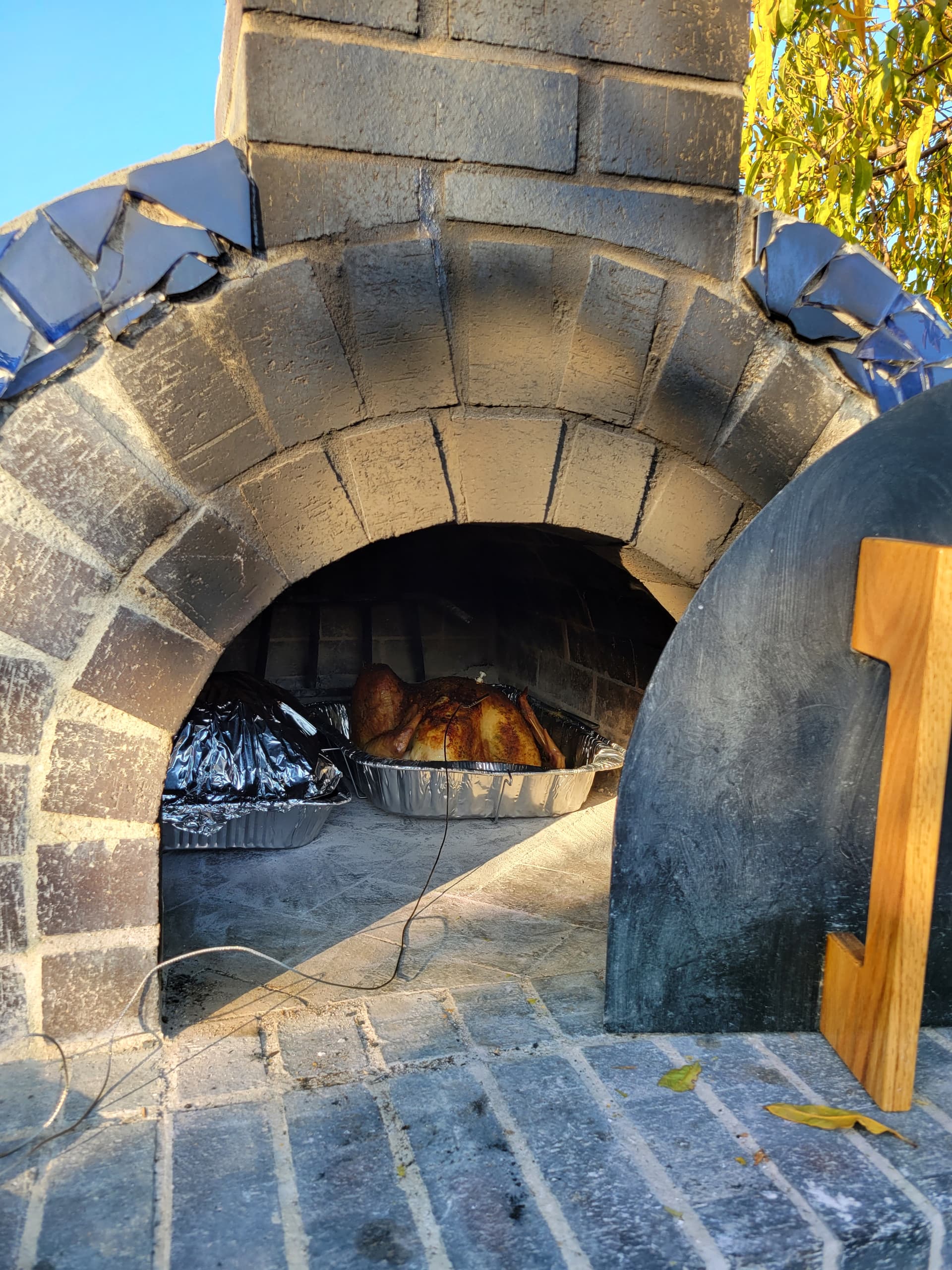

Well, it was the best turkey ever! Put it in at 425, left the door off and damper open to try to cool it down. Turned the pan every 10 min. Put the door back on at 375, continued to turn the bird. Took it out, let it rest. Took pictures of it in the oven, totally forgot to take some when it was out .
That turkey is a real “tease” in the back of the oven, and my (Pilgrim) hat is off to you, Norm! I hope these photos encourage others to try some of the extended capabilities already built into their BrickWoods. Thank you for sharing, and congratulations on a successful turkey roast.
