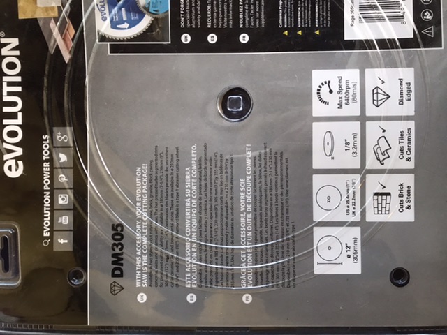

Hit a snag here fellas. Both my miter saw and grinder blades have stopped cutting after 4/5 cuts each. Both tools are equipped with continuous edge diamond stone blades. An I using the wrong blades? I thought the continuous edge were for hard stone and segmented edge were for softer materials like concrete. Anyone have a recommendation on a blade that will give me the 10/15 cuts I have left?
This is what i use on firebrick. It is segmented, and so far has cut through over 50 brick without any signs of wear.
Everyone’s technique is going to be different, but I will say that letting the blade do the work is especially important here. I do apply light pressure on the saw handle to make sure it doesn’t bounce back, and I’m rewarded with a cut that moves steadily through the piece “like butter.”
Hope this helps!
Following up to help anyone else who has the same experience. As is usually the case, this came down to inexperience with cutting masonry. I’ve cut plenty of cinderblock (and hundreds of wood & metal studs) and had no idea how long it takes to cut high density firebrick. @bikerbudmatt, when I saw your comment about resting your hands on the handle just to keep the blade from popping up, I realized I must be doing it wrong. Sure enough, I just wasn’t being patient. Cut all my remaining bricks today, but it took about 10 minutes to get through each brick. But they came out perfect. What threw me was the very first firebrick with a new blade. The blade went through the brick in about 10 seconds. So that was my benchmark. Once it broke in and refused to cut each brick thereafter that fast, I freaked out. Turns out you just need to give it time. So for everyone else out there, don’t expect to slice through these bricks like a wood stud! Thanks again Matt!
