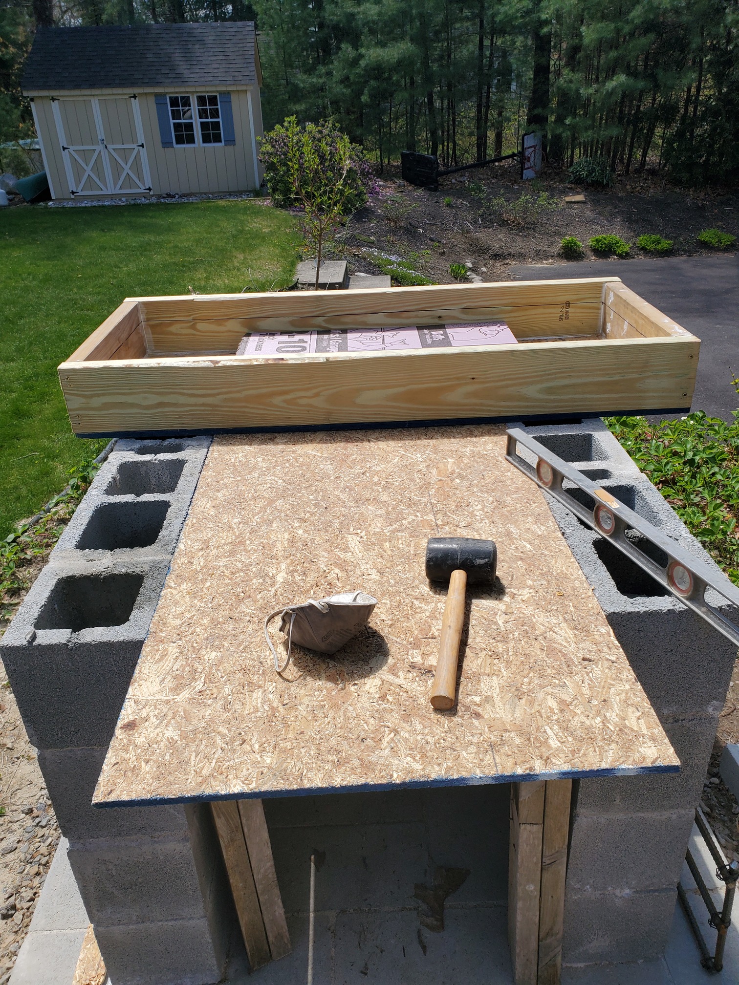

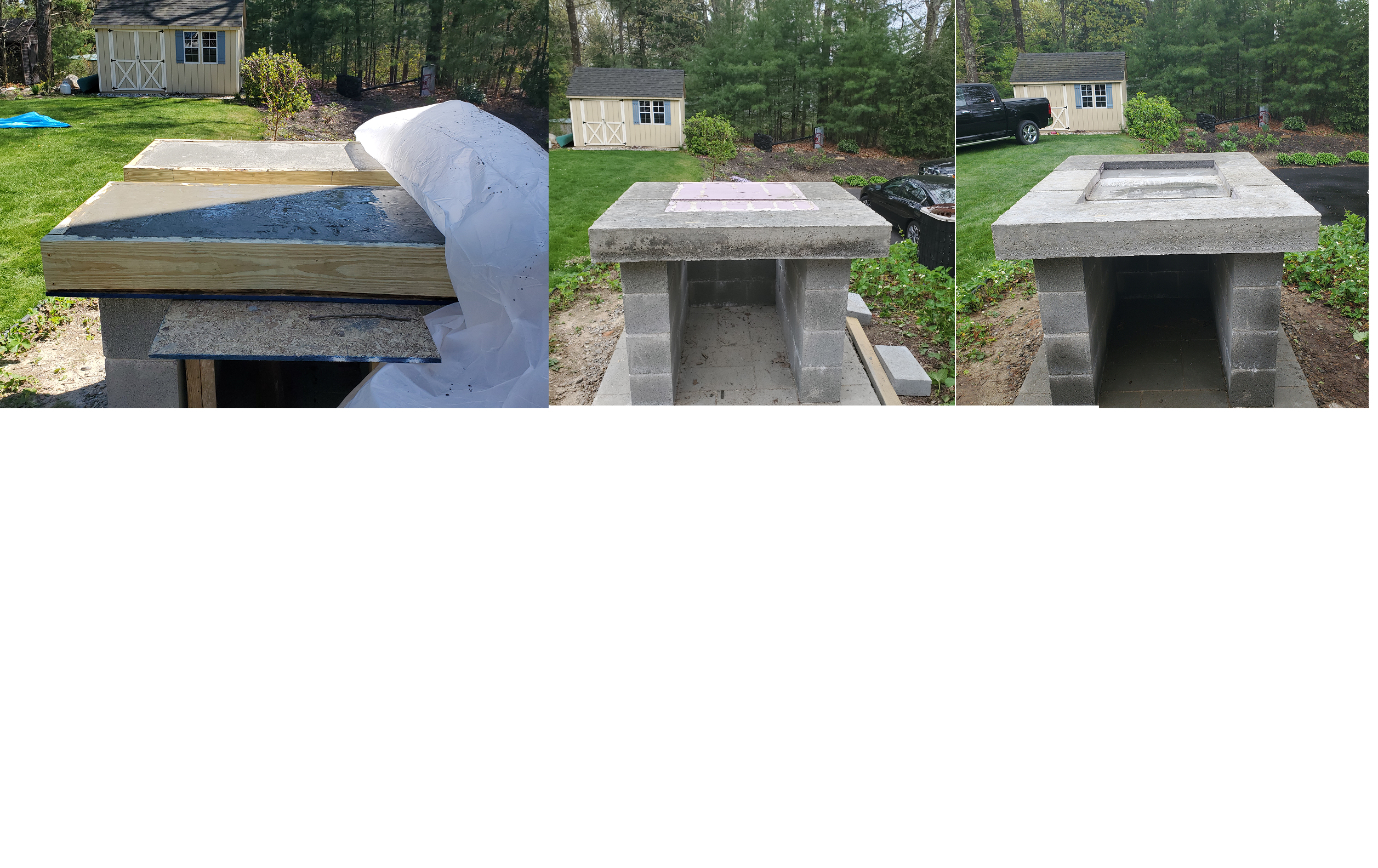

Hi JMT,
Very nice work. Good thinking. Your half way there.
Happy building.
I know it sounds weird, but that’s one good-looking slab! Thanks for posting the photos. You’re definitely on your way.
I addressed this problem of having the slabs resting on garage floor without gaps by placing 3 inch screws into the wood frame then creating a rope handle bridging between the screws. This allowed me to lift one side of the slab (with some effort) and slide a cart under the elevated side of the slab. Locked the cart in place . Then Created another rope handle on opposite side to lift and rotate remainder of slab onto the cart. (Did not have help) once came up with this solution second and third slab moved easily.
