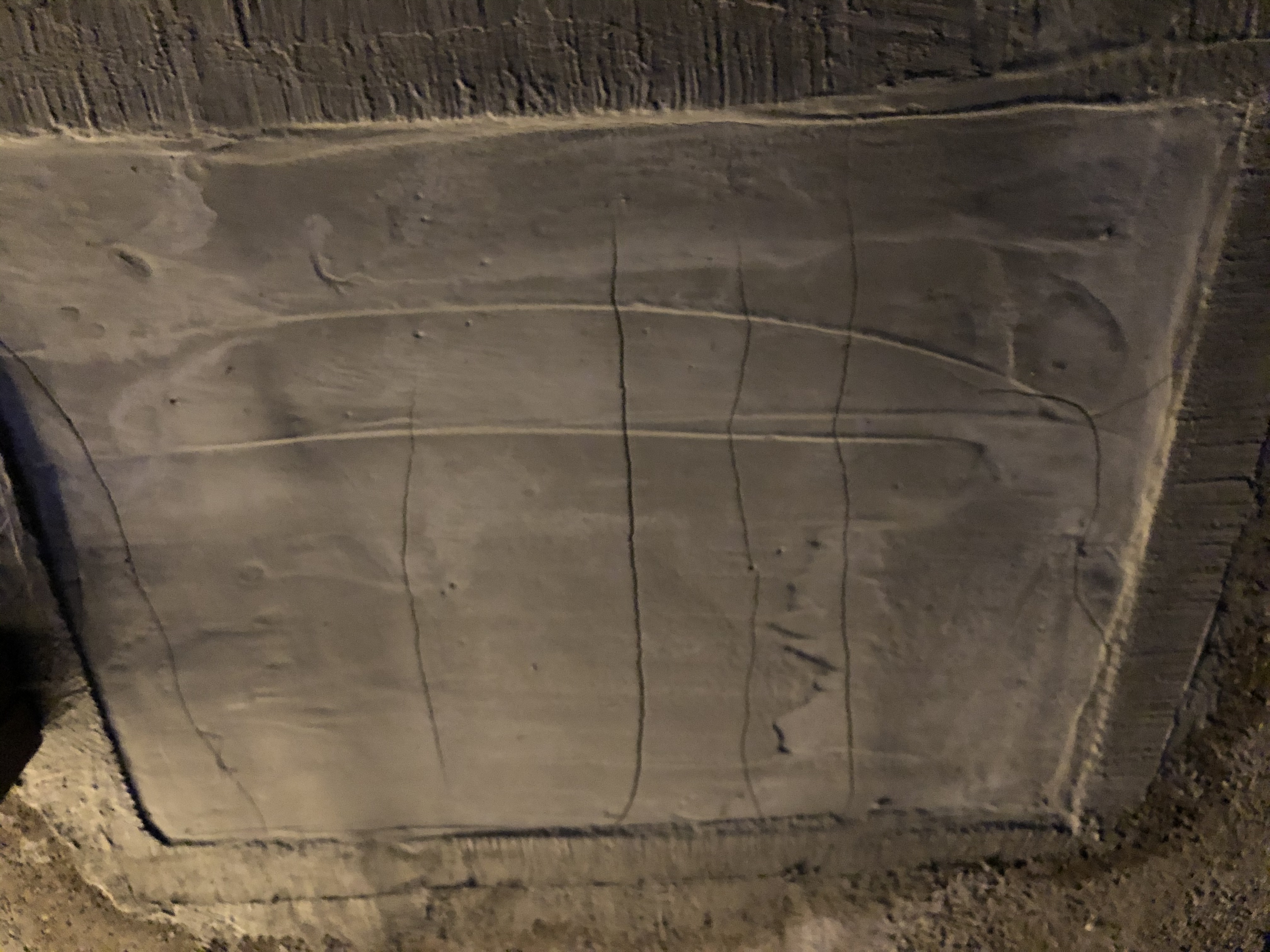

Not sure what to do at this point.

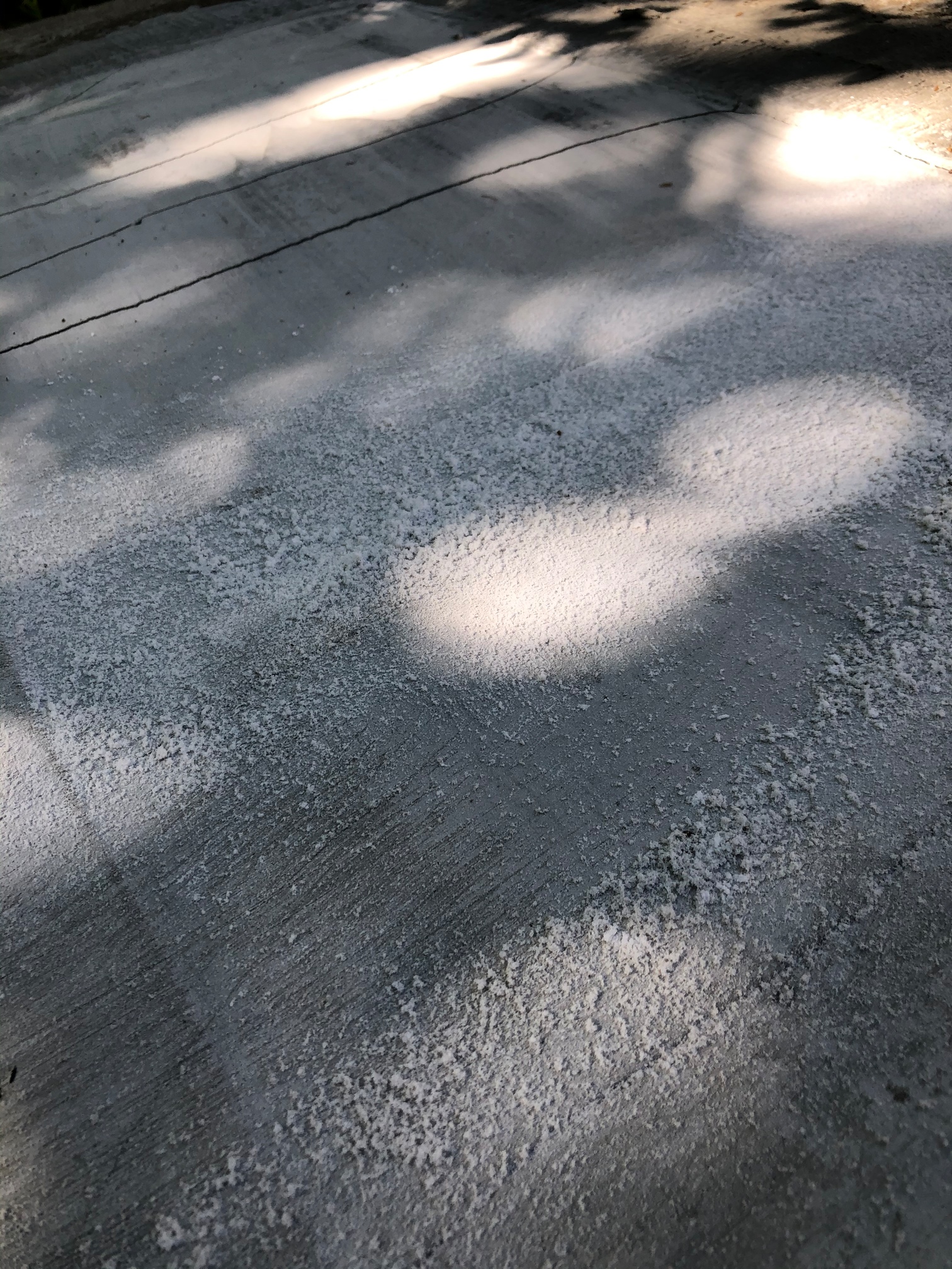

Ok so after sleeping on it. I thought I could fill in the cracks with the straight perlite powder as well as to mix some of it in with the sand under the firebrick. Hopefully that will provide enough insulation.
I give it about a 5. The problem is going to be with the powdered Perlite. It gets its insulative properties in pellet form from all the air spaces in each pellet. You’ve got powder form, which still has microscopic fissures in it that allow it to act as a filter medium. What is lost when it’s ground is all the spaces inside. That’s why your base shed water during curing—the Perlite powder didn’t hold onto it the way pellets would.
Spreading more Perlite powder to fill the cracks, or mixing it with the sand, won’t help with insulation. Ultimately it means your oven won’t perform as you hope, and your hard work is going to be a bit disappointing.
You can choose to go ahead, but since there are builders who report that their floors stay cold because they’re wet, I’d be doubtful about the outcome. The floor insulation is important for overall performance. It can get compromised by water, and if it’s not there in the first place, the slabs are going to act like a giant heat sink.
If it were me…I’d stew about it for a few days, then carefully break that hard mix out of the void and replace it with a mix using the specified materials. (Come to think about it, that would be dumb on my part to wait because the Portland cement is only setting up harder during those few days.)
This isn’t exactly why you put a rebar grid in your base slabs, but in this case it seems suitable.

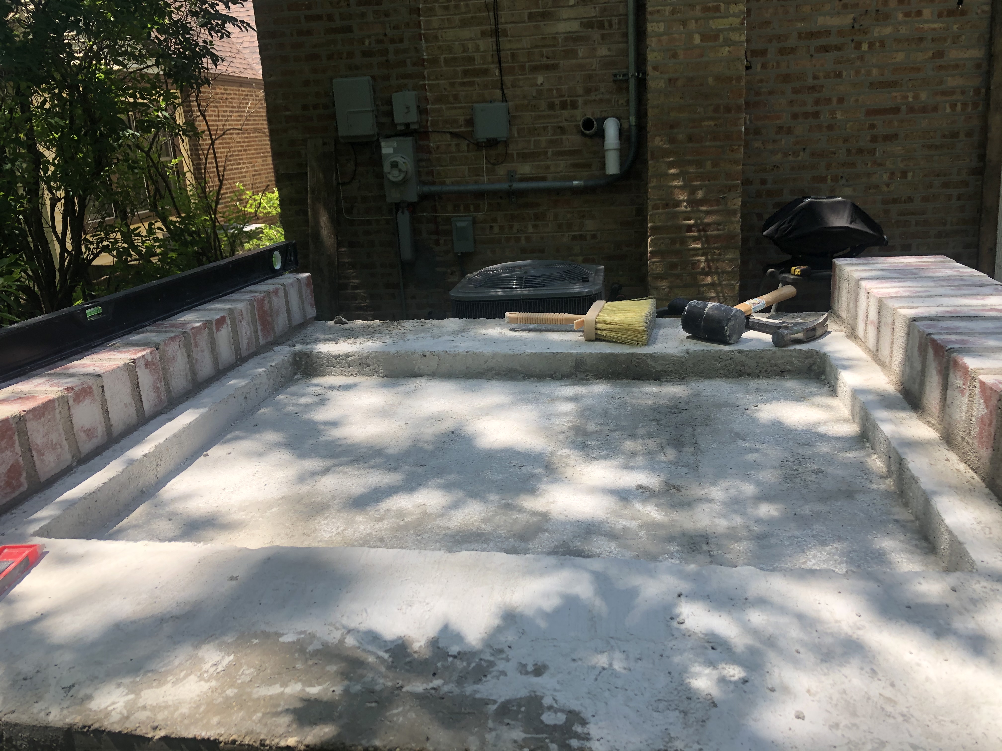

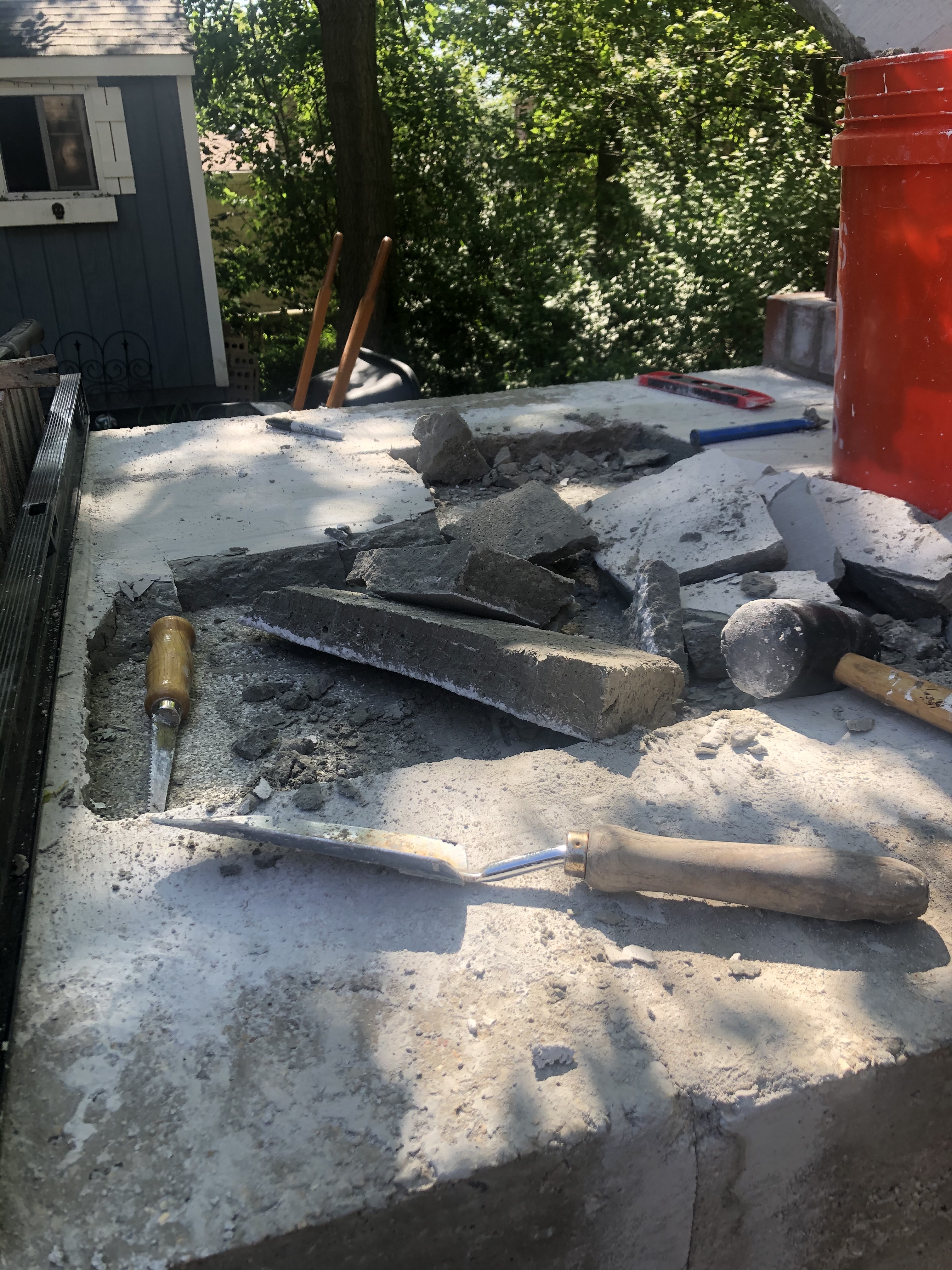

I’m trying to figure out the best way to remove that layer now…ugh
A 4" grinder with a masonry blade and a respirator (safety) will remove that layer. Heck a grinder with the appropriate blade will pretty much remove any layer on this earth!

Yes, indeed. Eye protection is also mandatory, leather gloves and long sleeves because fragments will be flying, and (because I’m a musician, but it’s also a good idea in general) ear protection. For that last it’s not “just” for your hearing, but also to keep the dust out of your ear canals.
Thanks all. It is coming up easier than I had thought. Thankfully!!!

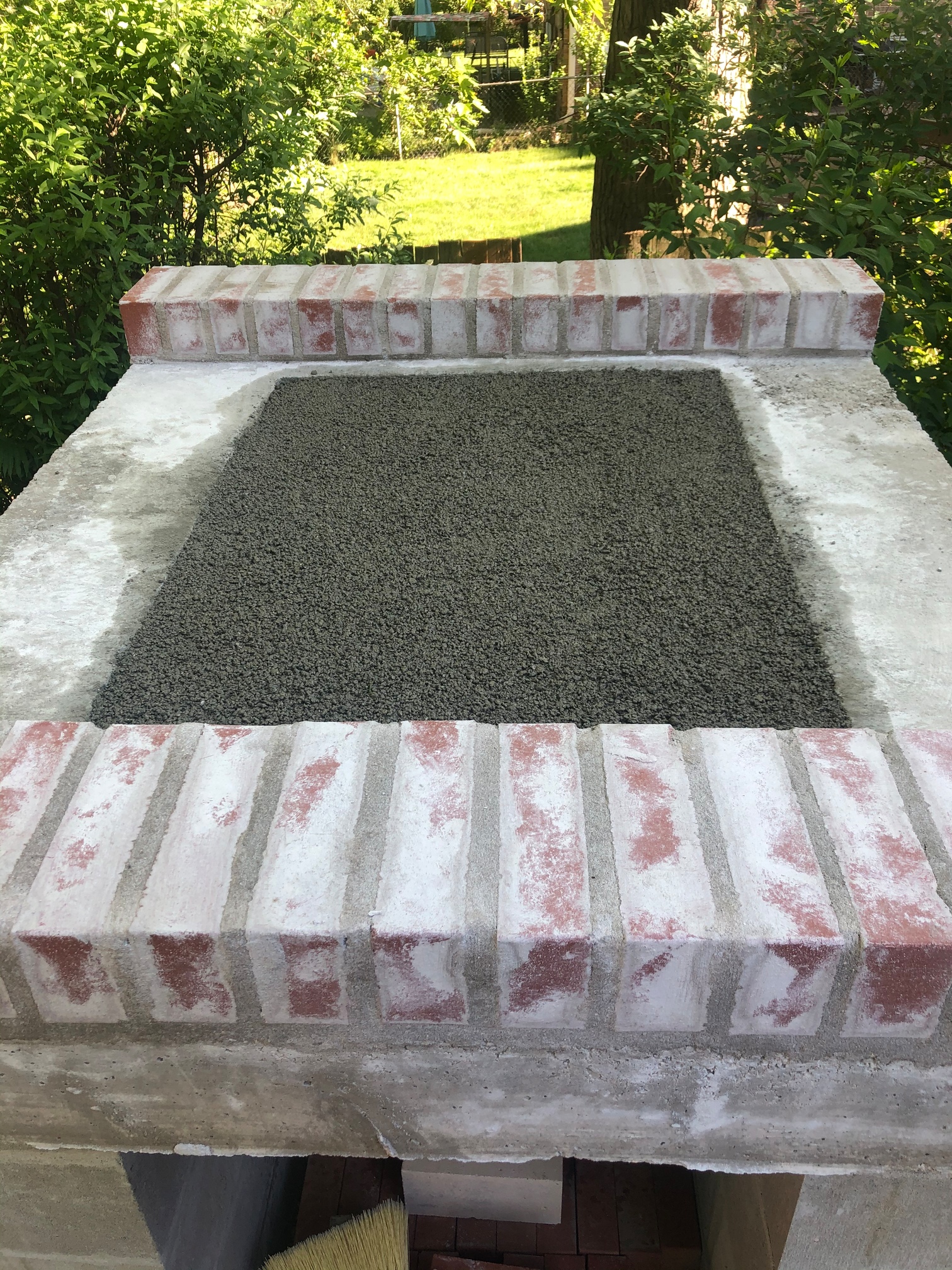

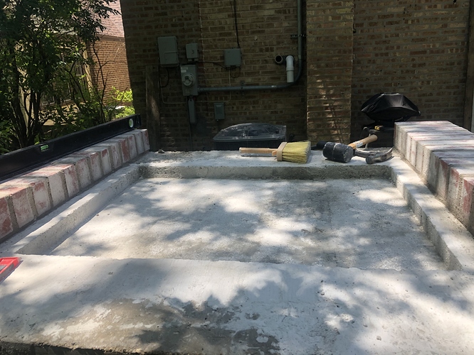

Thanks for all the input. I got it all cleaned out and I found a place locally that has perlite in a 4 cu ft bag. If anyone in the Chicagoland area is looking Brew and Grow has it.
Looking great, Jay! And thanks for sharing the Brew and Grow listing. That’s the stuff, and $25 is not out of the ballpark for it.
Referring back to your original post you should be able to screed the surface while it is still wet, and get a nice flat insulated surface ready for sand and dry-fit hearth firebrick in a couple of days. The cure time will also give you time to add your framing bricks at each end.
Thanks for keep us posted!
Oh, it really does! And it will look that way when cured, except it will dry to a whitish shade.
