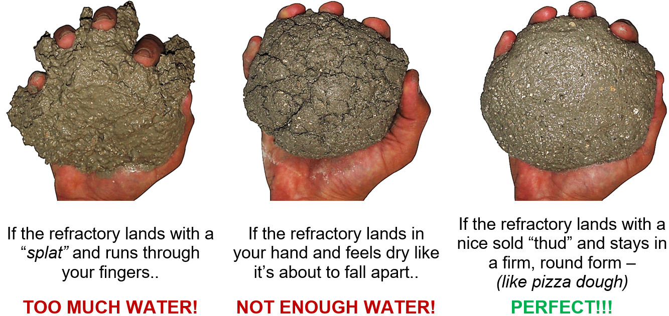

When water is added to standard Concrete Mix - it can be a little airy… and a little soupy. A concrete vibrator removes the air and thickens the soup.
When you make / mix Castable Refractory with water, you are using a VERY LITTLE bit of ICE COLD WATER (the colder the better - it slows the curing process). You’re going to add just enough water to get the Castable Refractory to the texture of cookie dough… or pizza dough… or Playdoh.
If mixed correctly, a concrete vibrator could, would and should NOT be needed.
Recently, we changed the 28" Mattone Cupola from 13 bags of refractory to 14 bags of refractory. For some customers, 13 bags was cutting it too close. So we recommend purchasing 14 bags of Castable Refractory.
