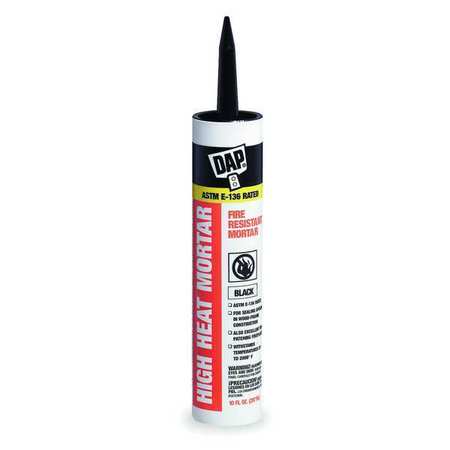

If if comes out, scrub or scrape that area clean and apply Rutland’s high-temp mortar for chipped mortar -
https://www.amazon.com/s/ref=nb_sb_noss?url=search-alias%3Dgarden&field-keywords=10.3+rutland+fireplace+mortar
https://www.rutland.com/p/44/fireplace-mortar
