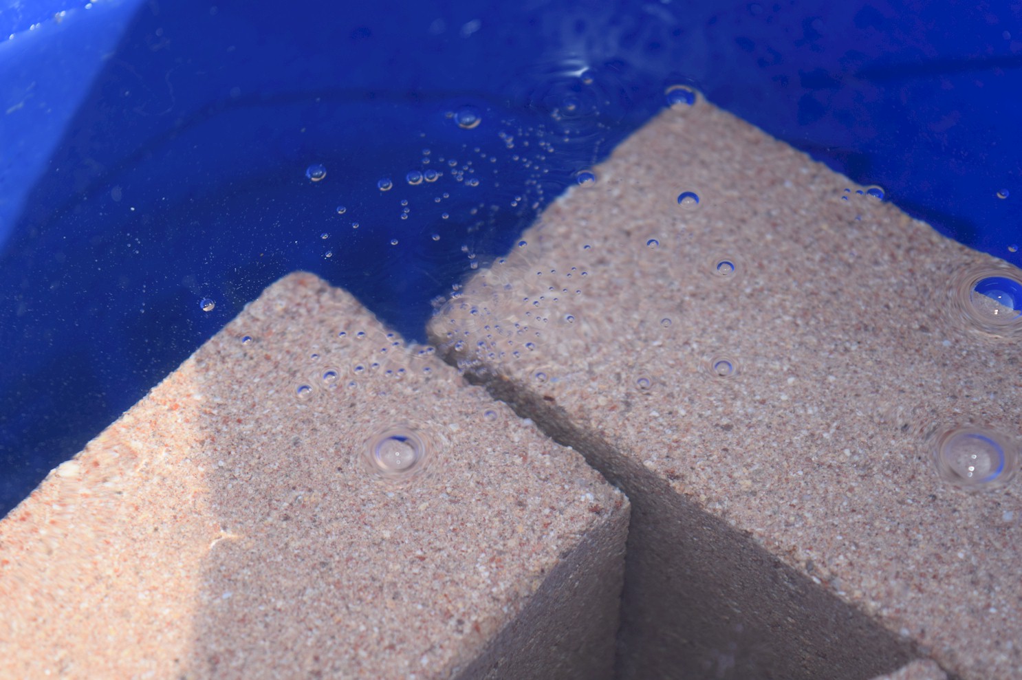

Simply place a good portion of firebrick in a wheelbarrow and fill it with water. Let the firebrick soak up the water for a good 10 - 15 minutes then place the brick under the base (shaded by the sun) for the remainder of your working time.
Here’s some pictures of firebrick soaking up water that we randomly have on our computer. In this stage, the brick are actually whistling! You can hear it!
