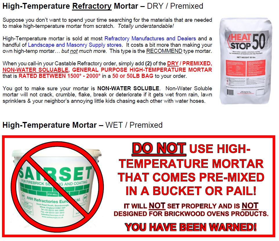

Hey Bill - I cover Sairset in our BrickWood Box instructions, but I still have to carry it over to the Mattone Barile Series Installation Instructions 2.0.
In a word… a large word… and that large word is also in Italic, Bold, Red and Underlined… NO!!!
Wet / Premixed Sairset DOES NOT work on our fire brick pizza oven models. You need to use a dry, factory made high temperature mortar… or homemade high temperature mortar… but it just needs to be a dry mortar.
Even if this was otherwise an approved material for the oven, I would suggest that using a premix material you know is out of date is a false economy. The packaging is going to look fine long after the material inside has started to break down.
For your structural work, I think it’s a losing wager to hope that outdated or sketchy materials are going to hold a brick arch together.
