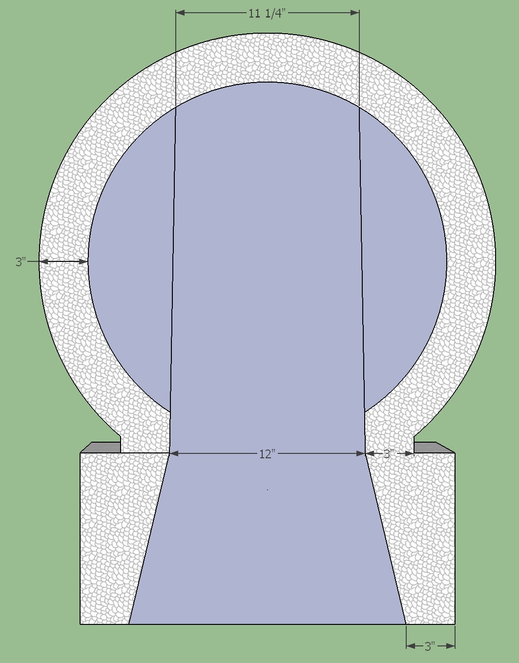

The foam is a bit of a booger to remove, but when you’re dealing with $1000+ in Castable Refractory… and an $800 form, we need to make sure that foam will NOT break. So we use super dense foam (3000PSI).
Once you remove the entire front end of the foam form, you will see the foam (dome) is actually made in 2 pieces. Remove the BOTTOM piece first as it is NOT glued in. It is actually loose - and is designed to pull out (with a little elbow grease and maybe a rubber mallet).
The foam is designed / cut so the bottom keyway will slide out of the front. These pictures will better explain the design.
BUT - I made this design change about a year ago, so hopefully you got your dome w/in the past year. Otherwise, the Sawzall (and a hired hand off Craigslist) will make short work of that foam.

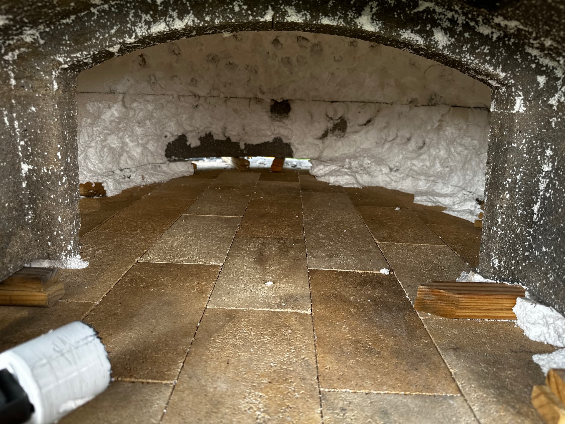

Still have 1/3 of the styrofoam out. Also, it seems pretty fused to the inside of the dome. My release agent seems to have completely failed.
I can’t seem the reach the back of the 36” oven and I don’t fit through the opening to clime in a bit to extend my access to the back of the oven.

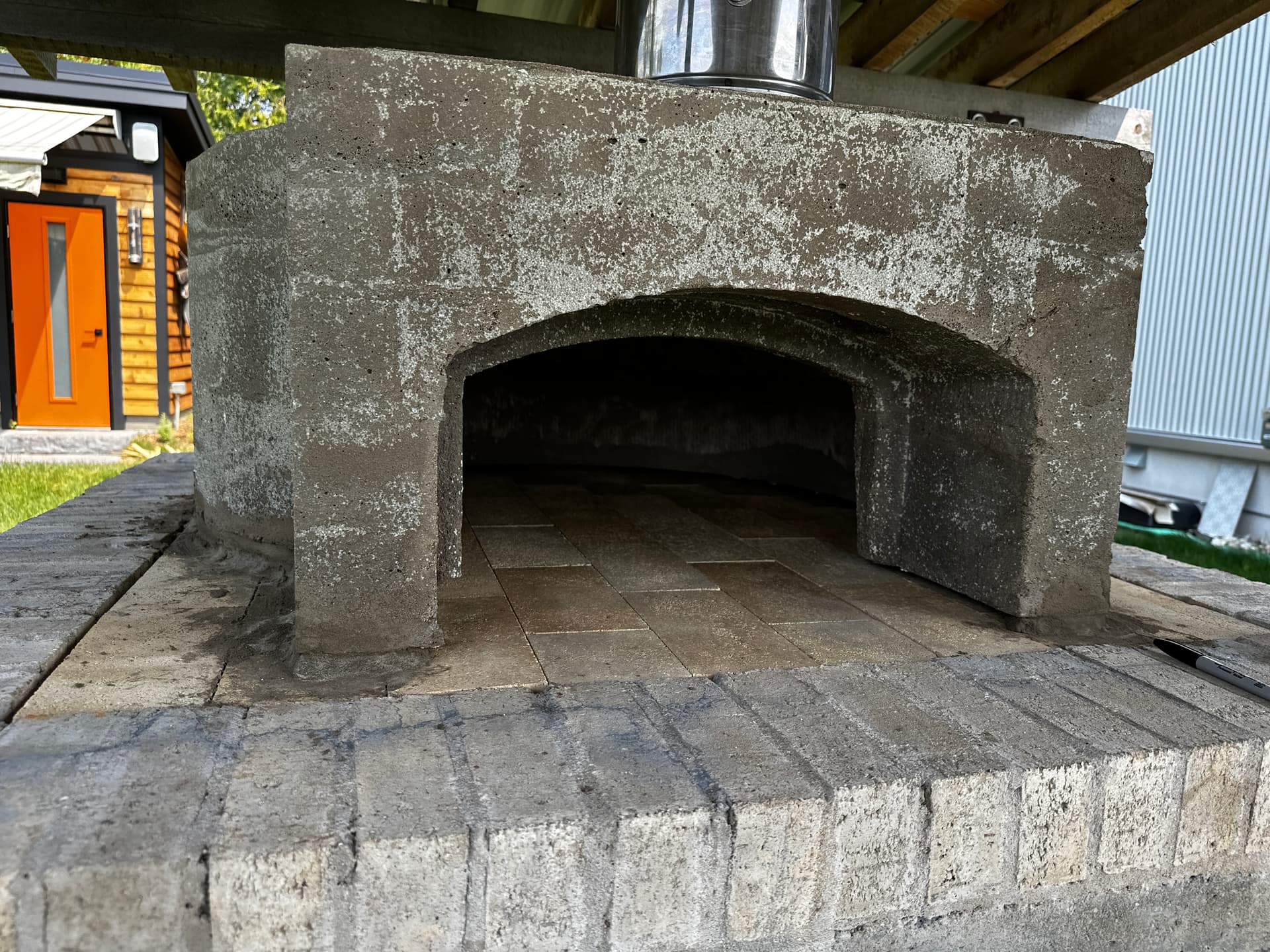

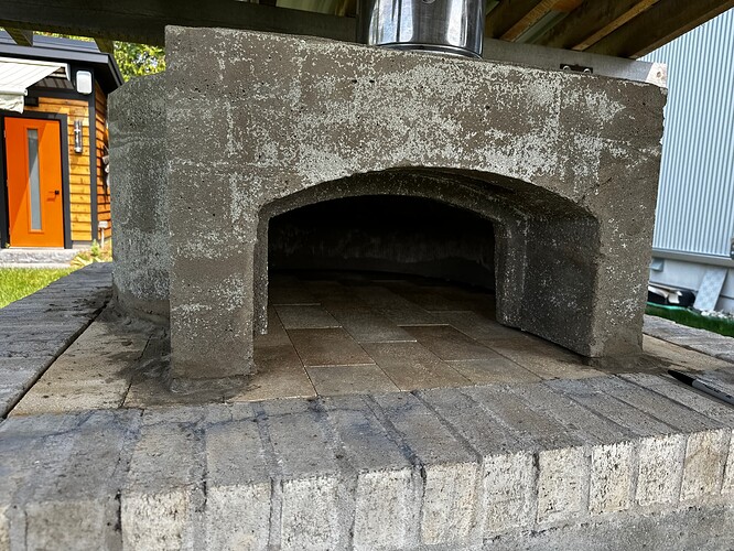

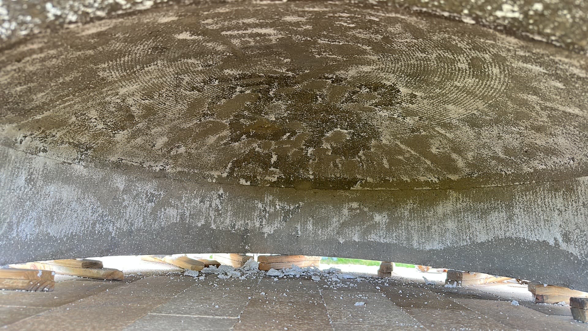

Hole saw with the center bit removed, drill with a wire wheel and the angle grinder with a wire wheel got it done! I spent way too much time past my shoulder into the oven in all sorts of contoured positions.
Ceramic blanket and wire mesh next.
I’m off to purchase the sand, mortar and cement to make plaster today…
You, sir, are a champion! I know from experience that some removals are just plain hard work and persistence, but now that oven will cook!
