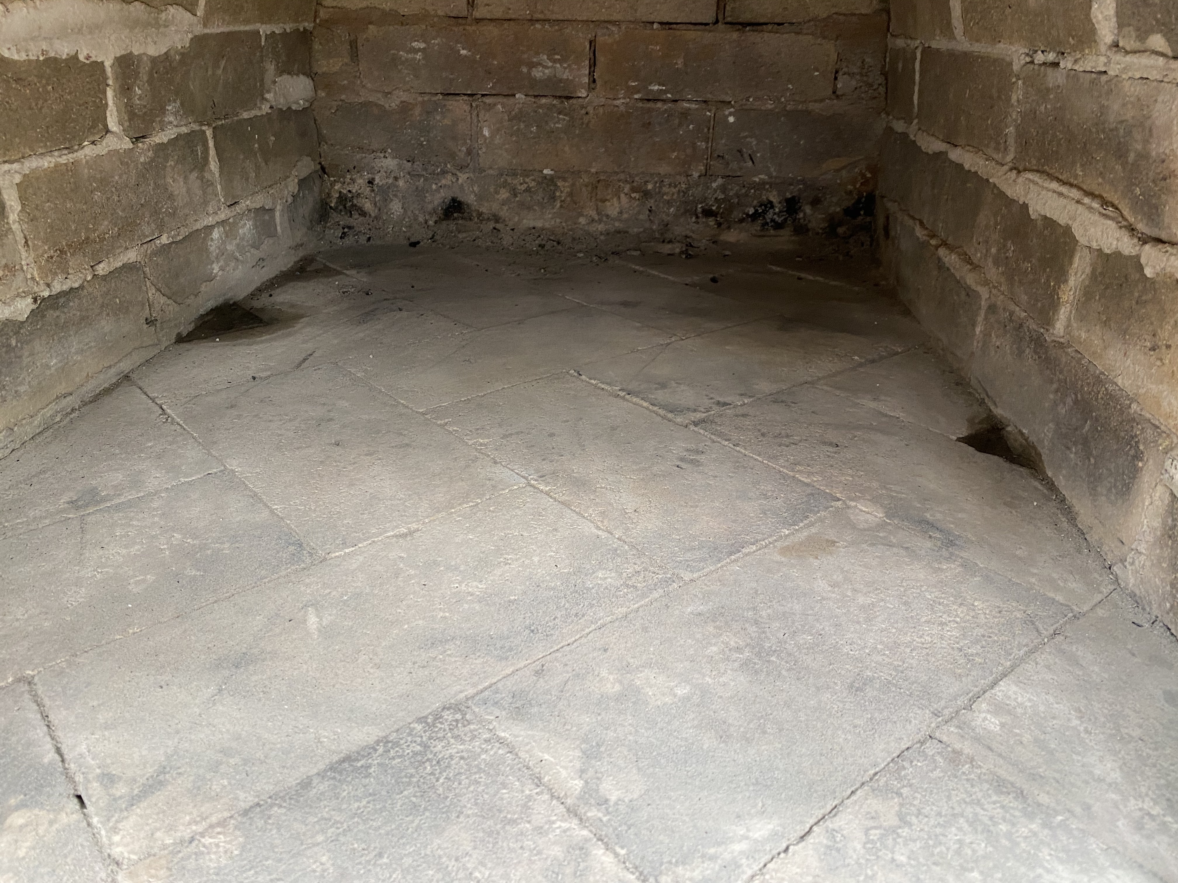

The painting helped but the floor was still very wet even with a tarp of the oven so I’ve been investigating to try and figure out where the water was coming from and I think I’m onto something. I completely cleaned out the oven, tarped it, and then checked on it in a week after some rain. The whole floor was wet but the sides and top were not, which makes sense given the tarp. Because the entire floor was wet It wasn’t clear how it was getting wet but that night after a pizza session I cleaned it again and only after a little rain the next morning I noticed this:
You can see the bricks on the sides are wet and along the back. So, the rain is soaking in through some cracks along the base of the oven. What’s still confusing though is the tarp covers this area, so it’s as if the rain is hitting the sides (of the slab with cracks), wicking in, and getting up on the floor. I got some high temp caulking I’m going to try and put a bead of that around the outside to see if that helps but I think I’m ultimately going to have to fill/cover the cracks on the slabs too to completely fix this problem.

Thanks for the update and the photo. Definitely following this. And it’s not just you…I had the same kind of damp creep in at that point at left near the rear last week. I didn’t have any trouble along the back or along the right side.

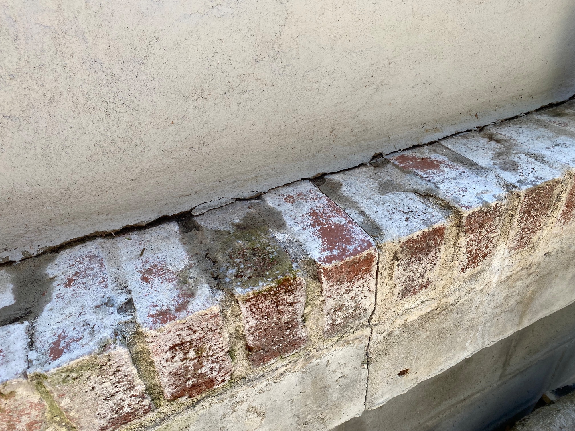

Applied this mortar repair today to fill some of the cracks. I’m not sure why I have so many but I think it’s clear this is how the water is getting in. Because I painted the shell the water just rolls down the sides and back and pools here and soaks in. Hope this helps.

That’s the sort of crack that will only get worse over time unless patched. Horizontally a lot of the stress is caught and dissipated by the rebar embedded in the hearth slab. But this kind of crack, through and through, needs exactly the treatment you applied to keep water from seeping in and then freezing in cold weather.
