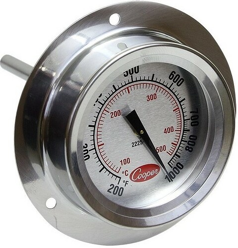

I will respectfully disagree with Kevin on one point. You can installl a door thermometer as some builders have done, and it might be helpful in limited circumstances such as bread baking. It’s not hard to do, though you do have the extra complication of a probe coming out the interior side of the door. You need to seal it with the same kind of red silicone that seals the chimney plate (if you have that kit).
Here’s a link to a discussion we had last summer about the in-door thermometer, including a recommendation for a suitable thermometer.
